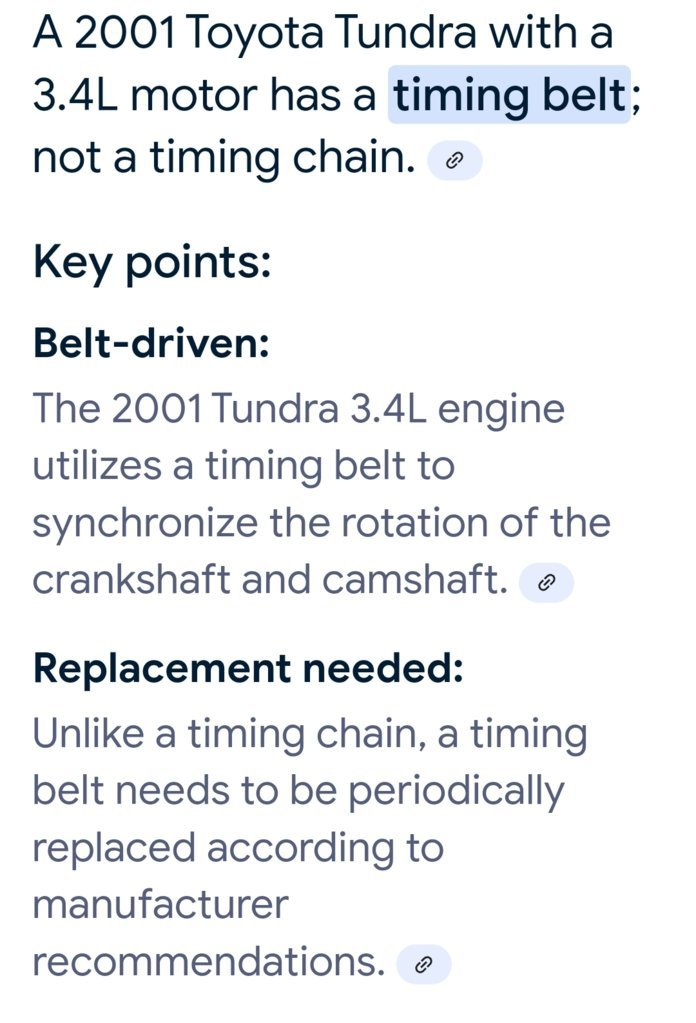

  5. Jan 22, 2025 at 3:27 PM
    29,766
    Welcome from NY.
    How many miles on it? Could be the timing belt.

  9. Jan 22, 2025 at 7:35 PM
    29,766

    Can confirm as I’ve replaced mine 3 times. Good thing is, the 5VZ is a non-interference motor. That’s why I asked initially if the starter sounds normal or like a cordless drill.

    Timing belts, pretty universally in Japanese cars I've owned, must be changed every 100k. They're rubber. Just like tires. They get old. And when they snap, they can destroy a lot of shit, just not internal to the engine like the V8 4.7L. When was yours last changed, @01 Tundra SR5 ?
