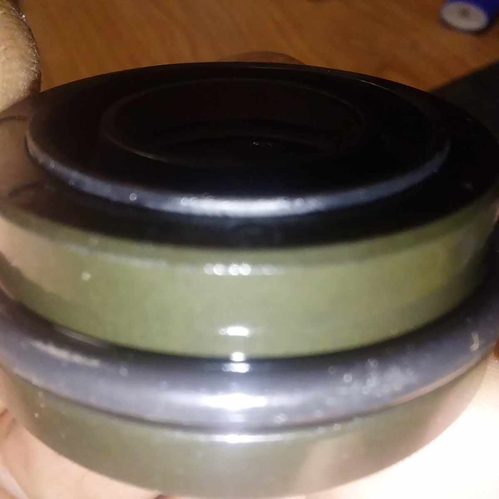

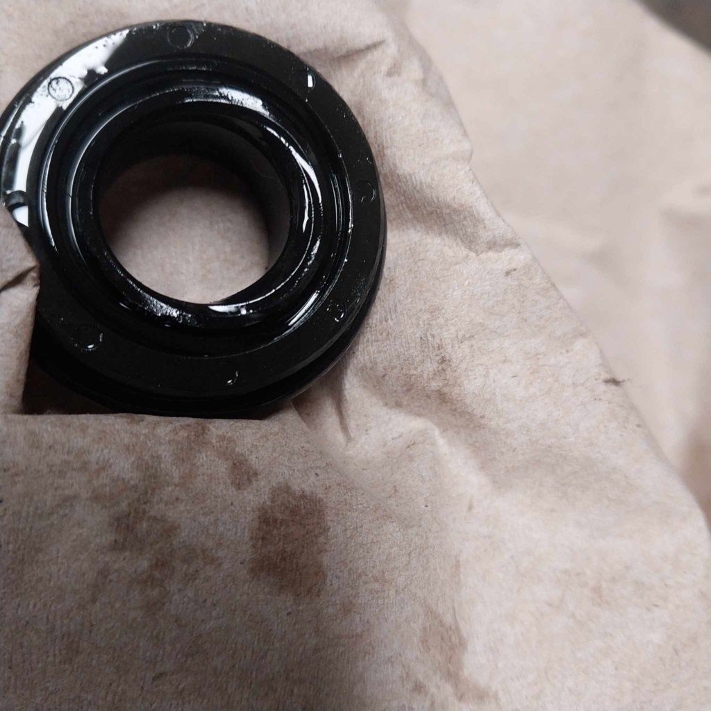

    FREE OEM Toyota unicorn master cylinder available for diagnostics / rebuilding - you pay the shipping charges. I missed my core return window.
    Former 2006 Tundra Double Cab 4x4 owner here. I struggled with ongoing brake issues similar to many of you and replaced most of my brake components over the course of a few years. I replaced the unicorn master cylinder with a rebuilt BrakeBest 11-3300 master cylinder from O'Reilly after finding my brake booster was doubling as a brake fluid reservoir / swimming pool earlier this year. I still had spongy brakes after several bouts of brake bleeding. I have my original master cylinder available to anyone interested in tearing into it do determine its failure point and potentially rebuild it - just message me and pay me shipping charges and it is yours!

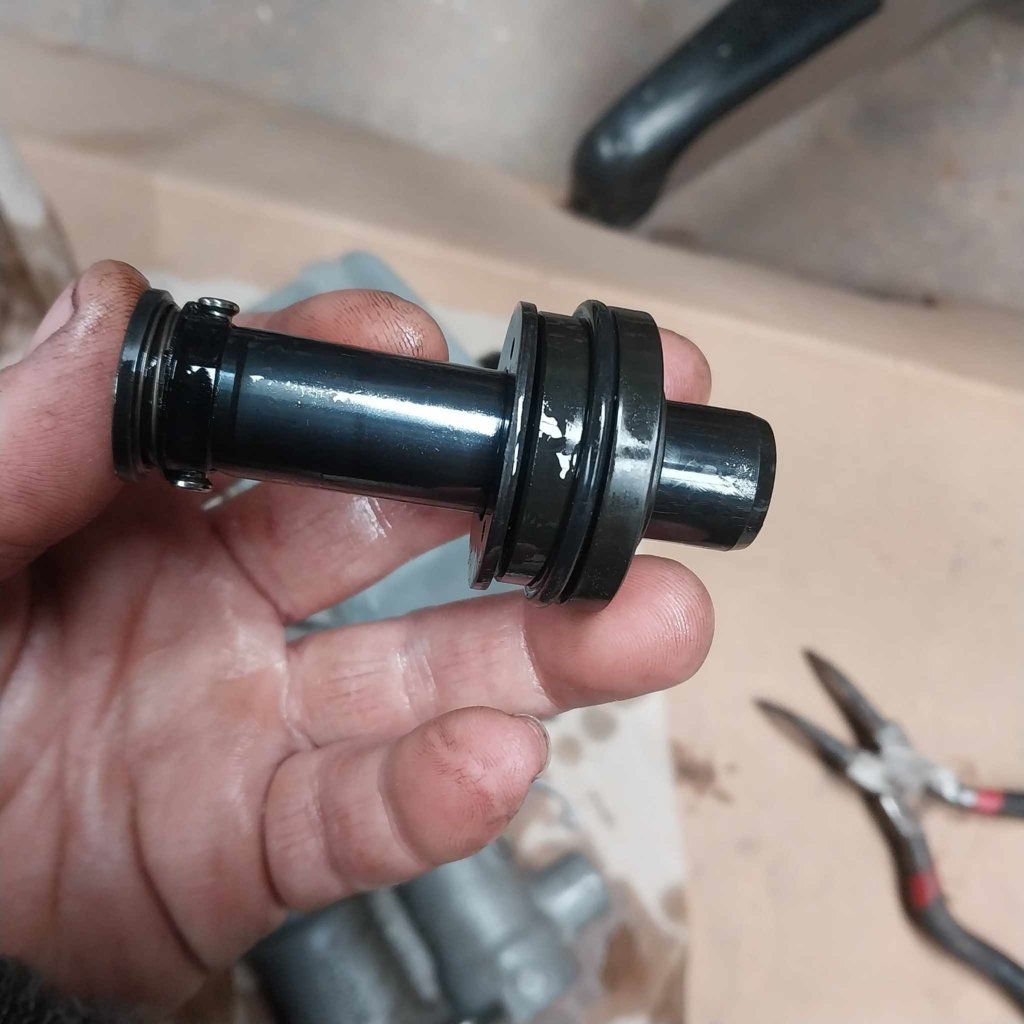

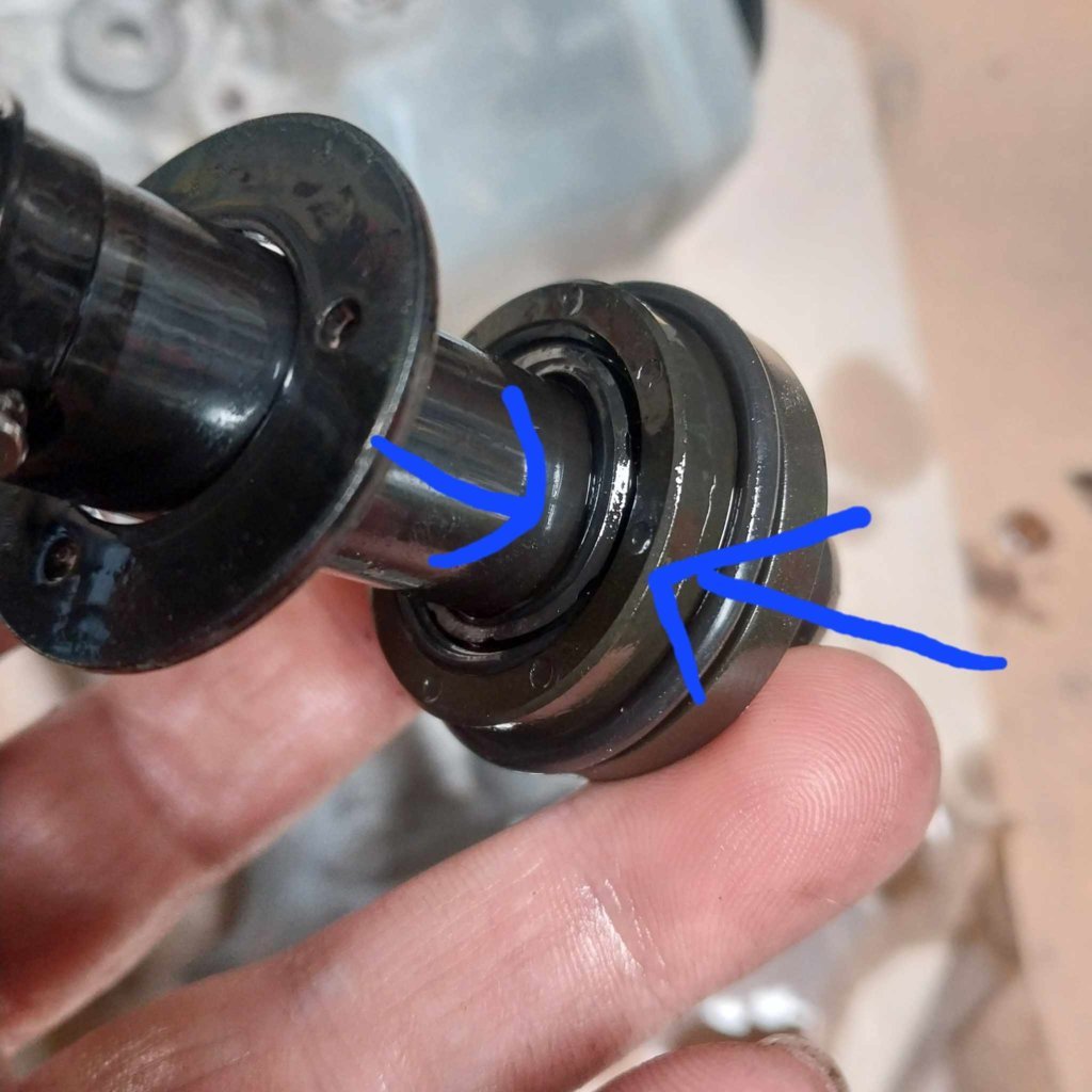

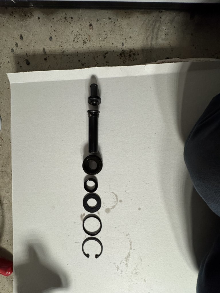

    I seem to have fixed my leaky unicorn piece with a $2.62 seal!
    Pulled master cylinder and saw leaking fluid. So I pulled the snap ring off the unicorn piece and removed the shaft (never uncoupled unicorn from master cylinder). service manual said if shaft is dropped it can't be reused, though they may have been referring to the inner shaft between the unicorn piece and master cylinder. I was careful regardless.
    Saw that the oring was good and leak was coming from around shaft. Pulled apart the spacers on shaft to see shaft seal and saw it was kinked sideways in its nest. It was obviously the source of leak and everything else looked fine so didn't disassemble further. But if you got fluid leaking into booster then its gotta be either the oring or shaft seal. Hopefully your leak hasnt been so bad for so long that the shaft has damage.
    I happen to live in the oil patch so there are gasket stores or hydraulic shops on every corner. I found the fastest caliper in the west at Gasket Services in Odessa, tx. He explained its a common U-cup seal but the material, EPDM, is less common.
    11/16" x 1" x 5/32" is the closest standard replacement size. But could only find that size in Nitrile or some other material you do not want to use with brake fluid.
    16mm x 25.5mm x 4mm seems to be the correct metric replacement size. Again couldn't find any in EPDM.
    Ended up using a 5/8" x 1" x 3/16" EPDM gasket at the O ring store online. Part no 6226-48
    https://www.theoringstore.com/store...FGMXzDJGy4ttUAE_1EECqv21LFJmPV1eLSHDp-A5bmT1C
    There was also a nearly microscopic part no on the original seal. it was of no help, so ill just add it so you dont waste your time trying to read it. A23 (A28?) 132291-19020 (the 2nd numbers 3 & 9 could maybe be 8 or 0)
    Sizes are ID x OD x Thickness
    The 5/8 ID is a smidge tighter than its original metric size, but its nicely snug and shaft slides freely. 1" OD is a smidge large but fits nice and snug. The 3/16" thickness is too thick by 1/32 or more, and sticks out past its surround by a hair. This extra thickness makes the shaft preload the master cylinder plunger by that much more. The extra preload might not affect anything but I was worried about interfering with whatever valves and passages are inside a master cylinder so I did my best to sand down the back and front faces of the seal. EPDM doesnt sand well. After an hours of grinding down the faces by hand with some find sand paper, I had reduced the protrusion by maybe half. But it also weakened what protrusion was left and made it more pliable and easier to squish flat. It still didnt sit flush but pretty dang close.
    I reinstalled shaft and master cylinder and everythings working like it should now. Though Im keeping the spare seals in the glove box in case. I also just completed repair today so I'll update if it fails.
    The part is only $2.26 but the site has a $5 minimum. Plus I paid $30 for 2 day shipping. So $35 and 36 hours later I had normal brakes again.

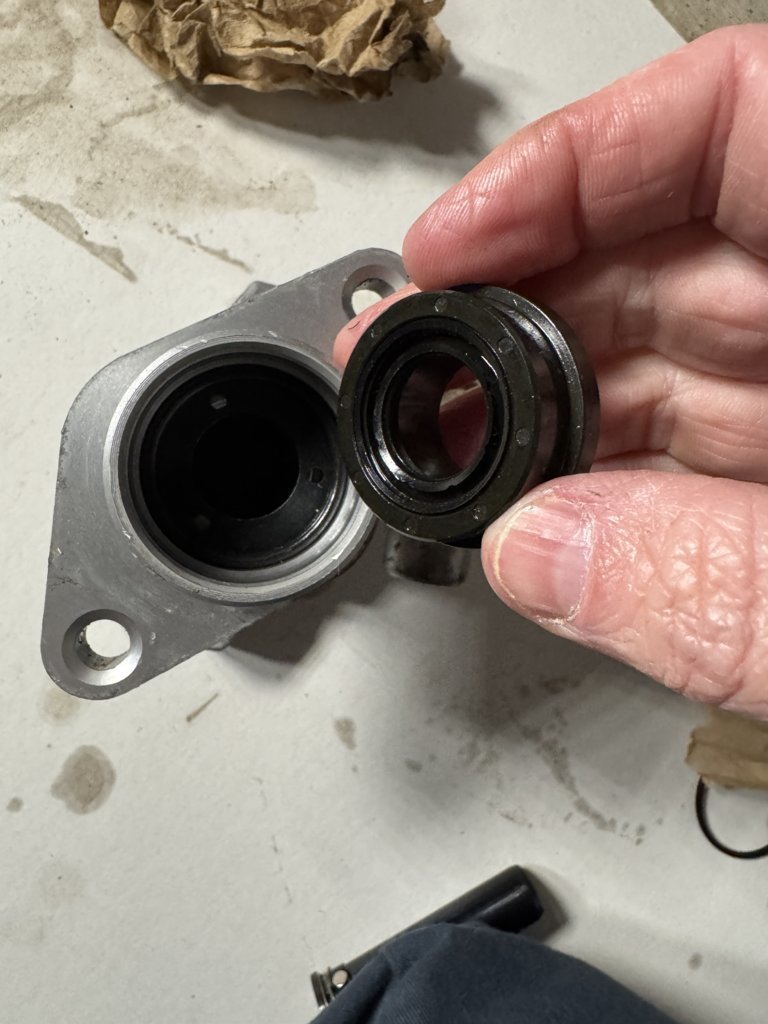

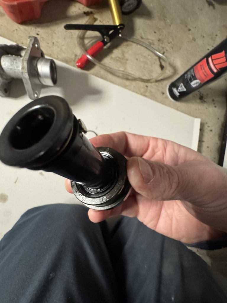

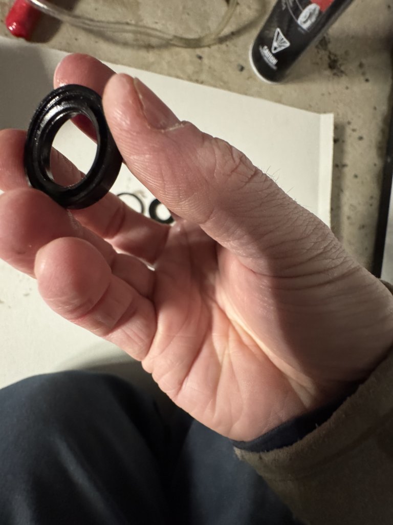

    Pictures of the offending unicorn seal.
    Mine rolled over inside the housing causing a leak into the booster.
    It was deformed from the pressure so I removed the seal and let it sit for an afternoon and it regained its shape to a point. These pictures are after sitting and starting the reassembly.
    I expected to find holes in the seal but all were in good shape.
    It seemed to have bled ok and will see how long it lasts.
    Disassembly is trivial with only 1 large c-clip.
    I’ll post again if this fails.

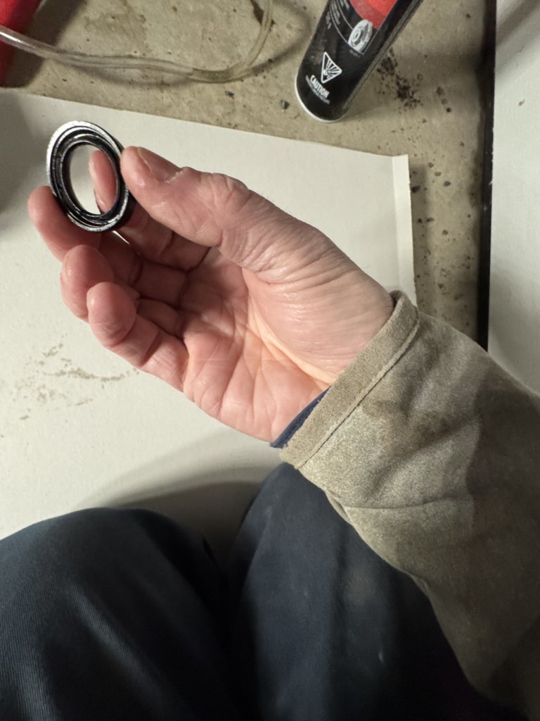

    There is a number that's extremely hard to read and couldn't find any parts that match the number. Closest that came up from a similar part number was an entirely different seal.

    Did that and like 50 other things to read the number. Also had another person double check my work.
    I took a micro camera and shined a micro light on the numbers which helped illuminated the edges of the imprinted numbers and i could read them that way. in my comment detailing my work, post #189, I list the part number that I found on the seal, though it was very hard to decipher if a number was a 3, 8 or 9.
    Was unable to find a part for sale that matched, but anyone is welcome to try using the numbers. In the end a simple 3 dollar non-Toyota replacement seal fixed it just fine.
