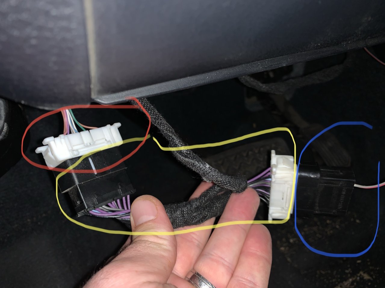

    I pulled mine down so you can see what it looks like with both the Fortin and Maestro plugged in. OEM OBD port in red, Fortin plug and OBD in Yellow, Maestro connection with grey/red wire in blue.

    Thank you az boathauler. That is the exact order i had mine setup and when the maestro obd gets plugged in it keeps the alpine unit powered on. I have taken the remote start out of the equation and it still stays on if the maestro obd is plugged in. Unplugged it shuts off with car. This is frustrating and i think i need to make a call to datalink to see what they suggest next.
