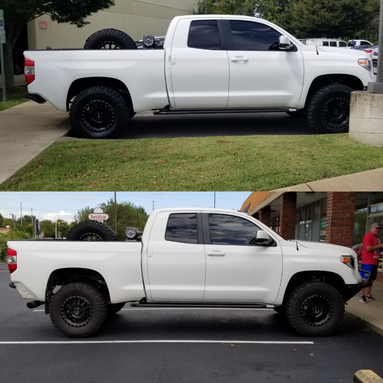

    Adjust the rear and adjust the front up some? You’d probably have to get another alignment though.

    That's probably going to be the route I take.. when I get my 2nd spare, I'm going to go back to option 2.. if it's too much rake I have some adjustment on the coilovers that I could play with.. surely with the billet ucas with the heims I've got plenty of adjustment..a little more lift in the front should shift some weigh back to the rear right?

    Adjusting the coils to compress the spring will lift the front to match the rear more. Compressing the spring does make the spring more stiff but I’m unsure if you will notice the ride being stiffer. I would test it before getting an alignment Incase you don’t like the ride. I think it all depends on what spring rate you picked for your coils. Like 600, 650, or 700 pound springs.

    Someone correct me if I'm wrong but I think the 2.5 coilovers come with 600lb springs from the factory. It's not so much the visual part of it as it is the performance part. Hoping an expert will weigh in on this at some point lol

    Option 2 mo better...a bit of rake is beneficial!...says the stock guy :rolleyes:
    Truck looks great all de badged! :thumbsup:
