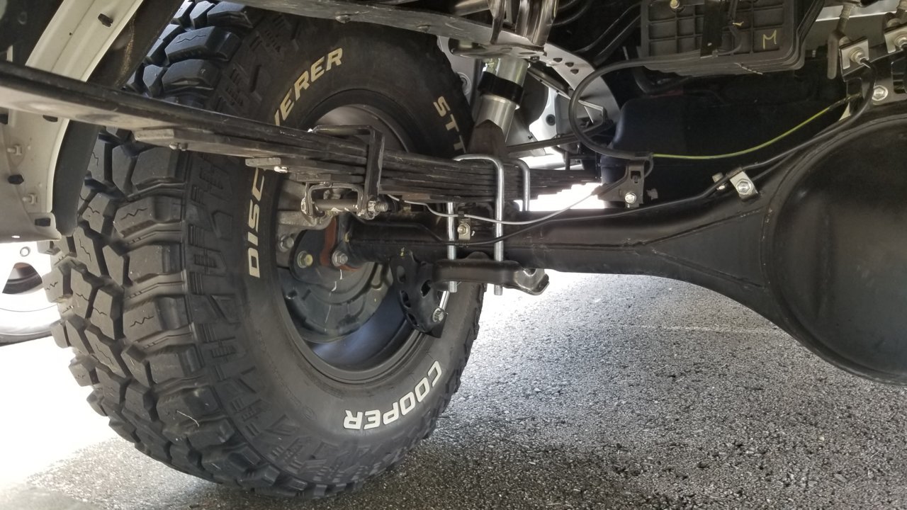

    Got the rxt leaf pack, currently on setting 1. I was on setting 2 but removed hitch and stock spare and added a high clearance bumper. I do have the sdhq chase with a spare and a pro eagle jack. Once I added the rear bumper it had the rear shock way out of the ride zone. 3+ inches over stock ride height. Once back to setting one. The truck sets level at best but with ANY weight added to the bed, it will start to sag. There seems to be no in between setting. Anyone have any advice on how to find that balance? I guess I could go back to setting 2 and add my 2nd spare.. but I didnt really want to drive around with it at all times.. all suggestions are welcome

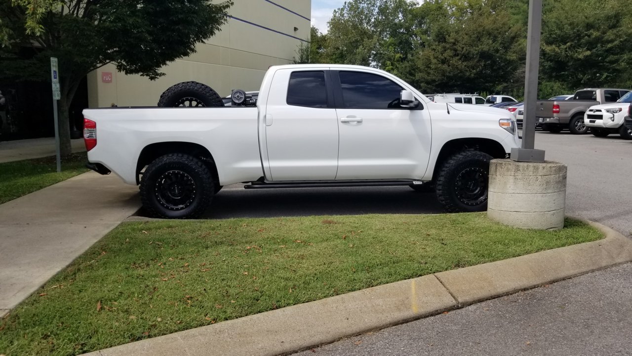

    I feel you. I was def ass up. It didnt look to bad in pics but when I stood behind the truck the rear bumper literally hit my belt line lol. Just super super stiff ride. Had plenty of travel lol just a terrible ride. I may just go back to option 2 and throw the extra spare in the bed and just roll with it. That should help at least settle it a little.. right now it sets 7 or 8 inches from the bumps.. and if I get down on it pretty good it squats, so I'm sure shes getting real close.

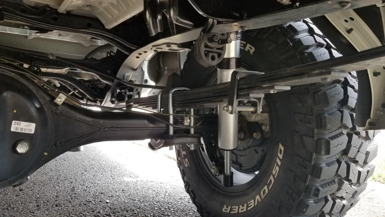

    Wow that's crazy man. I'm probably close to stock weight as far as overall load goes. I'm sure the chase and the spare are close to what the stock hitch was.. now that I'm thinking about it, I forget sometimes how damn heavy that pro eagle is.. I may just set it back to option 2.. at least it wont be flattening the overall pack. I'll post a pic shortly..
    dcsleeper408[QUOTED] likes this.
  22. Sep 8, 2018 at 9:19 AM
    Erichudgins
    Erichudgins [OP] New Member
    Apr 19, 2018
    #14593
    2,265
    Eric
    Murfreesboro, TN
    2017 Super white Limited DC
    https://www.tundras.com/threads/the-un-limited-build.25949/
    Driver20180908_111636.jpgpassanger20180908_111641.jpgride height with no extra weight in the bed20180908_111656.jpg

    Mine look like that too with my normal weight. Add another 50lbs and they are totally flat
