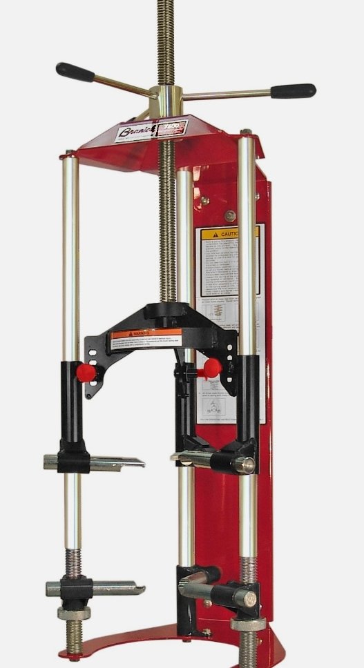

    When I went to adjust mine I used a pair of endless ratchet straps on each spring and tightened until snug with wheels on ground, each strap had a wll of 3300lbs. I then jacked the front of the truck and was able to easily adjust the preload with weight off thr front and springs still compressed. I tried.doing it normally but it was too tight.
    In regards to not being able to remove the 700lb springs... the shop wasn't able to compress the springs enough to remove that spring seat or whatever that parts called to twist and remove? itScreenshot_20230507_170453_Chrome.jpg. You must have that preload maxed out I guess. Did they have one of those Branick spring compressors? Where are you in NorCal?

    Yeah. My preload is almost or may be mixed out. I measured 3 inches of thread on one side. Before he even took it off, the guy looked and said it was maxed out.
    I think he had one. He hooked it up to something. And it started compressing the springs. He started to get worried about how much it he had to do it. LOL.
    I'm in the Sacramento area. I know there's a couple of shops in Auburn that could do it.
    I may try to use ratchet traps. Good idea. I've seen others do it on YouTube.

    I removed mine a few times with one of these easy. Hope you find a shop that can get it done.

    So the shop removed the coilovers, put a spring compressor on the springs to relieve tension and still was not able to rotate the preload nut? Even with no spring tension?
    Just my .02 but if you are going to try with a punch/pipe/pb blaster while the shocks are on the truck I think you are going to make it worse. Did the recommended shop have any suggestions before he said he couldnt do it?
