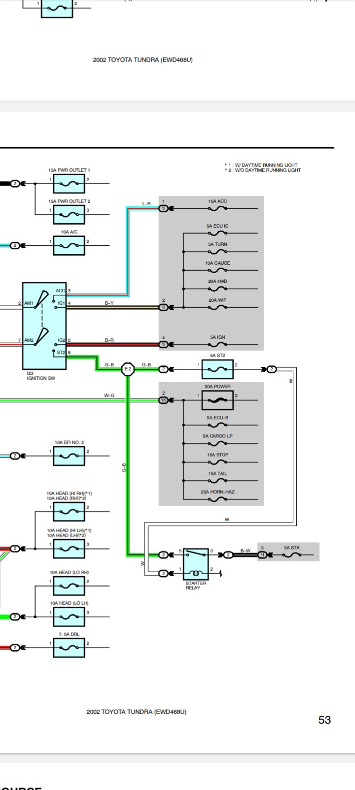

    I've been a mechanic for over 20 years and I am so confused where on this diagram is the starter and what is supposed to have power and when is it supposed to have power?

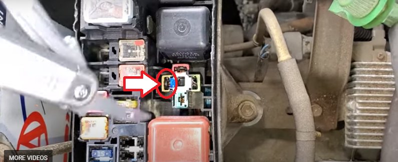

    This video should help for '00-'02, and possibly later years.
  21. May 24, 2024 at 7:12 AM
    VWmanwithTundra
    VWmanwithTundra [OP] New Member
    May 17, 2024
    #116995
    52
    Kevin
    2002 tundra access cab
    Work in progress lol

    i dont see it on the diagram sir

    the GD am1 fuse gets power but not the relay!!!!!!!!!!! wtf its not on the diagram wtf!!!

    ok so why isnt the am1 fuse in the diagram?
