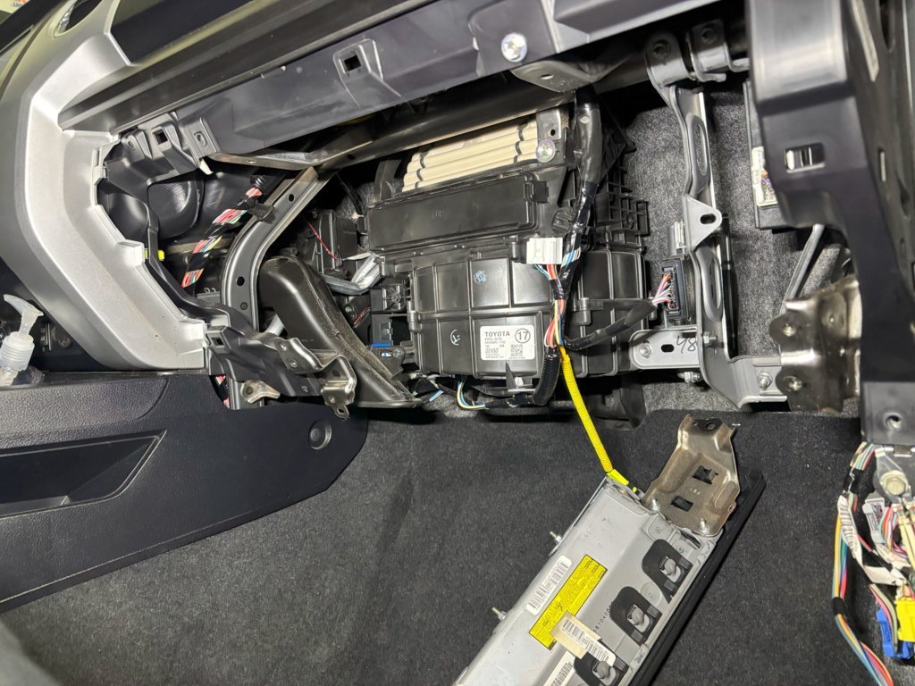

    I got the glove box half off, but I got nervous when it came to screwing around near the airbag and I didn't want to mess with it too much. That's all I need is to create some fault in the SRS system and have to take it to the dealer. So I put it back together, and somehow have a screw left over and can't figure out where the heck it goes. If my current solution doesn't work and the glove box must come off, I suppose I can figure it out then. I really, really hope my zip ties worked....

    Got it fixed!!! I went ahead and wrapped each tube with radiator hose cut to fit. I zip tied the hose on and zip tied the two tubes together. This eliminated the rattle/buzzing sound. Word of caution; these pipes get HOT!!

    Cool! Where are you taking this picture from? The piece removed above the glove box?

    The blower motor has the blue and white sticker on it that reads 44. In my first picture, the metal in the left foreground is the part that the glovebox attaches to. The two silver tubes are going through the firewall. Both pics are taken looking straight in. All the plastic to the left is behind the center console of the dash.

    Gotcha...thanks.

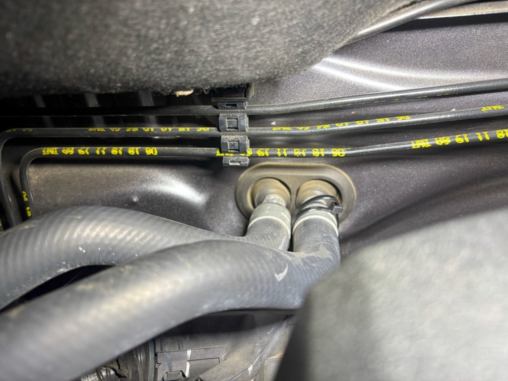

    Also grateful I found this thread, for three years I've been chasing a buzzing noise I couldn't pin point. Zip tied brake lines, bulk head connectors, put foam between the windshield and dash, pulled apart the air box assembly. I had intended to zip tie the heater pipe under the glove box like in this tread. I pulled it all apart but couldn't see how that would help (also didn't have the heat resistant zip ties at the time), also checked for that loose bolt. So I looked at the firewall side and saw the two heater pipes touching so I put a heat resistant zip tie around one and touch wood, it's fixed. Zip tie may fail at some point from vibration but it's easy to replace.
    My fix;
