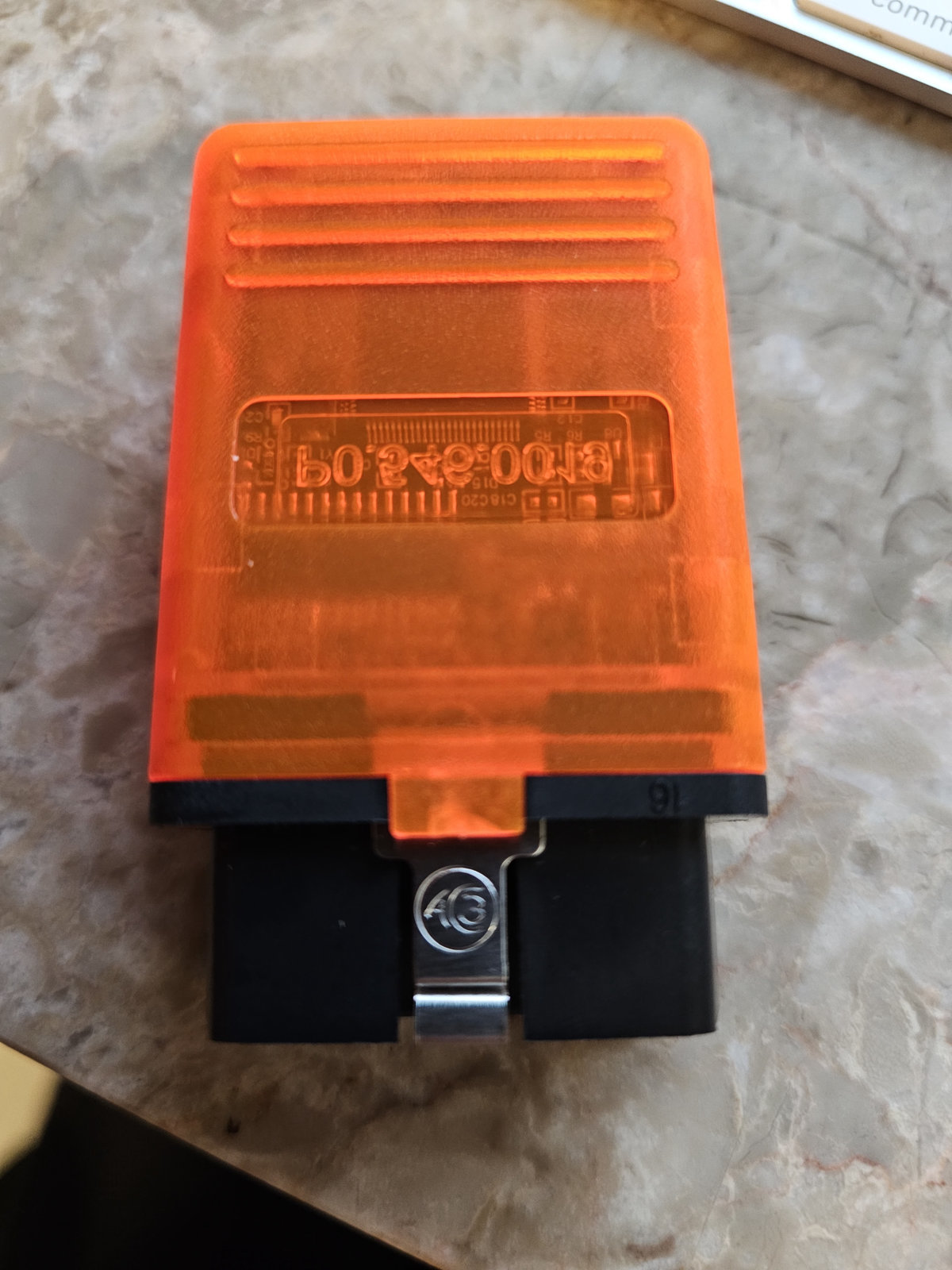

    @Ponderosa_Pine so I have the orange dongle that came with my SC 1900. I guess that one will work with techstream, assuming I have the 2.0 one. It has been unlocked by Magnuson also. I did find a TS software 17.30.011 and uploaded it to my PC. Now the only issue I have is it asks for a new key. The only thing I have found as far as getting a key is from a website called mhh auto. You apparently "donate" a 1 time fee of $30 and you give them your TS software ID and they send you a key. For how long this key will work isn't said on the site. The request for the 17.xx key is currently at 126 pages. The one for 18.xx is at 765 pages. Everyone that puts in their software ID gets a key posted to the site.
    Anyone ever heard of this?

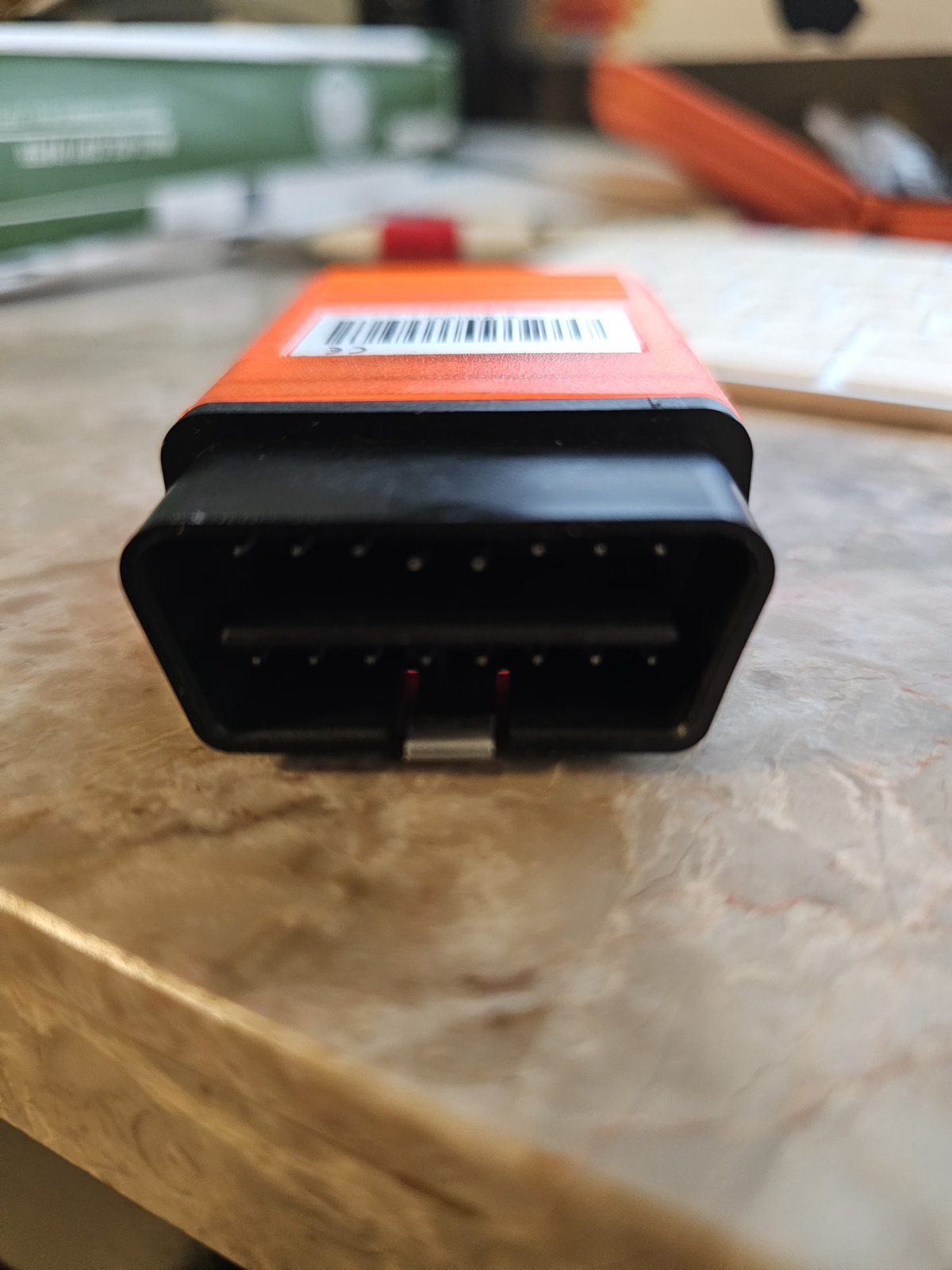

    Here the dongle that came with my SC. Hope it's the right one, so at least I can use it for something.20240509_210635.jpg 20240509_210621.jpg 20240509_210614.jpg

    Abell207
    Abell207 New Member
    Aug 24, 2020
    #51252
    250
    Anthony
    Maine
    2020 Army Green TRD PRO
    That’s what it seemed to me on the phone but I would think they’d need your stock calibration before hand

    Mine looks exactly like that from D3 but whitish/clear in color

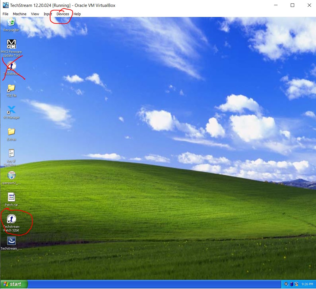

    This is what I used for techstream:
    Virtual machine image from here (Step 4, you only need step 1-3 if you need to install a virtual machine like Oracle VM VirtualBox)
    https://forum.ih8mud.com/threads/how-to-techstream-in-5-minutes.1034923/
    Then used techstream 17.3 found here:
    https://drive.google.com/drive/folders/1JEPEqc_3LKIGsbmzsOCXNJch2U4o5xQO
    And used the Tactrix drivers found here (only relevant if using the VF "legacy" dongle):
    https://www.tactrix.com/index.php?option=com_content&view=category&layout=blog&id=38&Itemid=61
    With the virtual XP machine running, I then dragged the 17.3 install file and Techstream Patch 32bit.lnk to the virtual machine. I then installed 17.3 over the existing 12.2. I also dragged over/installed the tactrix drivers. With the tactrix or other dongle plugged in, the virtual machine should see it, however you want to make sure under the "devices" drop down its selected. Then select the patch shortcut, which should open techstream after running some checks and ask you what vehicle you are using it on. If the Tactrix/dongle is plugged into the vehicle when this is done it should auto default some information like year/make/model and vin.
    Credit to this user for alot of this info (also this ih8mud thread had alot of good pointers):
    https://forum.ih8mud.com/threads/how-to-techstream-in-5-minutes.1034923/page-56

    @Ponderosa_Pine I did everything you posted. I had to figure some stuff out, but. I had to update to TS18.xx. Then when I open it though the patch, it try to communicate but gives me an Unable to connect to VIM. Any ideas?

    @Ponderosa_Pine got it figured out. I had to open TS and choose the Tactrix Openport dongle from the drop down menu. Thank you for putting all this info up. I now have access to TS!!!!
