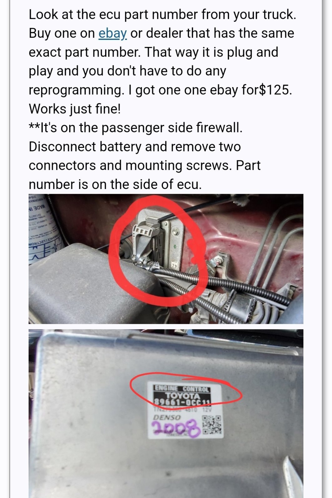

    To replace the ecu to be plug and play it needs to have exact part number. Same body type and accessories.
    Sometimes if its a different year you can handshake the new ecu with pins 4 and 13 from the attachment below. Sometimes it needs to be flashed at dealership.
    Not sure about bench flashing with resistor as I didn't do it.

    You will have to pull your ecu out to see the part number. I posted on the SC thread.

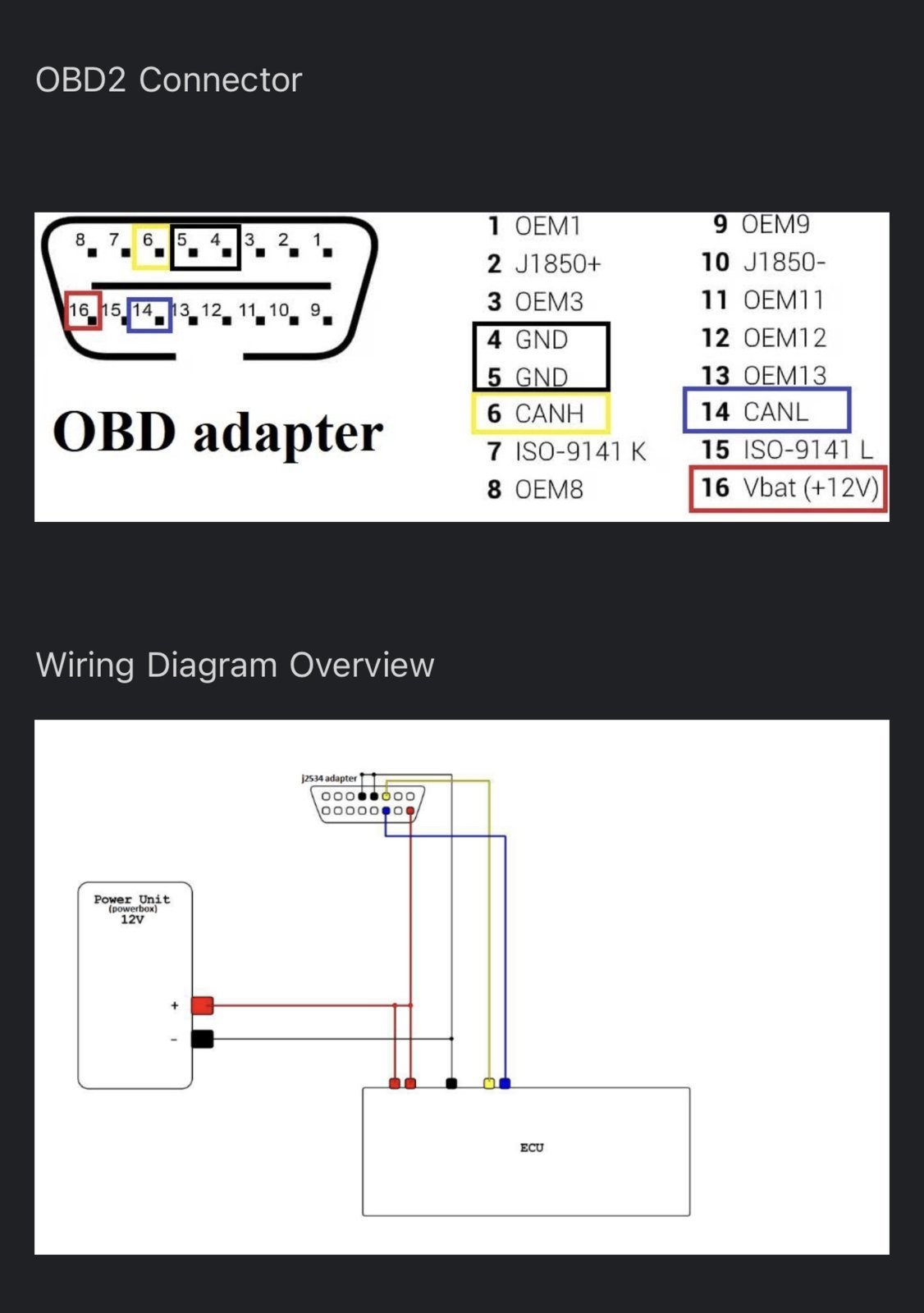

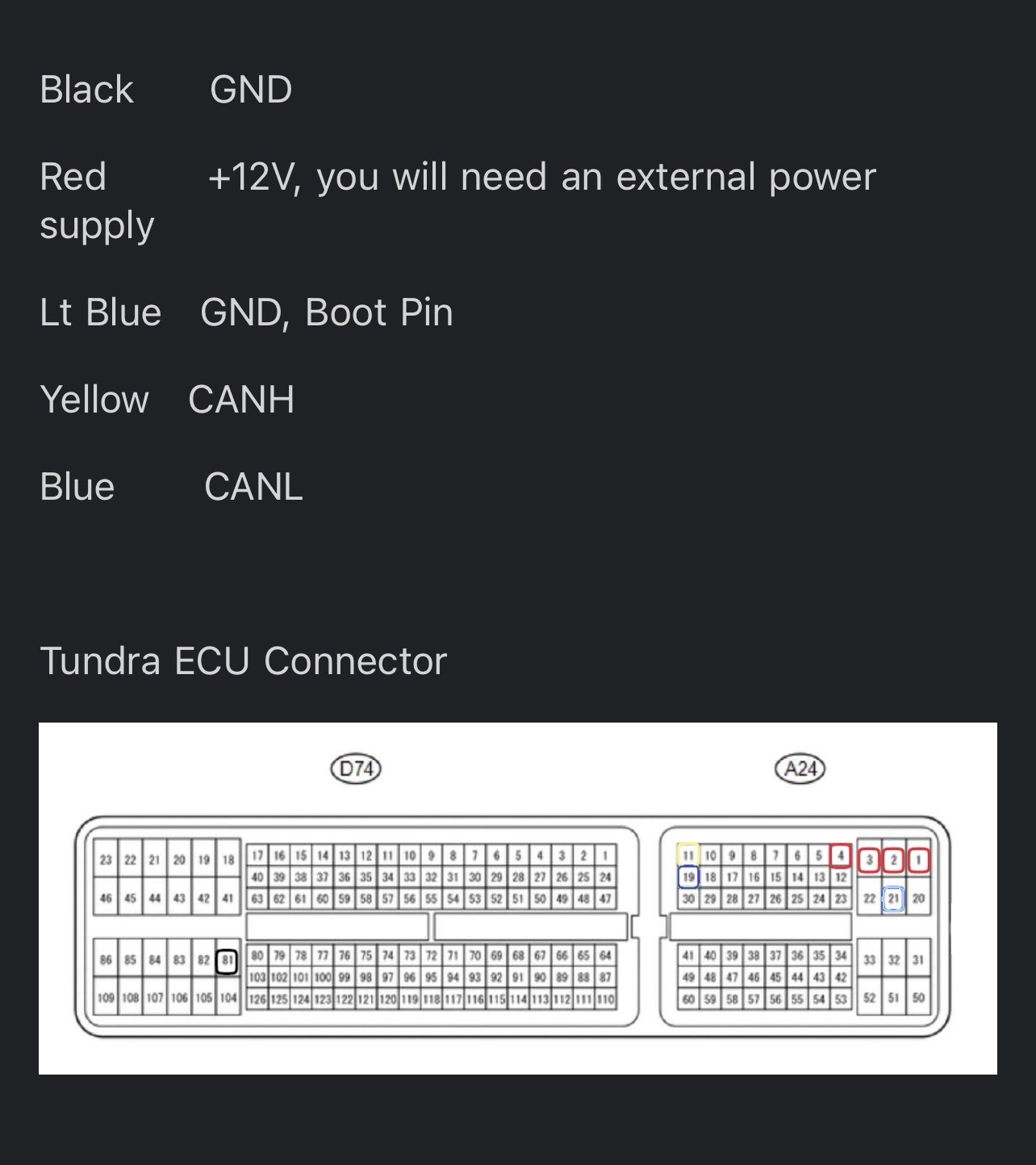

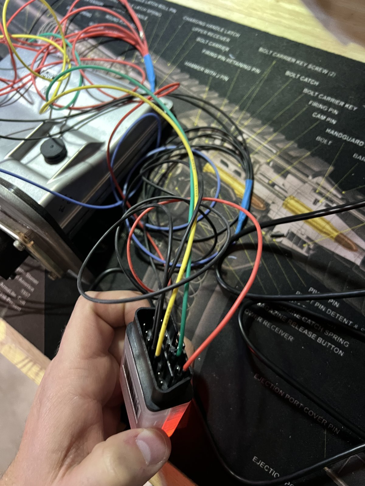

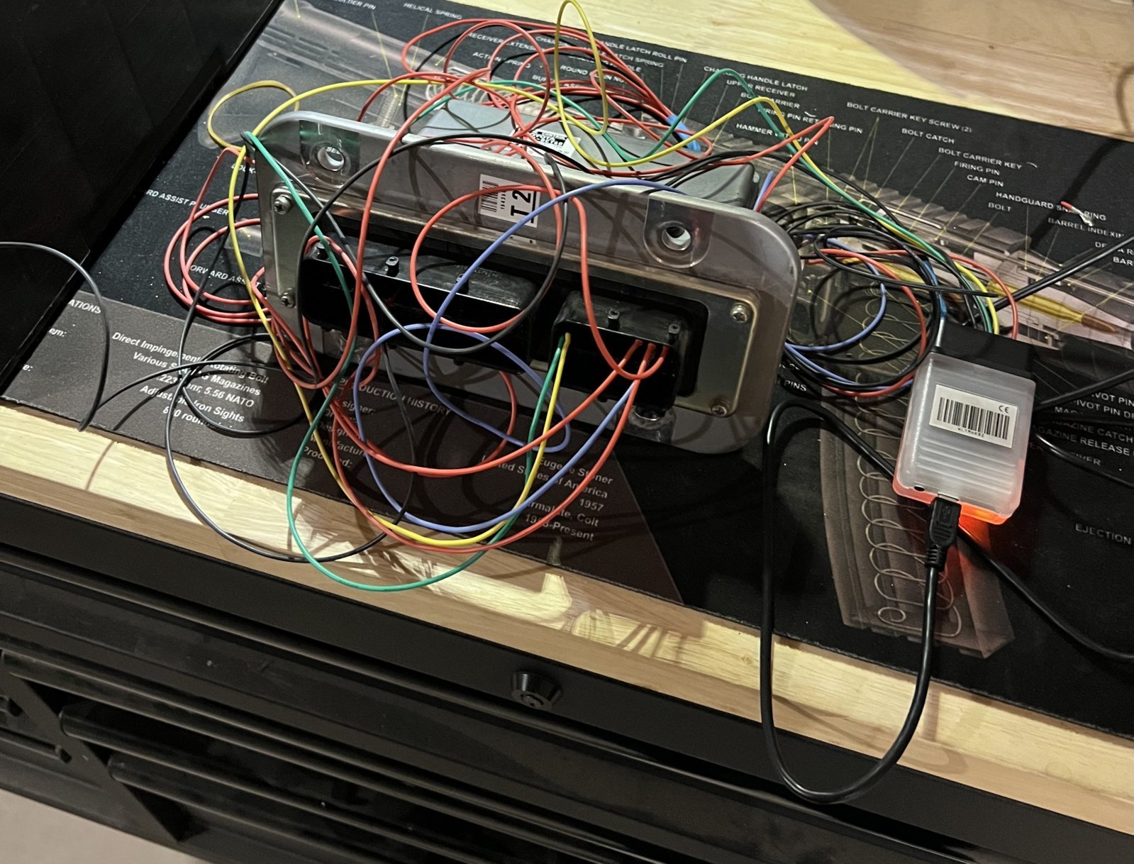

    I’m happy to report that I got my ecu unbricked using the method D3Performance sent to me. I had to remove the ecu from the truck, wire up the pins that needed wired and same for the dongle from D3 and then added a 12V power source to power the ecu. I then used their software to recover my stock file and reloaded their tune back on. I will wait to use HPtuners at a different time. I took a few pictures of the mess of wires I had but in the end it all worked. I used very small heat shrink tubing to go over the wires and pins to keep them in place and not short anything out.
    jhrrld, Fastlane47, nags and 8 others like this.
