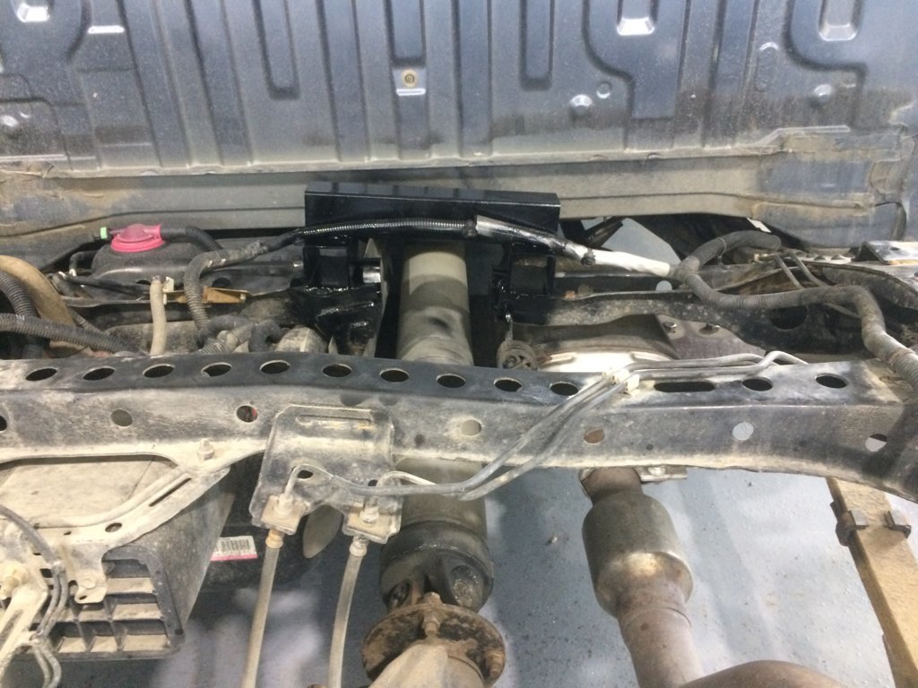

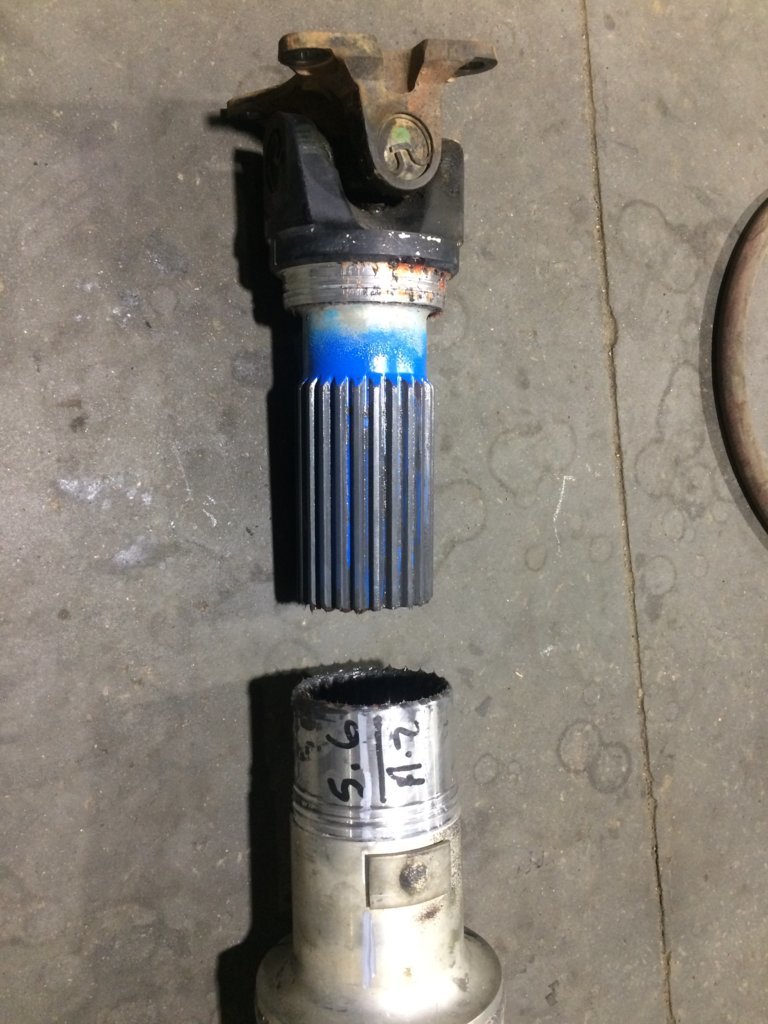

    My truck has a 4" rear drop and 2 leaves out of the leaf springs. I ran into an issue with the driveshaft bottoming out and had to take a little bit of the spline portion off to be safe. I also had the driveshaft hitting the crossmember, so cut it out and welded an ugly but functional square tube brace there. Also was hitting the bottom of the cab, so had to notch that a little bit as well. But my truck is very low, you most likely won't have those issues.
