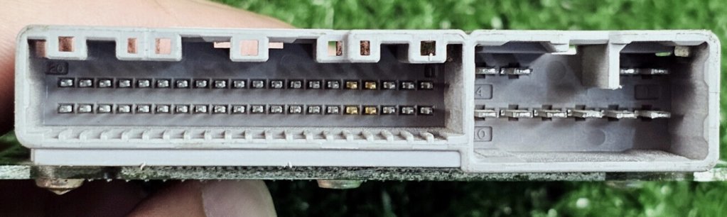

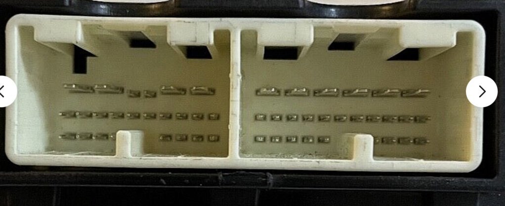

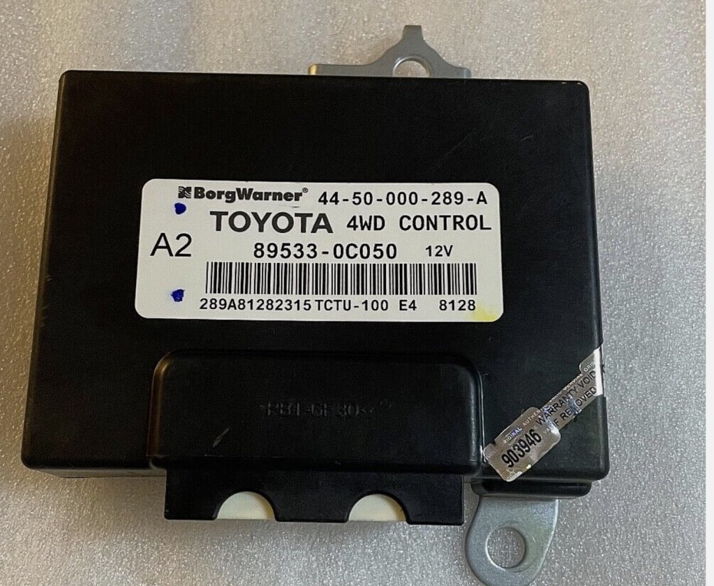

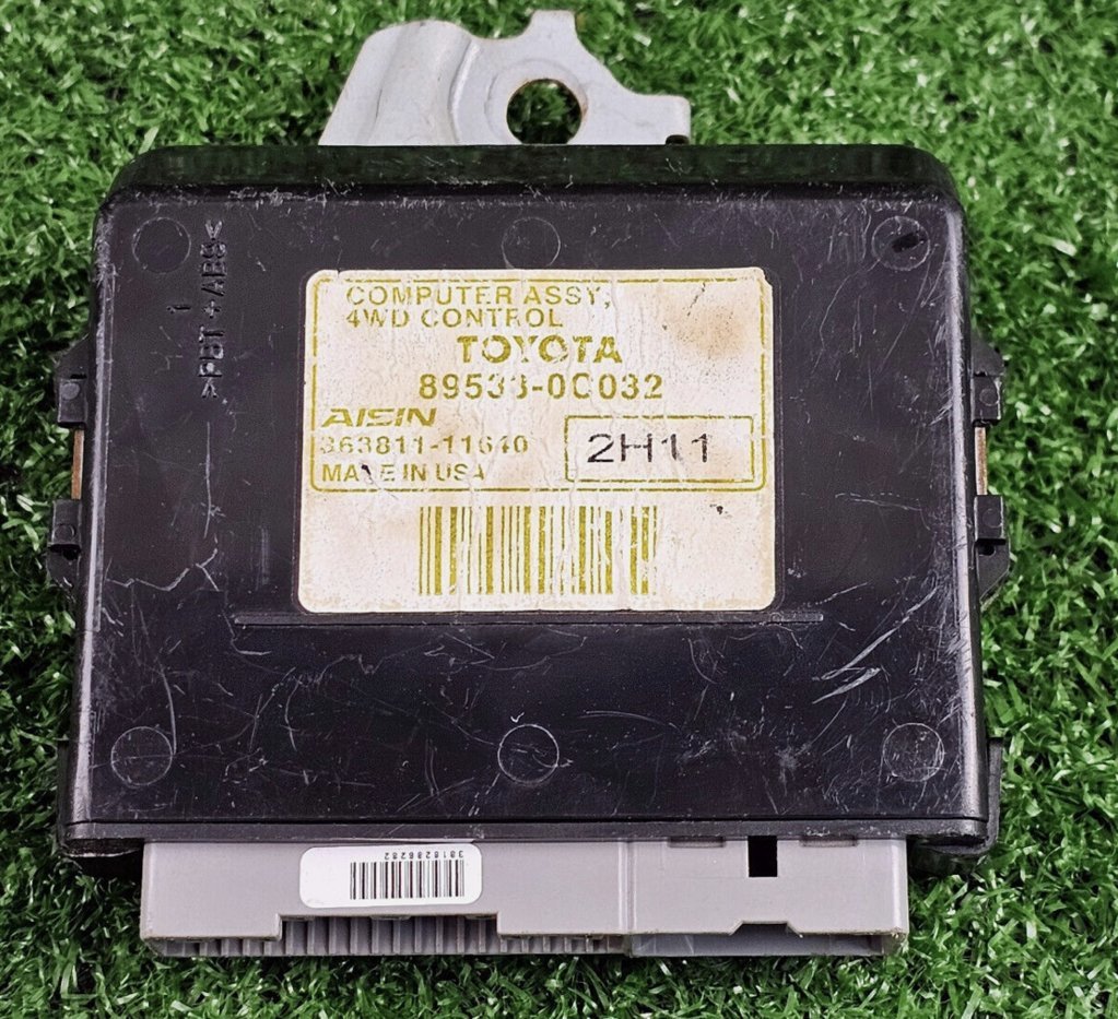

  9. Nov 4, 2024 at 4:41 PM
    #129
    Jowett
    Jowett New Member
    Mar 19, 2021
    #60646
    598
    Brian
    North Adams, MA
    2011 Regular cab long bed 5.7 Work Truck Package
    Many on the way.
    The 2.5 Gen receives a very different looking Borg Warner ECU. The big questions, can the existing tundra harness have the connectors swapped and re-pinned? If yes, will the Canbus in the Tundra talk to Sequoia ECU?
    Borg Warner ECU
    70F48669-FA73-4BB0-A4F4-7A4C2F1F2EFE.jpg 884A37D0-E60A-46BF-B65A-ADF30AFB8D59.jpg
    Sequoia ECU (part 89533-0C060 should be for 21, but verification needed)
    35C889BC-E08C-49E0-A76A-CD615D51D091.jpg FDD6640A-816F-4323-A099-3E072D6BF72D.jpg
    jhrrld, Mdl, Terndrerrr and 1 other person like this.

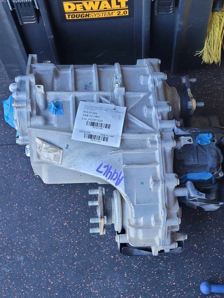

  28. Dec 8, 2024 at 6:13 PM
    #148
    LILTRD
    LILTRD New Member
    May 13, 2024
    #116789
    166
    East Bay, California
    2013 Tundra RCSB
    Hidden Winch Lighting Suspension/Air bags Wheels/Tires Audio Center Console swap
    Just got my TC, gonna join the club when I have time to install. Anyone have any tips for installing or wiring, I'll be doing the swap in the street in front of my house..
    Wynnded and ZappBrannigan like this.
  29. Dec 26, 2024 at 2:15 PM
    #149
    Kwe1982
    Kwe1982 New Member
    Sep 18, 2019
    #36325
    170
    Wisconsin
    2007 Tundra and 2011 Sequoia
    Started my Sequoia transfer case swap last week,
    Wisconsin winters suck, also do the swap before you apply Woolwax/Fluid Film.
    It has so far sucked,
    Couldn't get the cross member off and I left the Isolation bracket attached to the crossmember(completely seized up)
    I was able to get the transfer case out with the help of a transmission jack(by myself)
    (I had to have help installing the Sequoia one, didn't use the jack had to wiggle it around to get past the crossmember)
    Stripped out 3 of the bolts to the Transmission.
    Tried soaking them with penetrating oil from the back side, heat from a bolt buster, nada they stripped out.
    I drilled one out and ran a bolt thru with a nut on the back side, the others I re-tapped and used Red loctite.
    The Recut threads were a little loose but not bad.
    After I reinstalled the transfer case the re-tapped ones held up without stripping out, the threads were jacked up near the start of the threads at least.
    It was exactly 1.25" longer than the Tundra transfer case.
    Driveshaft was taken up to Green Bay to MSI, hopefully I can get it next week.
    Once I get the driveshaft installed I can lower it and add the new diff fluid.
