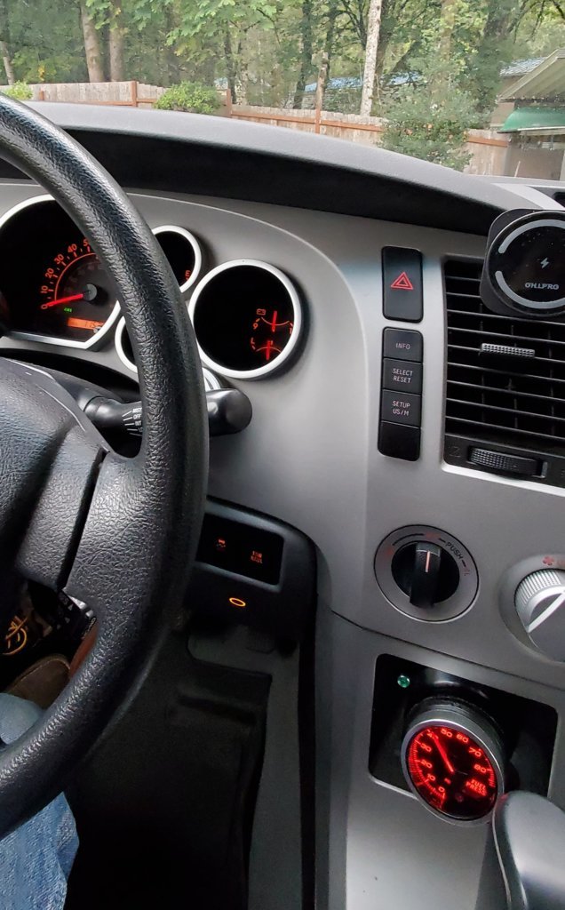

    I honestly forget exactly what I bought, but I based it all off this
    So here is what you need to make this swap happen:
    A 2008+ Sequoia T-case. I got mine from a wrecker from a 2008 model with 80000 miles on it.
    A Sequoia 4WD ECU. I bought a new one for a 2009 model. For some reason the 2008 and 2009 part numbers and wiring diagrams were slightly different, I took a gamble with the 2009 one and it is working fine. Probably the 2008 would work just as fine too. (PN 89533-0C022)
    A Sequoia center diff lock switch – fits directly into the Tundra dash. (PN 84725-0C130)
    A pigtail for the 4WD ECU wiring harness since the Tundra harness does not have the center diff lock wire going to the ECU. (PN 82998-12870)
    Have your rear driveshaft shortened by 1¼ inches and rebalanced.
    Ideally, have the front shaft lengthened by the same amount. A Sequoia front drive shaft might work too, but I don’t know that for a fact, possibly the front diff flange or position in relation to the t-case might be different. I will get a buddy at Toyota to measure one for me when he gets a chance. As mentioned, I reused the Tundra front shaft, but it lost about 35% of the spline engagement from what it is stock. I don’t think it will be a problem considering how much beefier those splines are than the ones inside the transmission for example.
    Remove drive shafts.
    Remove stock T-case.
    Send your drive shafts out to get shortened/lengthened.
    Install Sequoia T-case.
    Install modified shafts.
    Swap the 4WD ECU (on the right side behind the glove box).
    Install the center diff lock switch in the same spot as Sequoia has it.
    Install the pigtail wire into pin 12 of the large 4WD ECU connector.
    Wire that pigtail to ground thru the center diff lock switch.
    Done!
    The center diff lock switch arrived this afternoon. I expected it to have some bigger pins on it, so I could fabricate a wiring harness for it, but the pins on it are really small. What I ended up doing is I got an old connector from a used Lexus engine wiring harness we had laying around, and ground it down from 16 pin to a 5 pin so it could fit into the center diff lock switch.
    Since most of you don't have a spare Toyota harness laying around, you would have to order the connector and 4 terminals with pigtails from Toyota. Connector is PN 90980-12368. Terminals are PN 82998-24290 or 82998-24300 (get whatever is cheaper).
    I connected 3 of the leads to the conveniently located Tow/Haul harness, where I got Illumination and Ground from. Last terminal goes to pin 12 on the 4WD ECU.
    I also installed an indicator LED right next to the center diff lock button to tell me when the diff is actually locked. Run power to the positive side of LED and run a wire from the negative side to pin 14 on the 4WD ECU. It works perfectly!
    The green and yellow wires for illumination apply ONLY to the tow/haul switch.
    Other switches all use different color wires.
    On the tow/haul the green is ill+ and yellow is ill-, but some other switches have yellow as ill+ etc.
    Let me know which switch you are tapping into and I'll tell you the wire colors for the illumination circuit.
    What I DO remember however, is that I did not specifically need the "Terminal, Repair with Wire" Part number 82998-12870. The other pigtails I orderered were exactly the same and literally $38 cheaper (had to buy the one wire from the stealership and got bent over as usual when dealing with them). So just order an extra pigtail in lieu of 82998-12870.

    I added a cheap $10 momentary switch for the diff lock. Works as intended, mounted below tow/haul and alsd button lights up when locked.
