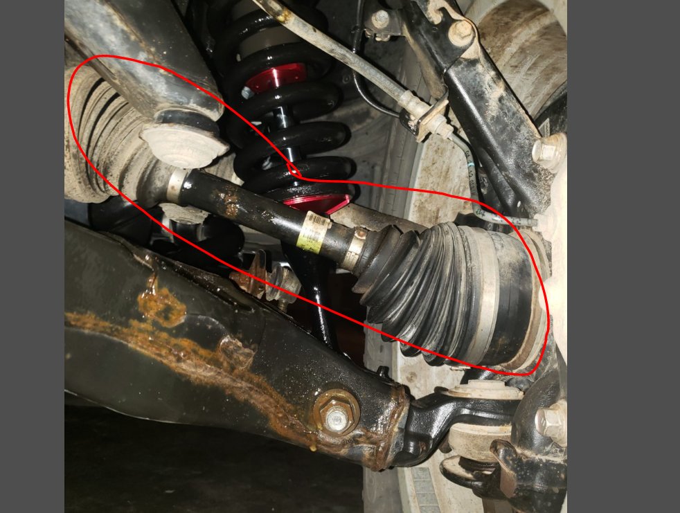

    See if you have a CV axle going into the center of the front hubs. 2wd will just be a flat area behind the center of the wheel.

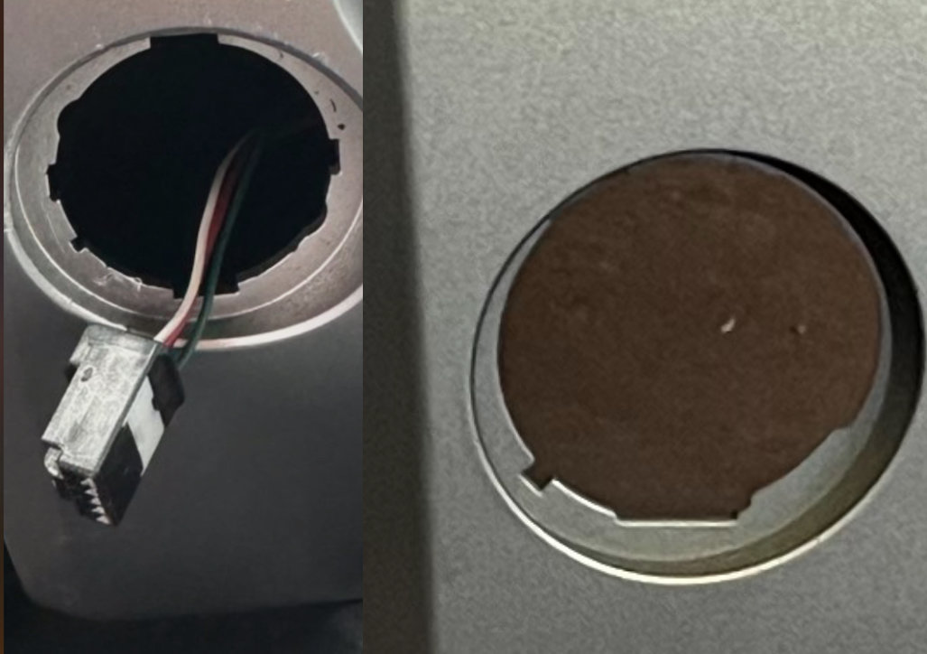

    Chances are someone replaced that part and ordered the wrong one..
    I'd say those chances are 100%..:thumbsup:
    Gen 2.5 (2014 to 2021) don't have any kind of OEM 'change holder' in that location.

    You’ve got the wrong dash trim piece, or you’re in a 4wd….. there is no coin holder or opening on the 2wd models post 2014 refresh.

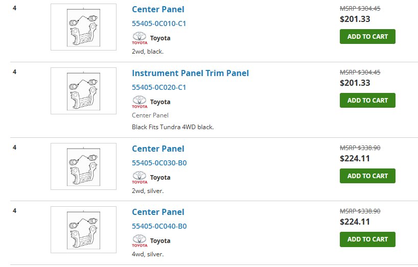

    You could try putting up a 'want to buy' post in the marketplace and see if anyone has a 2WD silver one for sale.
    Some guys replace that part with the black one, it's something I'd like to do in the future.
    They might have the old one sitting in a box in the garage or attic.

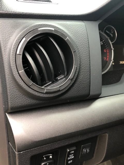

    ld8c5d7f_a92ff465ef0cb869c5c88cd8236e15a0ef541656.jpgijh4tcdl_2b2568dc4eb1fe785a26d5ff477b1d1f111c83cc.jpg3t3li4jp_f3b720d70370847d82ad9572b161516a71f4f9c7.jpg

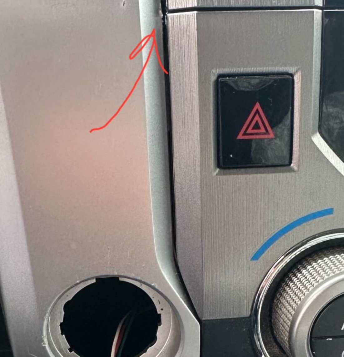

    Pry marks, Someone’s been in there before….

    Either you have a 4wd truck or previous owner damaged the original and tried to replace. But I don’t think a 2wd would still have the plug for the switch.

    Most Toyotas share the main harness across trims. Many options are made easier to add in because of this.

  19. Dec 29, 2023 at 1:05 PM

    My Tundra doesn't have that axle going to the front hub so it's definitely a 2WD. I learned something new today, thank you so much!

    Thank you everyone for chiming in! I guess one of the previous owners swapped out that silver dash panel from all those pry marks that I didn't even noticed. Happy New Year everyone!!!

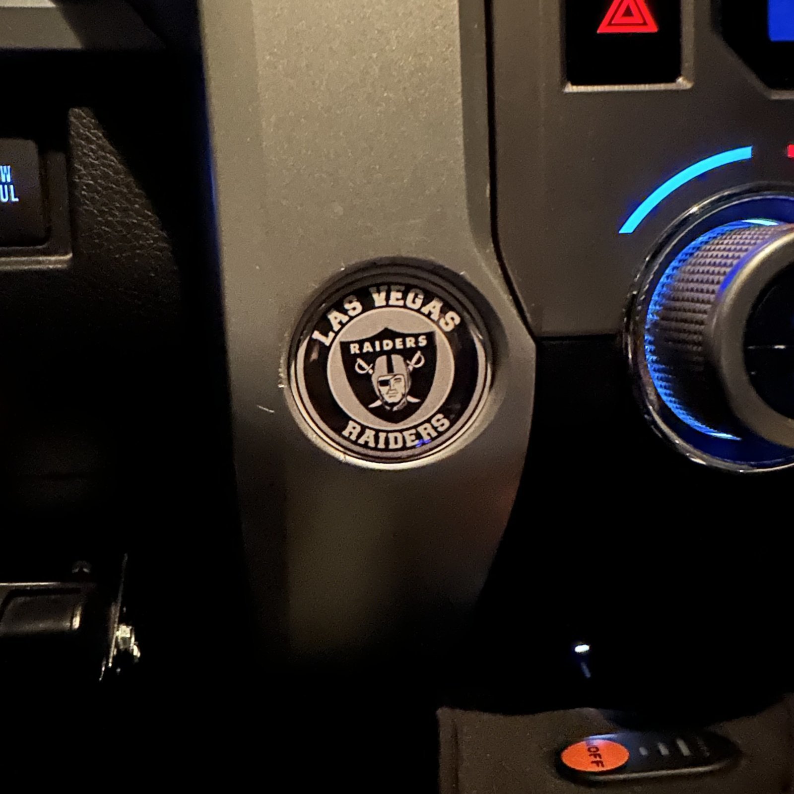

    Well, I came to a perfect solution to cover up this hole. Even tho my Raiders suck, it actually looks good and fits perfectly with no glue or anything.
