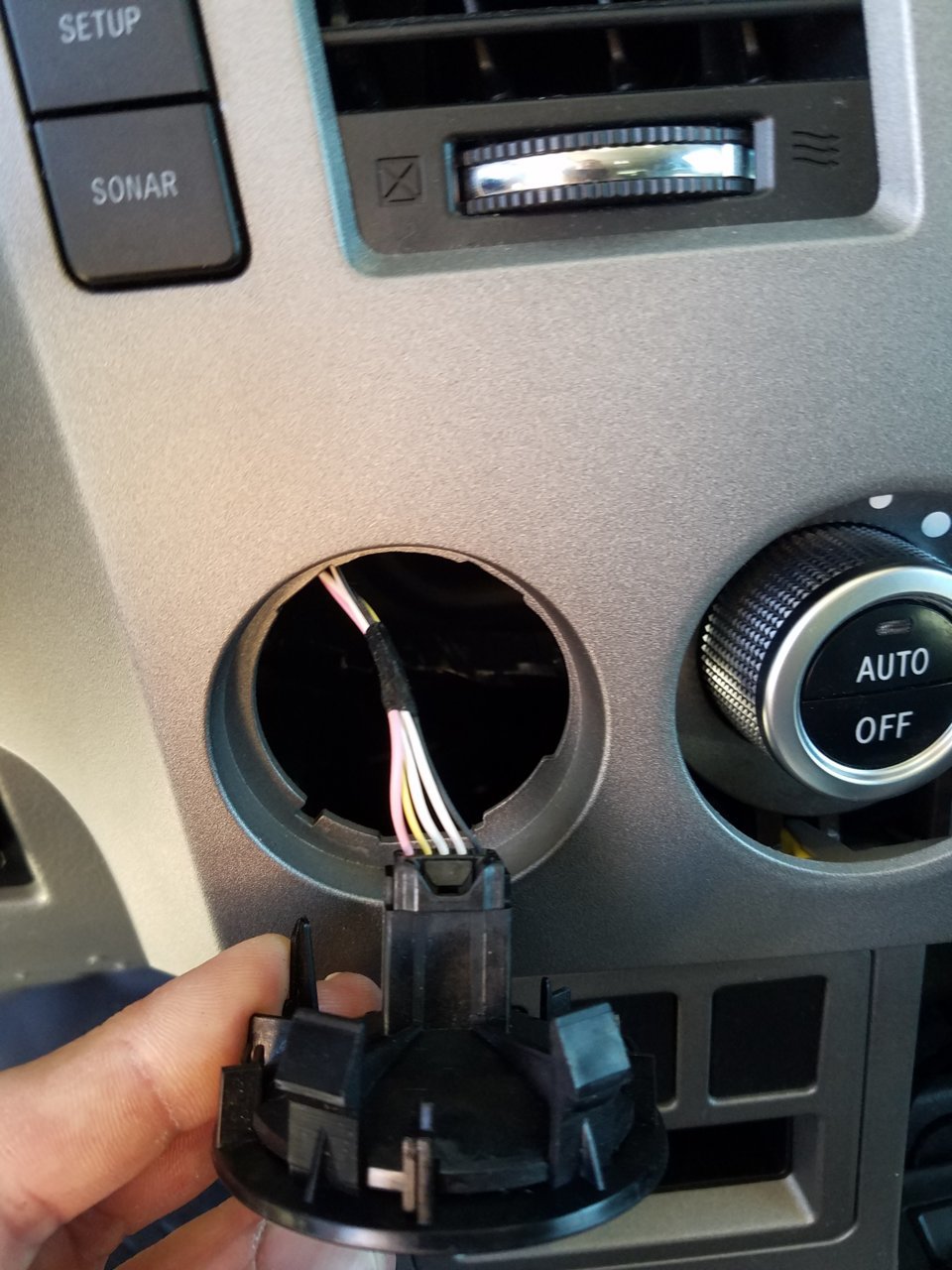

    No, you need to pop out the panel its on. There are clips on the back that release it IIRC.

    I just popped the trim panel off a little where it wraps around the climate control knob.
    Then get your fingers behind it and squeeze the tabs that you feel.
