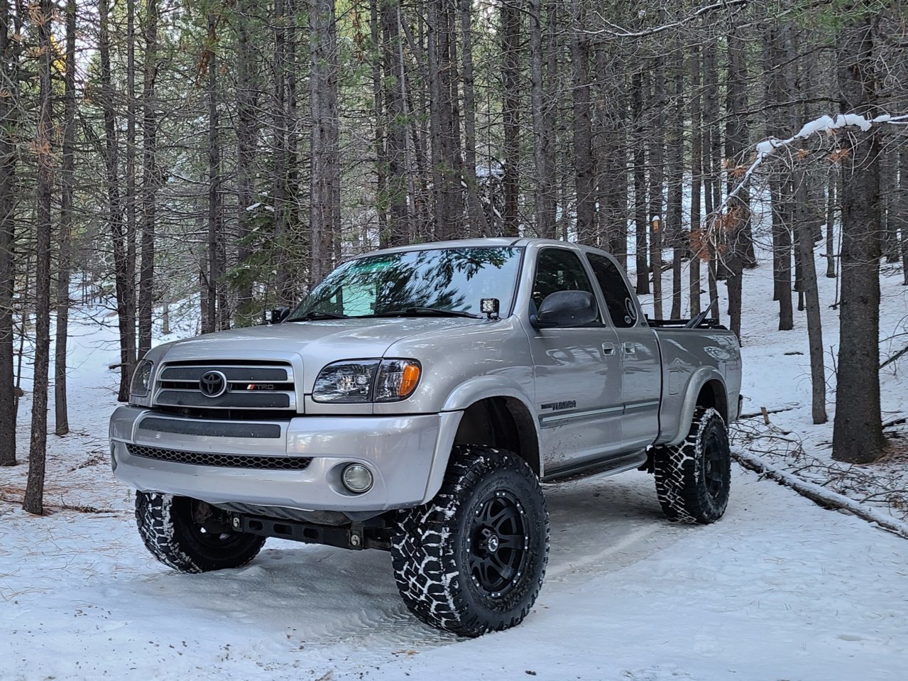

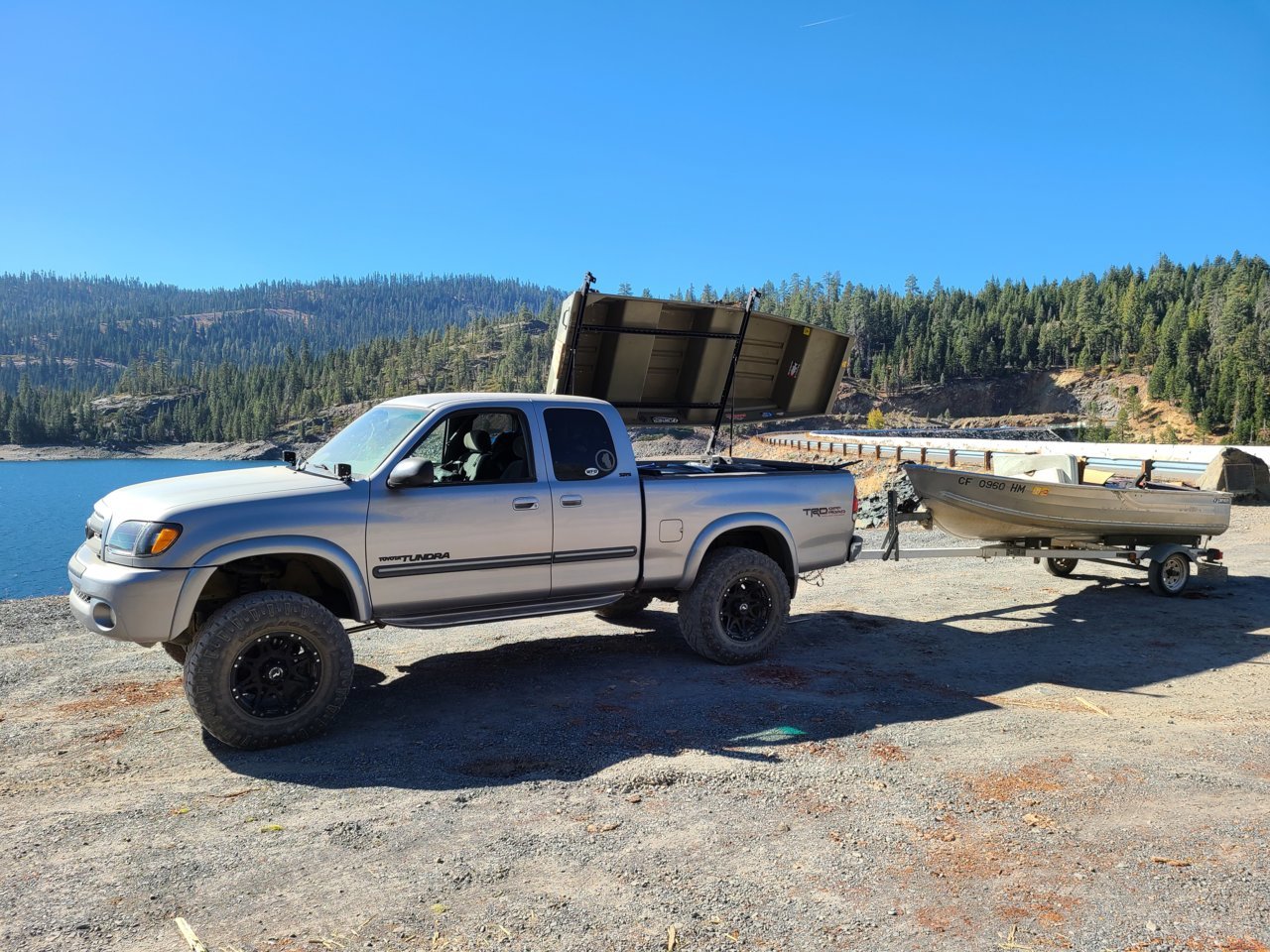

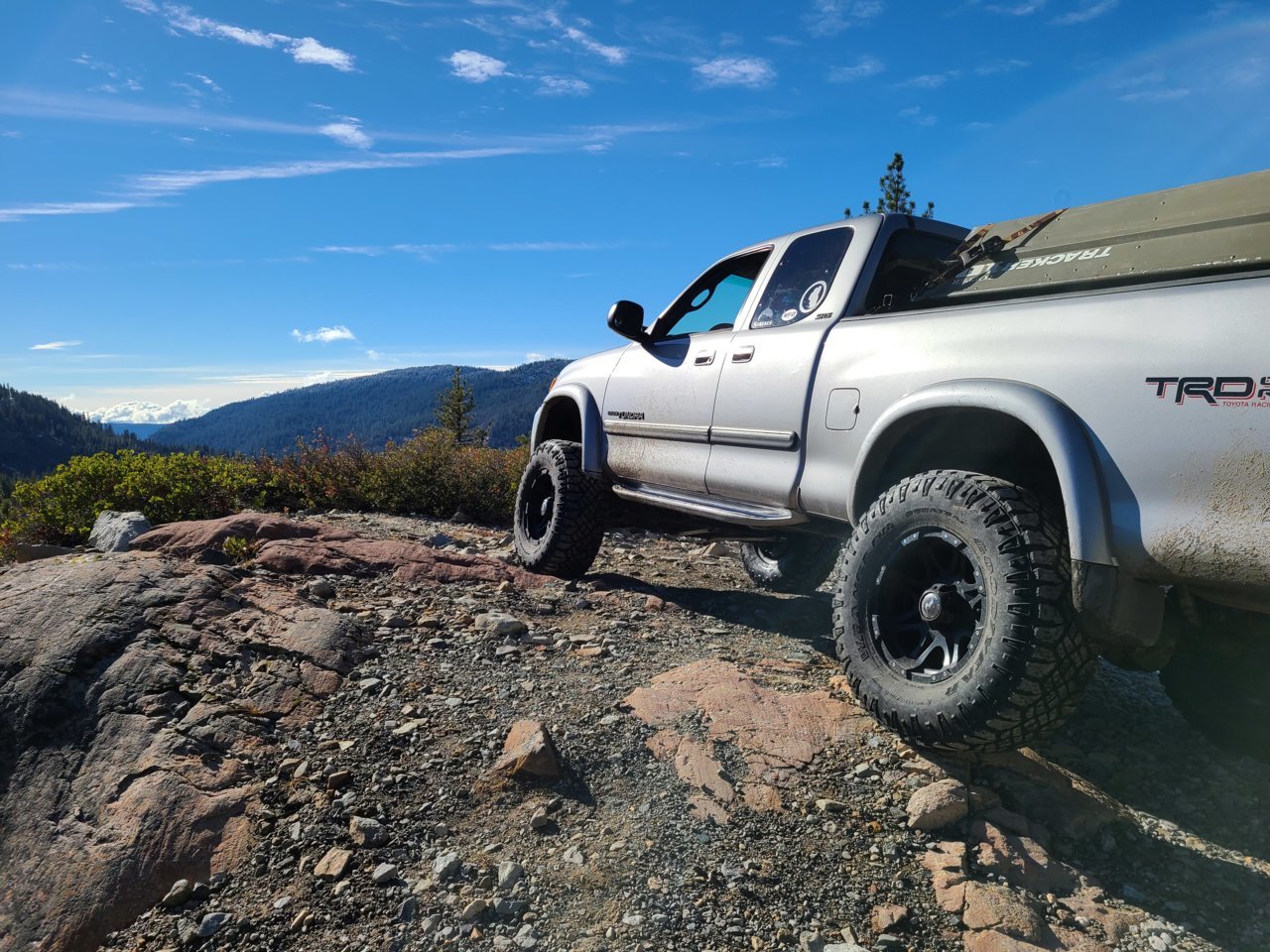

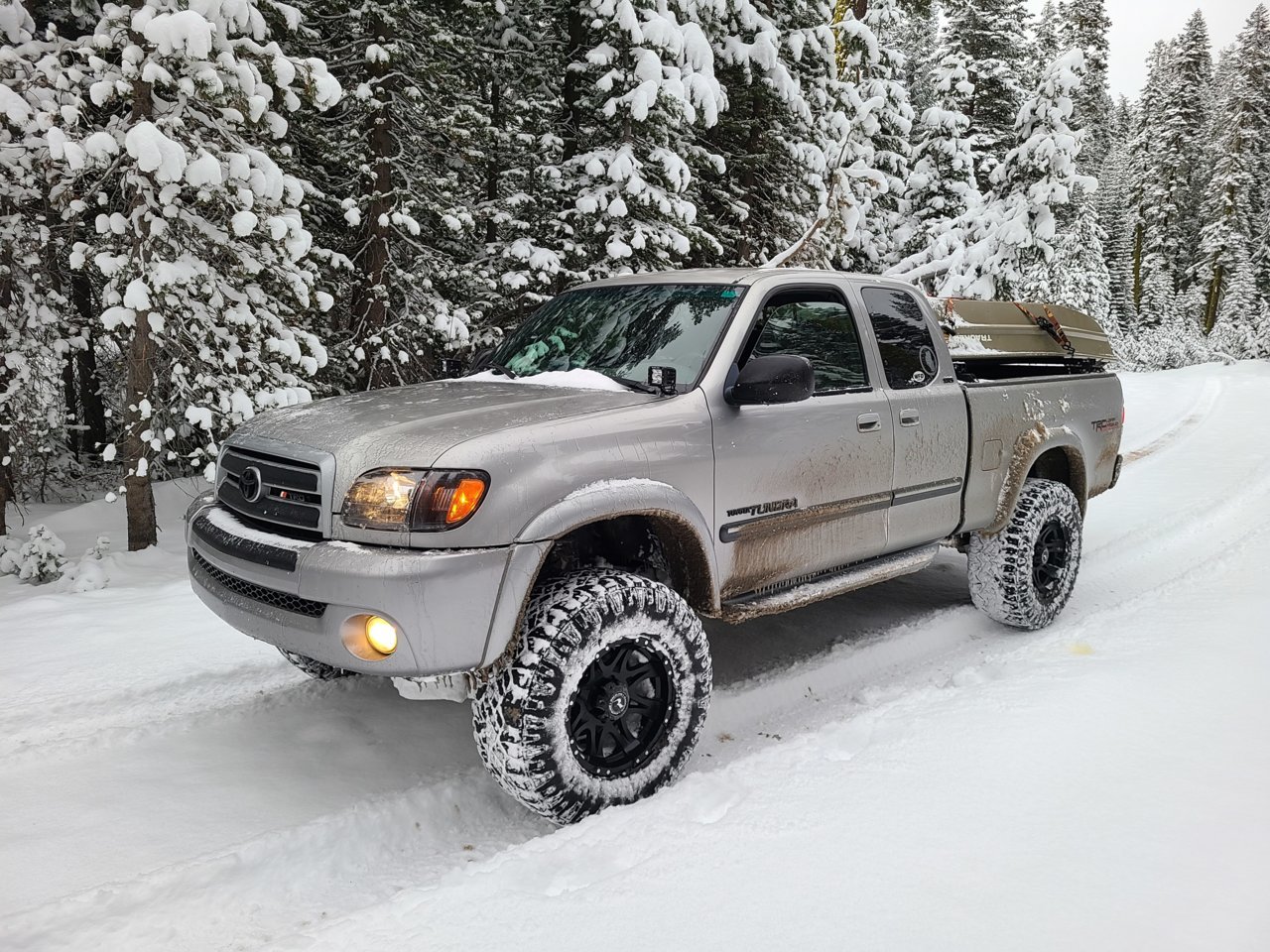

    -6" RCD lift in front. -Custom leaf springs in rear 4" lift. -17" race line, raptor wheels. -35" Goodyear Duratrac. -4.88 gears. -ARB rear air locker. -ARB air compressor and tank. -Custom front sway bar quick disconnect -Custom one piece driveshaft -Black Oak Led 40 watt ditch lights.
    The rcd 6 inch lift is a good option. I have it and love it. Its built very durable. Drives really good on and off road. You can fit up to a 35 ince tire. The only thing I don't like is it comes with 4 inch blocks for the rear witch are terrible. To much axle wrap. I had to get custom leafs made for the rear to replace the lifting blocks.
    https://www.bilsteinlifts.com/shop/...MIw-GQqMOO8gIVRAp9Ch0oTQHfEAQYASABEgJPnvD_BwE
    A few random pics.
    20201129_155335.jpg 20210521_064909.jpg 20201212_122709.jpg 20201025_120402.jpg
    Lil Steve, abcinv, GODZILLA and 4 others like this.

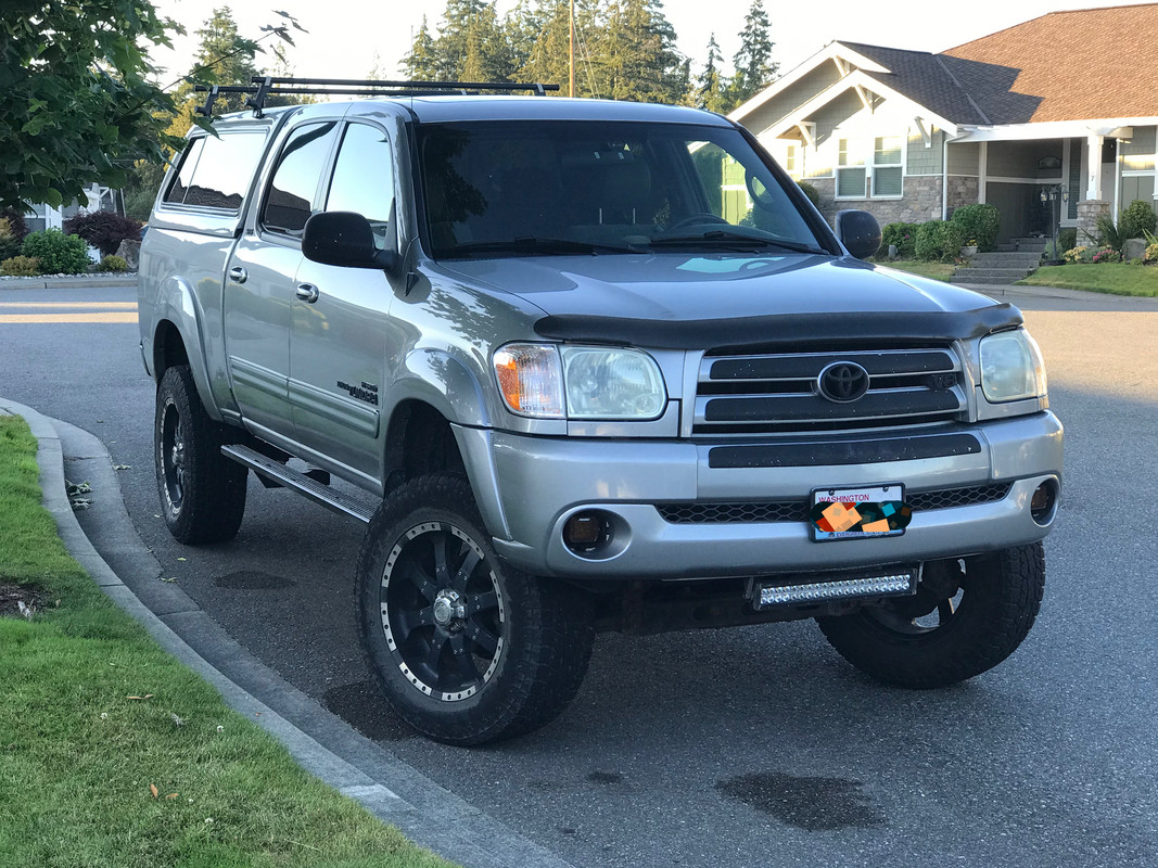

    Agree with most everything here. I'll preface with I never drove the pickup without the lift. I wouldn't go as far as to say the blocks are terrible. They're less than desirable, for sure. If you get the lift, should you buy new springs and never install the blocks? I wouldn't say so. Unless you have cash to burn, run the blocks until you can put enough scratch together to get new springs. Have a look at it. I'll say it's the best prefabbed 4" lift for our 1st Gens.
    A few random pics of my Tundra.
    Lil Steve, shifty` and TRDGen like this.
