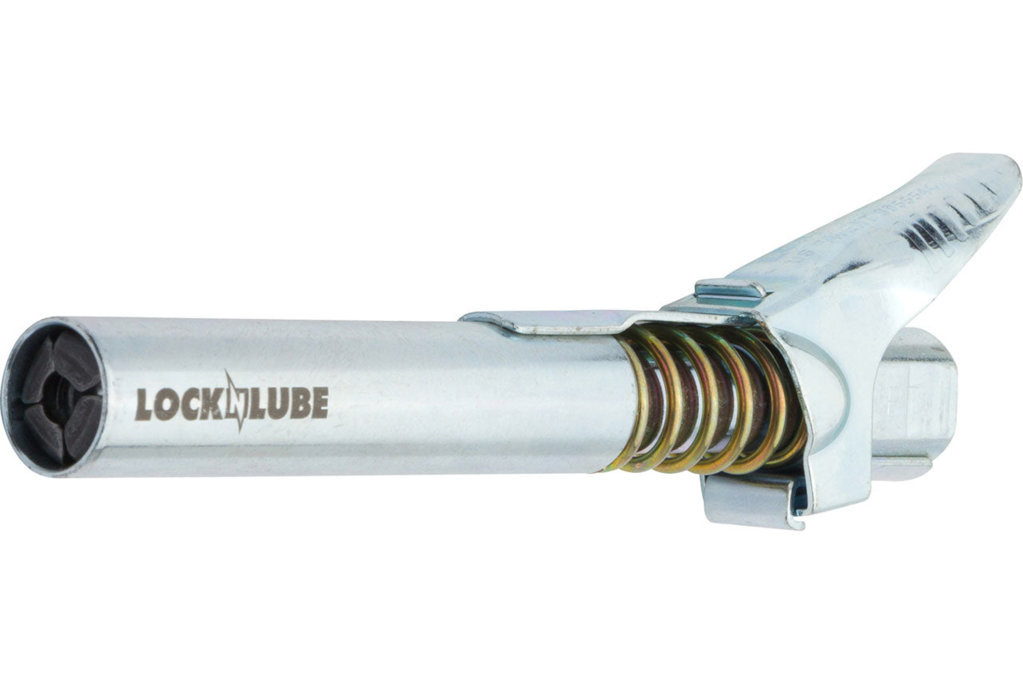

    Pretty sure you stick the zerk-looking end of the fitting into your gun, then jab the needle into the ball on the truck's zerk and pump in fluid that way.
    EDIT: Go back to the scAmazon page and look at the video on the product! Just confirmed, what I typed a sec ago is accurate.

    That looks like a pretty tough fit, to get it to line up, but I think I'll give it a shot.
    Thanks for all of the help. You guys are great, as always. I'm going to try the slip yoke again. Pump a bunch in there, get out and jump on the bumper a bunch, and then pump some more. I don't think I'll take that zerk off. Like I mentioned, I've already broken two bolts off on the Tundy just to do an oil change. About over that.

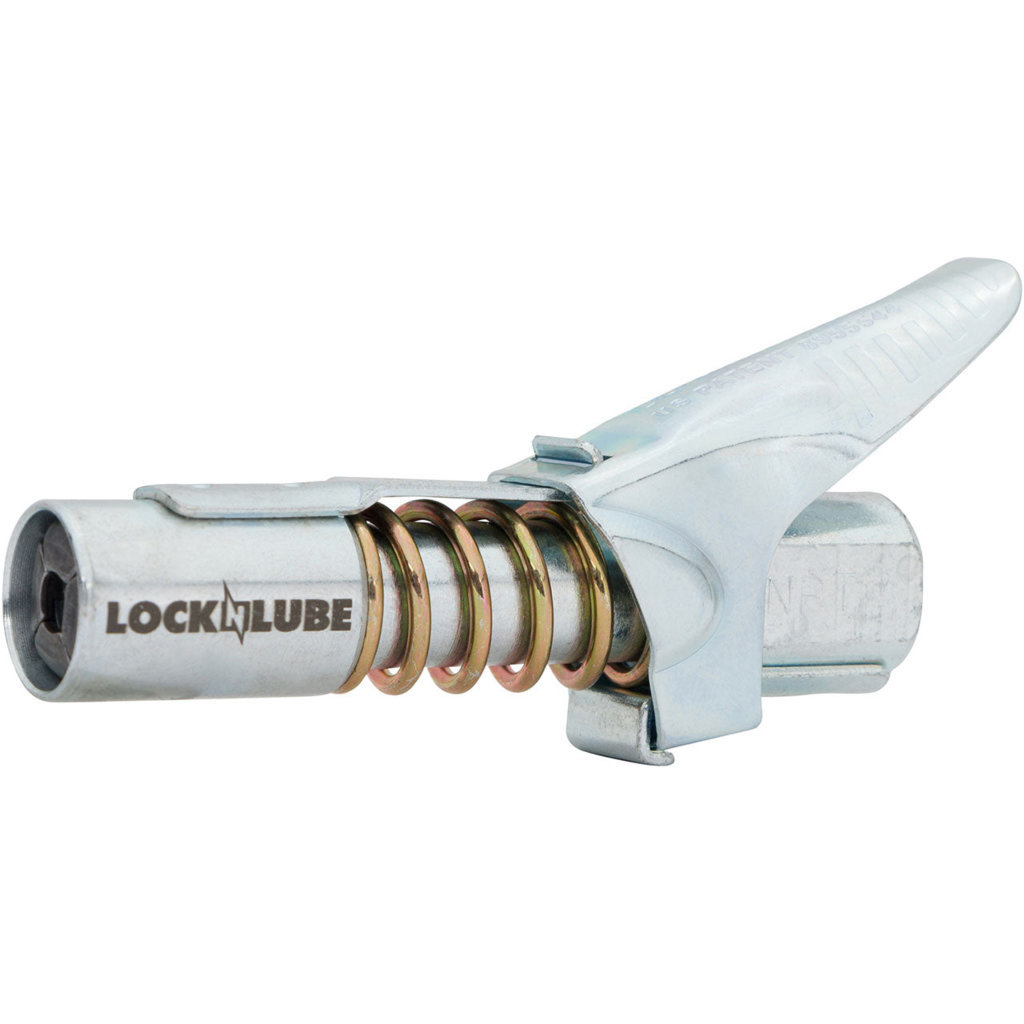

    Lock'n'Lube sells one. https://locknlube.com/products/push-on-90-grease-coupler
    That said, you can probably find others. I'm not in love with the way that one functions, but it was a painful necessity on my C10, with some of the fittings it used and their lock. BEFORE I BOUGHT IT, I'd recommend using the other trigger-operated Lock'n'Lube unit others swear by, and say works on all of our zerks. Thise one: https://locknlube.com/collections/l...cknlube-grease-coupler?variant=32586284204116

    The 2nd link in my post is what a handful of people on this forum swear by. If you want firsthand testimonials, there are probably two dozen or so on this forum, but here's one from @JakeJake: https://www.tundras.com/threads/wha...-gen-tundra-today.2558/page-2156#post-3722077
    Before I spent any money on the needle adapter, i.e. my first link, I'd go with the standard stubby lock n lube, i.e. my second link. Yes, it's spendy. But according to others on here you won't need another for the 1st gen, or any other gen. The 2nd+ gen guys swear by it too.

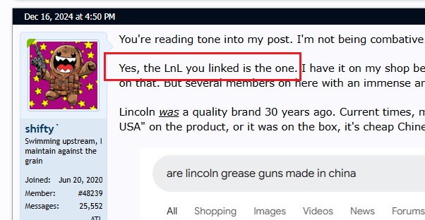

    Thank you. Yeah that costs almost as much as my grease gun and not fully convinced it will fit on the front driveshaft zerks.
    Edit: is the "Lock n Lube" @JakeJake refers to the $33 coupler you linked above (second link)?

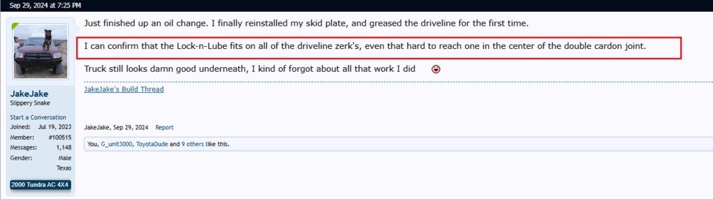

    Ok, so you bought a cheap grease gun. But if you're going to blow off hundreds of cumulative years of mechanical knowledge of people on here who have been wrenching their whole lives and say it works, why bother asking?
    You literally have one of the more mechanically inclined dudes, in that post, saying "This fits on every zerk". JakeJake alone's word would be good enough for me, but if you search the 1st gen forum for "lock n lube", you'll find at least half a dozen or more other members who use that exact tip and have zero issues with their OEM joints.

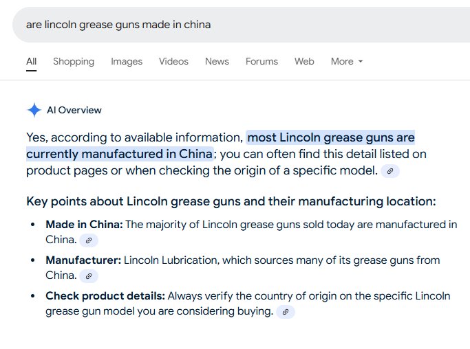

    You're reading tone into my post. I'm not being combative. Asking a genuine question: Why ask for advice if you're going to blow it off?
    Yes, the LnL you linked is the one. I have it on my shop bench downstairs because so many veteran mechanics spoke so highly of it on here, I wanted to see what the hype was about. I still haven't gotten around to putting it on my gun. I'm in process of rebuilding my backup gun, and was going to toss it on that. But several members on here with an immense amount of collective mechanical knowledge vouch for it. It's spendy, for a reason.
    Lincoln was a quality brand 30 years ago. Current times, most Lincoln products I've seen are being made in mainland China, same as all the scAmazon crap, but with different colors/silkscreened names on it. The 1134 was originally made in the USA, but unless you specifically see branding saying "made in USA" on the product, or it was on the box, it's cheap Chinese garbage. It's the main reason I use vintage guns: They're easily rebuildable, and they're quality USA-made (or sometimes Taiwanese-made, which are still solid quality moreso than the mainland stuff).

    Yes. You depress the ball fitting in the end of the zerk with the needle and then pump the grease. Again, this is only on the ones that I can't get the normal coupler on, which I think in total is two.

    The lock n lube gun is actually super awesome and made NH USA, it is spendy but worth it if your pumping lots of zerks. I’ll have to see what the new dept uses; probably the cheap crap and replacing it bi-yearly

    Thank you. This is a great compilation. Again my only question on it was to confirm that the "Lock n Lube" one was this guy. There are multiple ones, as shown in this thread. There's a needle one too.

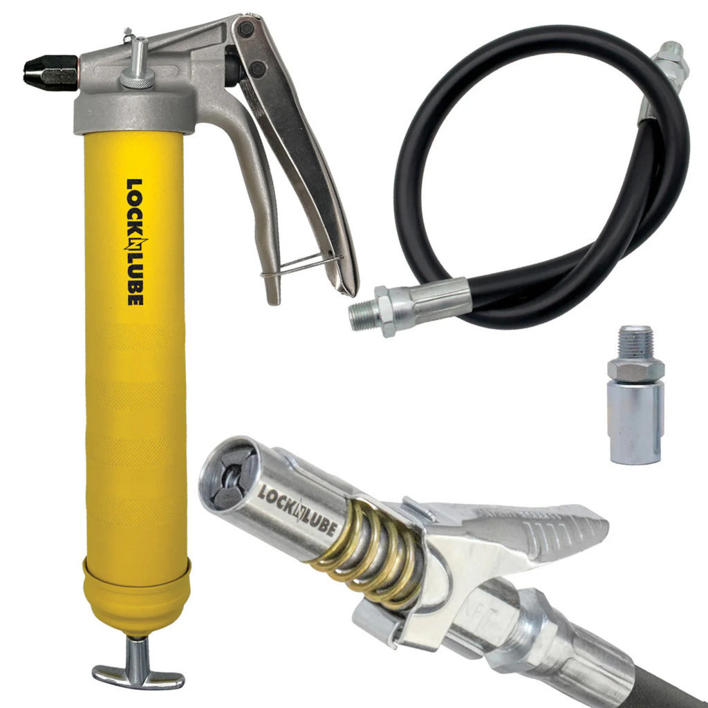

    #53
    Halsted
    Halsted [OP] New Member
    Jul 15, 2024
    #119916
    84
    2004 Tundra 4WD V6 AC Manual
    Nice tip! I found this one which has the gun AND the coupler. Sweet!
    Honestly have to say it looks IDENTICAL to the Lincoln 1134, down to the knurling on the barrel. Maybe the rubber on the handle is different.

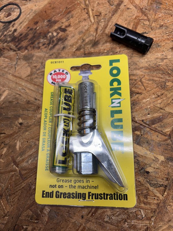

  25. Dec 16, 2024 at 4:19 PM
    #55
    shifty`
    shifty` We call it “riding the gravy train”
    Jun 20, 2020
    #48239
    29,764
    ATL
    '06 AC Limited V8/4WD
    Yup, answered above. Same one I'm showing on my shop bench here:

    2004 Tundra SR5 AC 4.7L 4WD, Tow Package: Blue Marlin Pearl
    Per Shifty pic above, the Part # is GC81011 which was reported by JakeJake over here for the standard shorty:
    https://www.tundras.com/threads/wha...-gen-tundra-today.2558/page-2156#post-3722368
    I'd like to know more about the XL coupler but Tundra2 is the only person I've seen use it.
    It would be nice to hear from and compare notes between @JakeJake and @Tundra2 to see if there were any difficulties getting on specific zerks between the standard or the XL.
