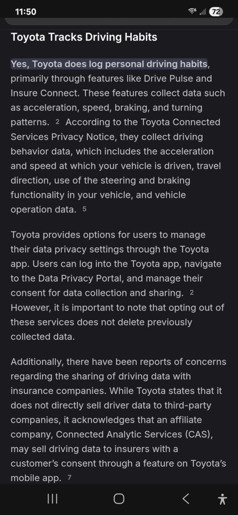

    EmergencyMaximum
    EmergencyMaximum Synthetic member
    May 28, 2022
    #78904
    1,837
    It's easy. All the telemetry budget went into only logging personal data and driving habits to relay back to Toyota to be sold or for 'improving' future products. After buying a 60k product, you are the product.
