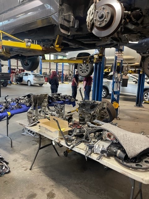

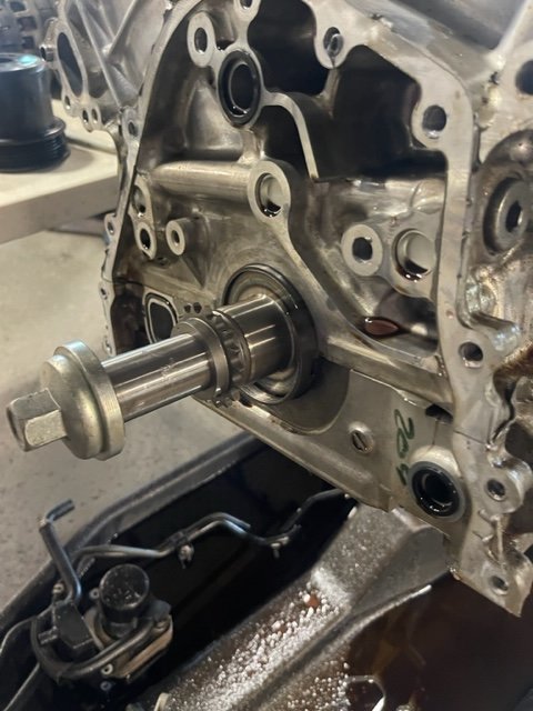

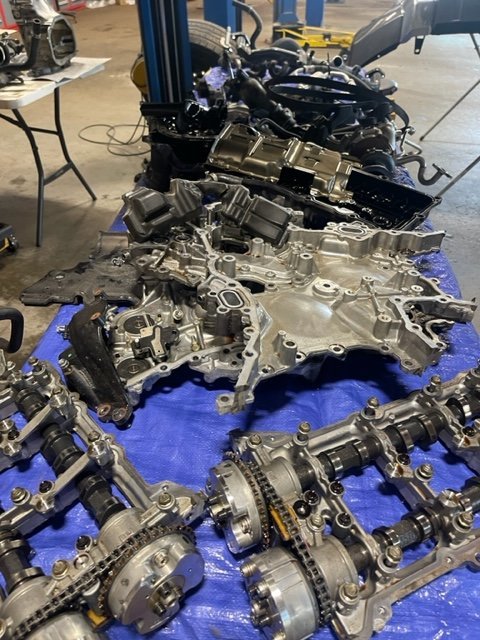

    -What actually happened:Bad knocking on start up. Check engine light and many other lit up. Dealer diagnosed cylinder 6 misfire and metal in oil so engine rebuild was there solution.
    -Vehicle usage (towing/off-roading/pavement pounder):Highway princess truck used for work only. Cargo weight average is 3-500 pounds when loaded with tools and material.
    -Vehicle modifications (tune/geared/tires): 2” leveling kit in front end
    Other previous issues - rotors resurfaced at 20k and now need to be resurface again at 28k due to heavy pulsating and shaking when braking. As well as suspension clunk when braking to a stop from 30mph or higher. Dealer couldn’t recreate issue but found my front bumpers were getting chipped heavily so looks like it’s bottoming out maybe due to 2” lift? Has not been a fun ownership after 20k miles.
