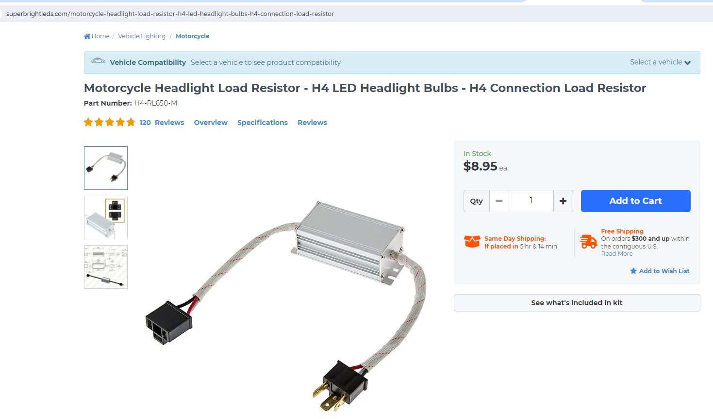

    Aluma Series, JBA UCA, Wheelers add a leaf
    Yep, Knabores on point, just bight the bullet and go Co-light- HUGE upgrade. I had some issues getting the doggone things horizontal because mine had an adjuster screw in the center of the projector, that needed to be slightly rotated. Once I figured that out, the cutoff was level and all needed was to adjust the housing as you normally would (with the housing). It really is super easy, its just the unknown that is worrisome initially. Oh, you will likely need a resistor once installed to get fogs and highbeams working properly. The company I used was called Superbright-LED or something to that effect, 209Tyler on Youtube has the link, I may have posted it was well. I bought two, but only needed one to get all operational. Its been like 4 or 5 months since and zero issues and zero people flashing me on the road. All good!

    I found my receipt, heres the resistor- URL is at the top of the screenshot:
    noahrexion and Jack McCarthy like this.

    I believe it’s the 2003 and up that need resisters. I didnt need any with my 2000.
    bfunke, Jack McCarthy and BroHon like this.
