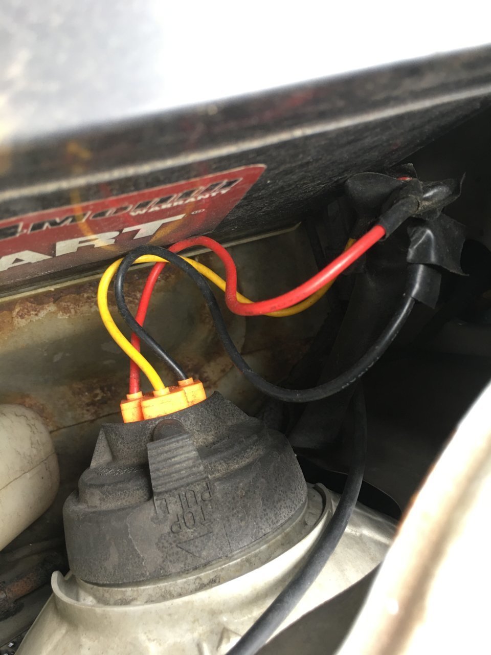

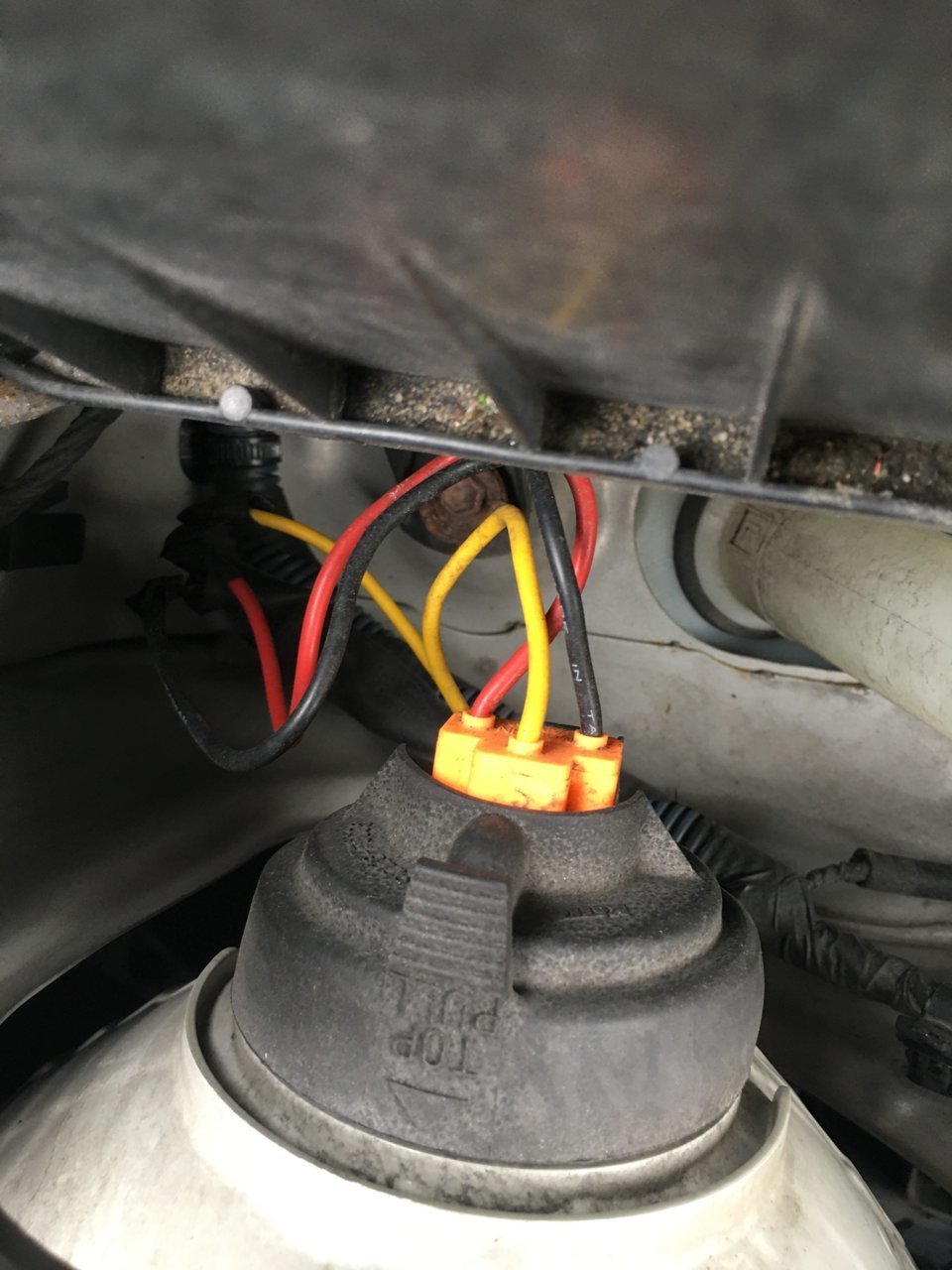

    From the "Lighting info ..." section of the megathread, see the 4th bullet point here:
    • If replacing your housings, be sure whatever you buy is "CAPA Certified", it's at least baseline not-garbage product. For brands that are higher-quality and will last longer, most offering CAPA certified options, go with Depo, or alternately EagleEyes, TYC, and some say Akkon make good product.
    • If swapping to LED headlights or fog lights, the overwhelming majority of people have problems with high beams and fog lights working unless they purchase and add a resistor on at least one headlight so enough load is on the circuit - this may not be necessary if your headlight housings have the extra "teardrop light" in the corner of the housing. Problems have been reported with LED tail lights also, it's not just headlights. Some circuits require resistance that an LED won't deliver.
    • Hyperflash problems are common after swapping LEDs into the turn signals. This can be solved installing a Diode Dynamics flashers (avoid the scAmazon knock-offs, buy direct).
    • There are H4 mini-projectors available for our trucks, but you'll need to permanently modify the light housing, no oven-baking required, just remove the hat-shaped chrome shroud inside and install the light (detailed instructions). Likewise there are bake-in options for projectors. Check THIS REPLY for common headlight upgrage options, with links.

    Strangely, I’ve never had to replace the OEM bulbs in the 22 years I’ve owned my truck.
    Only had to replace the connectors that burnt out and made me believe I had a bad bulb.

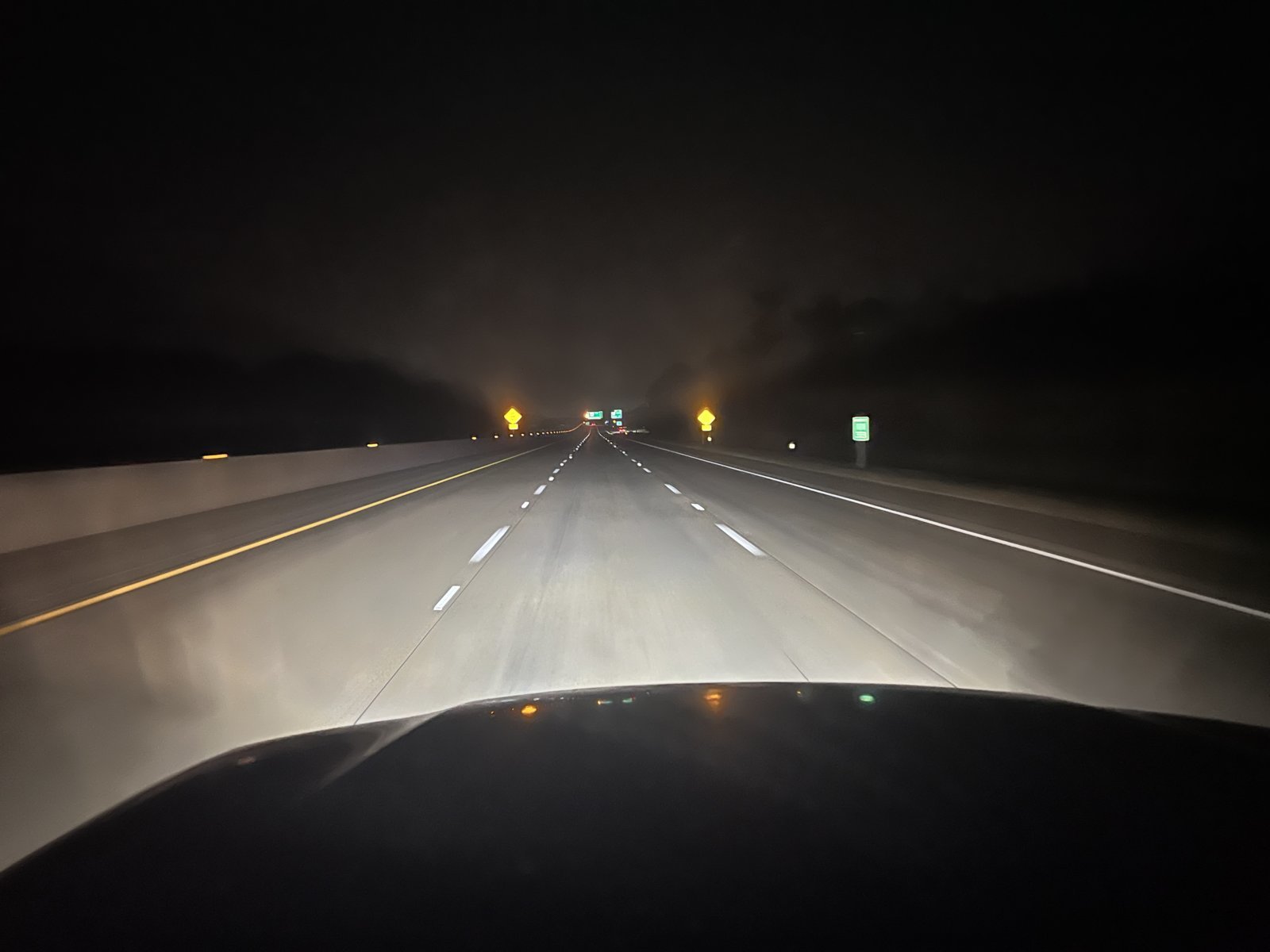

    They have an excellent cutoff on them and can be adjusted just like an HID projector. That pic I posted was before the full adjustment was done. Since I leveled the front of my truck and my rear leafs are wore out, mine were aiming at the sky initially. No one has ever flashed their lights at me since I adjusted them.
