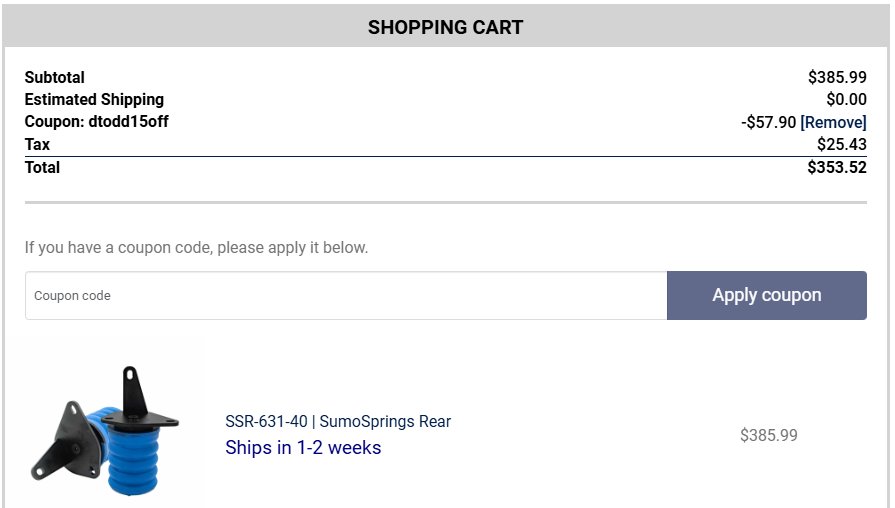

    And I found this discount code for 15% off
    DTODD15OFF
    it worked for me :D

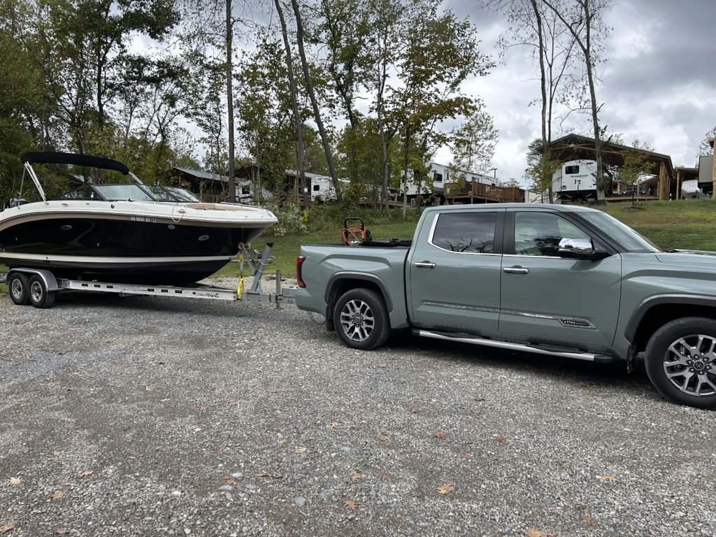

    So I finally had the boat on the back today. What a difference. 8000lb boat, 800 lb tongue weight, truck dropped to roughly level front and rear, not the sagging rear from the first time I towed prior to installing the sumosprings. It was a comfortable ride with it on there, they had sufficient give that it did not jounce or hit hard on bumps, quite impressive. I highly recommend this solution if you tow.

    No before pics, but it was heavily squatted. Here it is ‘after’ with about 200 pounds in the bed plus the boat. Angle is misleading, that boat and trailer are 34’ long and 8000 pounds with 800 pound tongue weight roughly.

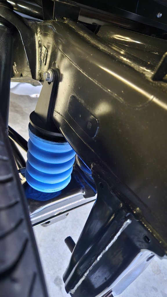

    Just installed a set on my 2024 1794 and plan on pulling a boat. Thanks for the info was not to bad of an install, (no need to take the wheels off) only tricky part was the screw that sits closest to the spring on the bottom has to be pre installed and started (with and open ended wrench) before the other two are set. but over all not to bad. I have a good haul from PA to VA planned in November so hopefully they work as well as everybody says they do. P.S. the socket and wrench size is 12 MM not 14 for the stock bolts.

    Ok, ordered mine with discount code, thx btw. I'll post pictures before and after.

    Ordered mine today as well, discount code still worked. Thanks for all the input on this thread, it helped me make my decision.

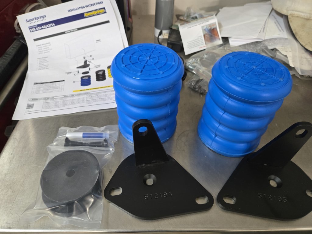

    ok, so went to install these today. The one bolt does not clear, as you mentioned. Is the only way to make it work is to use the spacers and tighten with a wrench vs a socket?
    I was hoping to avoid the spacer, as the gap with spacer is only about half an inch

    Use spacer, put bolt in & start that by hand first, then you'll have to use a wrench for that one.

    Got it. Thx. Easy install overall

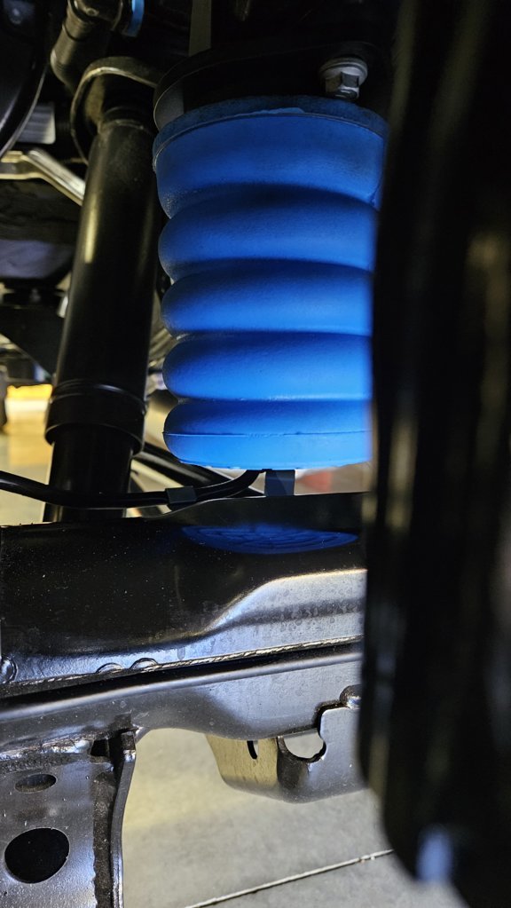

    Here's mine installed, I took the wheels off just to have more room, but it's not necessary. There's about 3/4" between top of axle & sumo spring. 20241008_152647.jpg 20241008_152610.jpg
