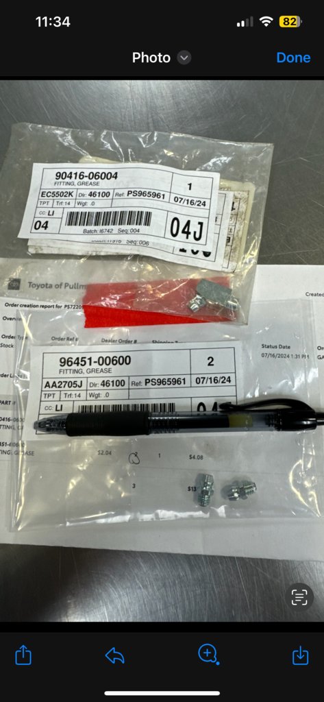

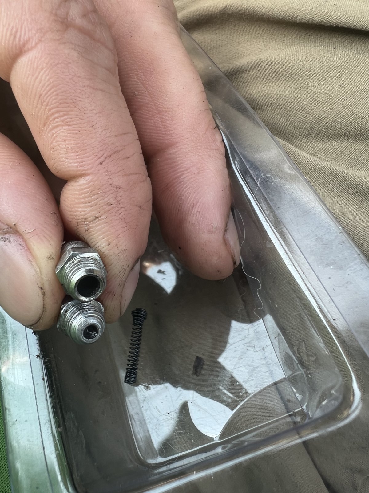

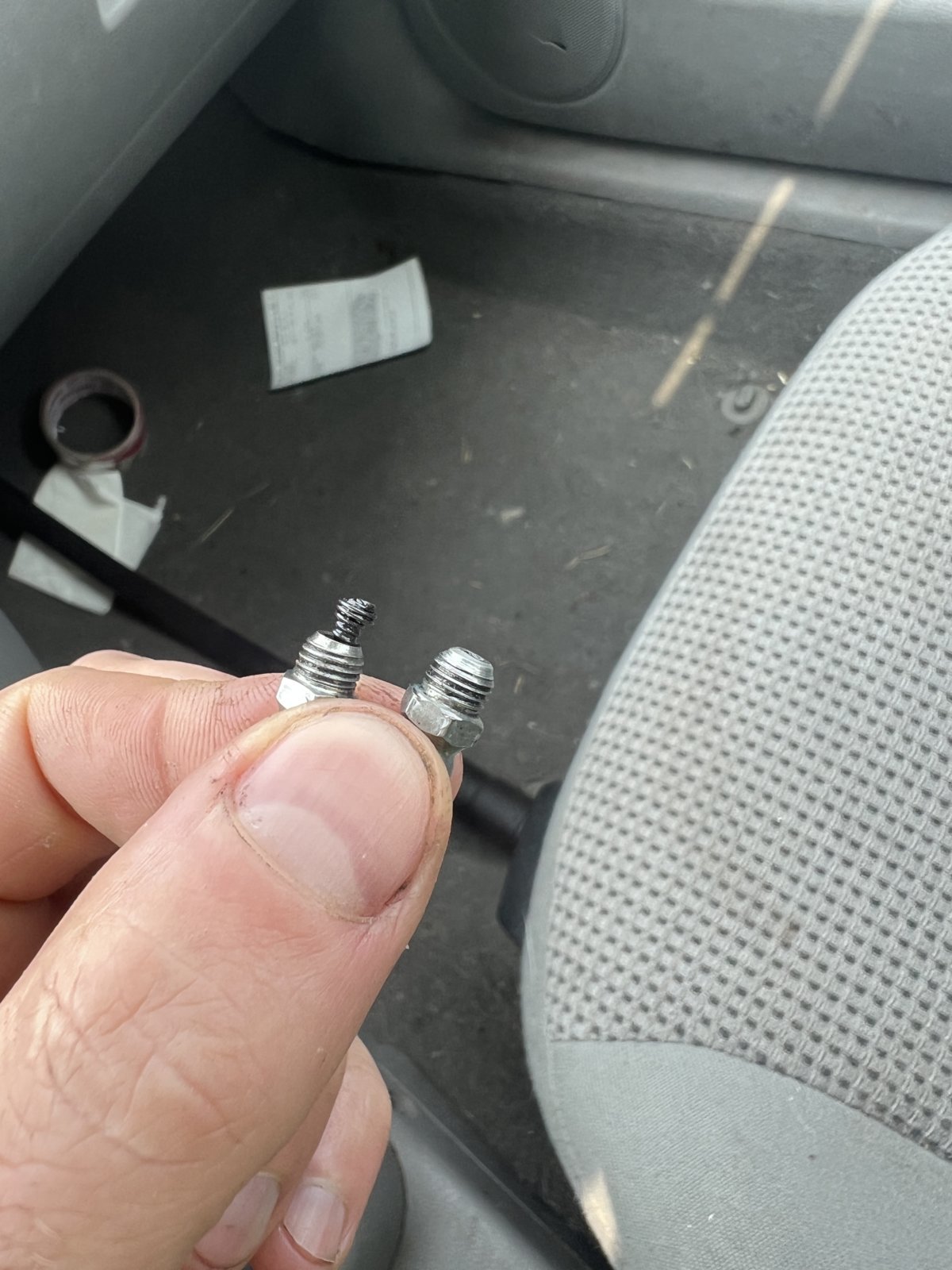

    I ended up attaching a neodymium magnet to the end of my zerk that I pumped the retaining ball into, haha. no catastrophic failure yet so I think the magnet has kept the ball out of the joint and harms way.
    No, I'm pretty sure just the one did. Or just the ones that were 2 parts and elbow shaped.
    Just tight enough that the grease doesn't come out around the threads and loose enough that you don't break it. I wouldn't worry about Torq spec unless you are a chronic over/under tightener.

    Thanks @Bed Tundy. That was very helpful. Do you know if all our zerks have the 6 mm hex head for removal? I haven't done the tailgate hop on the slip yoke and wanted to have a few spares around just in case I need them or have a clogged zerk. Did you ever locate the zerk part numbers? No worries if too much trouble. J

    I don’t think they were all 6, I seem to remember the slip yoke being larger but it’s easy to get with a crescent wrench. IMG_6290.png
    these are the parts I ordered. I seem to remember that it all worked out but I had to install a different zerk onto the base of the 2 part spring zerk. I wouldn’t worry about spares until you actually have a problem like I did.

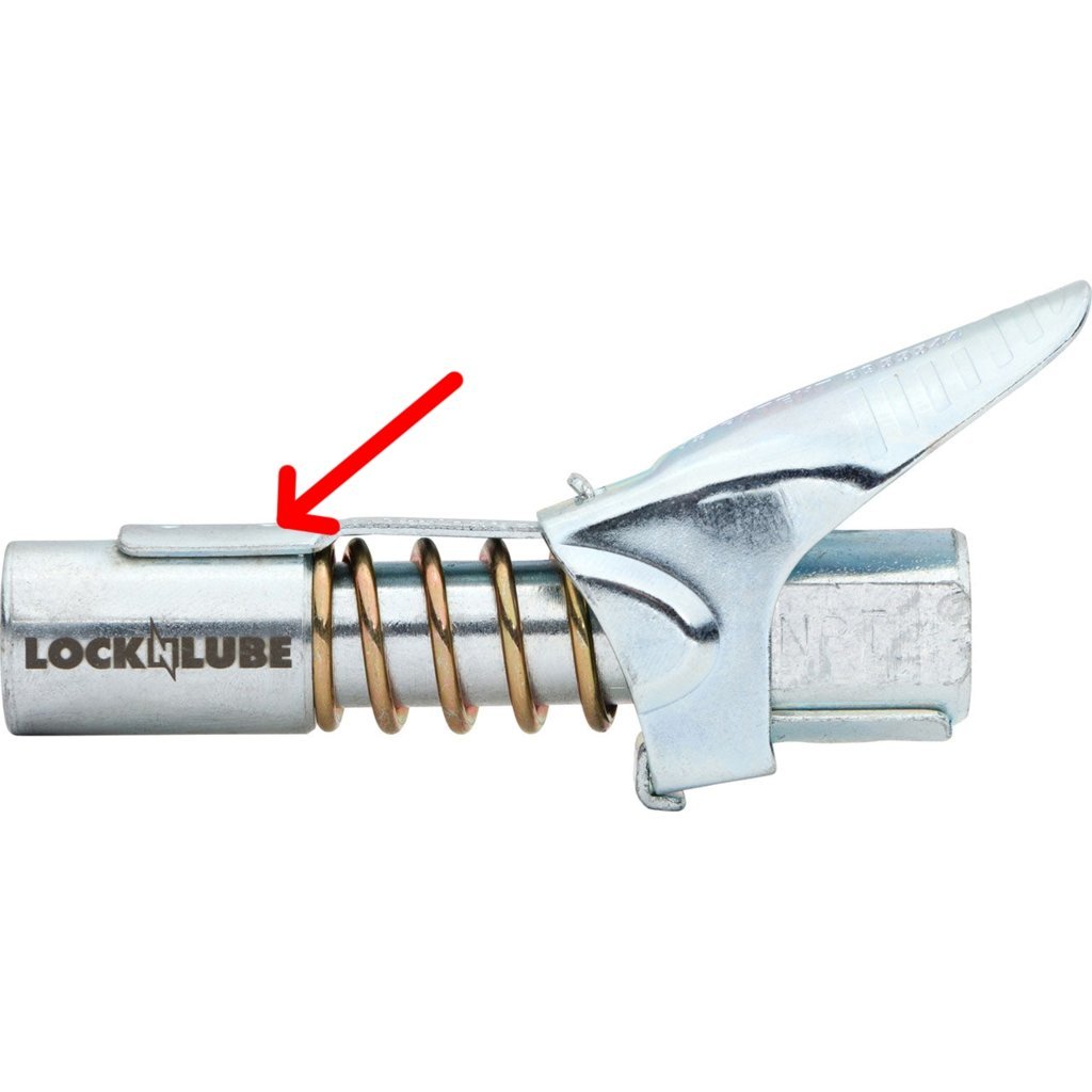

    I could not lock on one of the double cardan zerk fittings, maybe it was the middle one. I was able to get it partially on the zerk but couldn't lock on or get it to seat properly...so close though. The problem with that one is that the tolerance is so tight, that the thin plate on top of the coupler stopped forward movement dead in its tracks and would not permit the coupler to move further into the recess to seat onto the zerk. Trust me I tried. Ain't happening and isn't operator error, although so close.
    This is the top plate that catches in the recess preventing forward movement.
    One possible workaround is to use the XL coupler instead since the top plate is much further removed from the barrel end as pictured below, assuming the barrels are the same diameter, only the XL is longer. Otherwise, like you, I am looking for a different coupler that will work with the LNL252 grease gun that I bought along with the standard coupler.
    I asked @JakeJake which LNL he was using (Standard) when he reported success on all 8 zerks in the first attempt. His is a different model year though. Seems like another guy with either an 03 or 04 also reported success but with the XL instead. The only thing that kept me from fully seating and locking onto the one double cardan was the top plate in the 1st pic. I could get it to the top of the zerk but not close enough to seat even on the best line of sight approach.
    Anyone out there have success with the Lock n Lube XL coupler on all 8 zerks on the 2004 Tundra AC? Any suggestions as to alternative couplers? Otherwise, I really like the LNL 252 Premium Pistol-Grip grease gun in yellow. It's very easy to operate and smooth with fast, almost effortless priming on new cartridges.

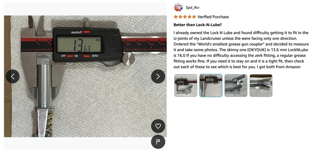

    No experience with locknlube anything, only the cheapest grease guns for me. The only way I was able to get my coupler to reach and lock on was to buy a rigid coupler line (as in straight, solid, steel/alum tube instead of flexy hose style), spin the front shaft into proper position so the zerk is facing outboard/downish, and press that fucker onto the zerk really hard even when it seemed that the drive shaft space was slightly too narrow. That locked the coupler tip on properly with zero wiggle room and maintained pressure as I pumped in grease praying that it would actually enter the zerk. Even my dremel modified coupler tip attached to wiggly hose would just squish grease outside of the zerk

    Thank you for this description. This is my experience exactly. I'm glad someone else is having the trouble I'm having greasing those zerks. Frustrating to hear others having no issues. However I think I had two zerks I couldn't get the coupler to seat on at the double cardan joint. Still no luck for me with the front driveshaft either. There isn't enough space around the zerk to get the coupler to seat down on it. I can't tell you how much new grease I've wiped away at the zerk trying yet again, thinking I finally have it seated. I also tried a different grease gun prior, still with no luck. I agree with you. The LnL grease gun is the nicest one I've tried. Worked so well priming it.
    If anyone has had any luck greasing all of the zerks on a 2004 AC, would love to hear what you used to do it.
    I also think one of the zerks at the double cardan joint has the ball joint permanently depressed on mine. Can you just unscrew it and replace with a new one?
