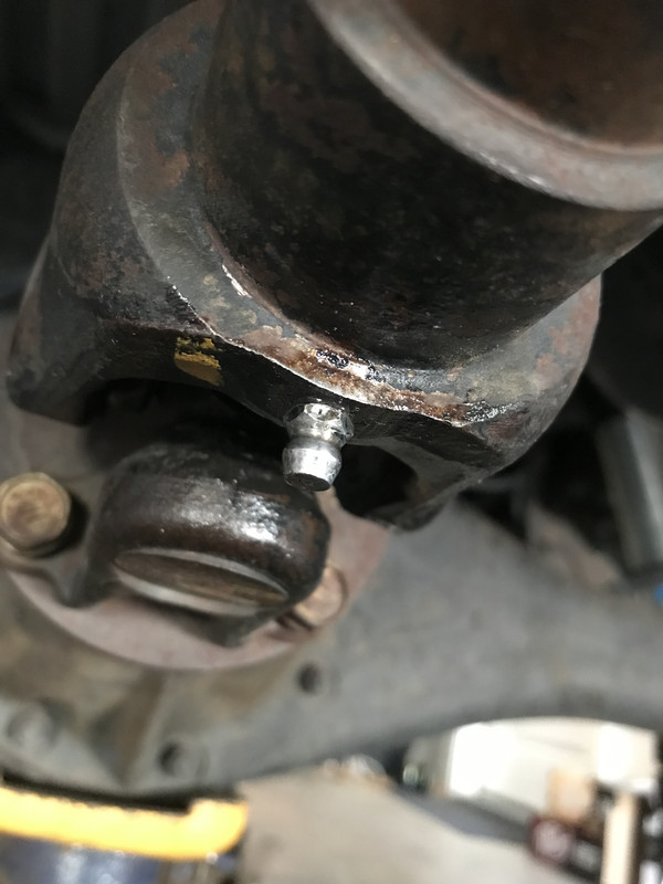

    Confirm the check valve on the zerk fitting can be depressed. Use the corner of a small screw driver to press the ball in. If grease is entering, depressing the ball should allow a minute amount to come back out as it will be under pressure if there is a blockage. If they’ve never been done before and the oil has completely leached out of the thickener it is possible to have a blockage. This in my experience is very rare.
    Another thing you can try is once the gun tip is latched onto the fitting, tighten the tip of the gun with a small channel lock. This will help hold the fingers on the zerk. You may need to loosen in the same manner to get the tip back off the zerk.

    So I gave it another shot, no dice. Here is what one looks like:
    Cleaned fitting
    Grease coupler attached securely and holding on by itself:
    After a gentle pump of grease, it goes everywhere but in:
    At this point, I’m thinking it could be my grease whip fitting. It’s brand new but I tried to use it to grease my JBA UCA and it did the same thing. I’m going to get a new coupler tomorrow and if not, stopping by harbor freight to get some replacement zerks.

    1/2 of my zerks are done. I'm unable to pump grease into the ones requiring a needle nose adapter.
    I may try the grind down mod to the normal size fitting to see if it makes a difference. Need to borrow an angle grinder for that to happen.

    SouthPaw - if it makes you feel better, I also have a fitting that will not take grease. The zerk is clean, the little ball moves freely, and I've tried using the normal grease-gun adapter, the neelde nose adapter, and a special, thin, long-nose adapter. Nothing works. And the zerk on this u-joint (transfer case side of the front driveshaft) is not removable. I wonder if the grease in the joint has hardened. Otherwise, I can't figure out the problem.

    If you struggle to get grease in the fitting (Splurts out the side) you can use one of these. I use one for the section that goes to the front wheels which is a pain to grease. Simply depress the little ball with the tip of the needle and pump away.
