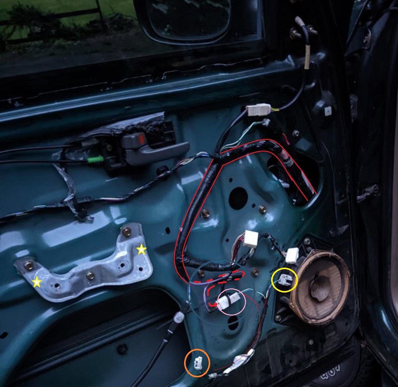

    I'm ready to do the install today but I can't for the life of me find out online which audio channel the door tweeters use. Do they use the rear channel if it's a single cab? I genuinely can't find this information and I don't want to damage the door speakers or tweeters

    Door speaker circuit is off the front channel. It starts as two wires in the dash, once it passes into the door, it hits a special Y connector that forks the connection (with some added electronics, wired inline) out with 2 wires to the tweeter, two to the midbass.

    '06 AC Limited V8/4WD
    Oh and this is what it looks like behind the door panel, for AC/RC trucks with tweeter.
    Main bundle comes in (red pipeline here). The two wires for front door speakers fork out of main bundle (red dashed line).
    From there, it goes attached to the splitter harness (pink circled connection), and from there that harness forks out to the woofer connector (yellow circle) and the tweeter connector (orange circle). Crutchfield makes plug-and-play adapters that'll let you plug into the orange circle and yellow circle connectors, they're like $2-3/ea or something, they usually ship them free with any stereo/speaker purchase, I believe.

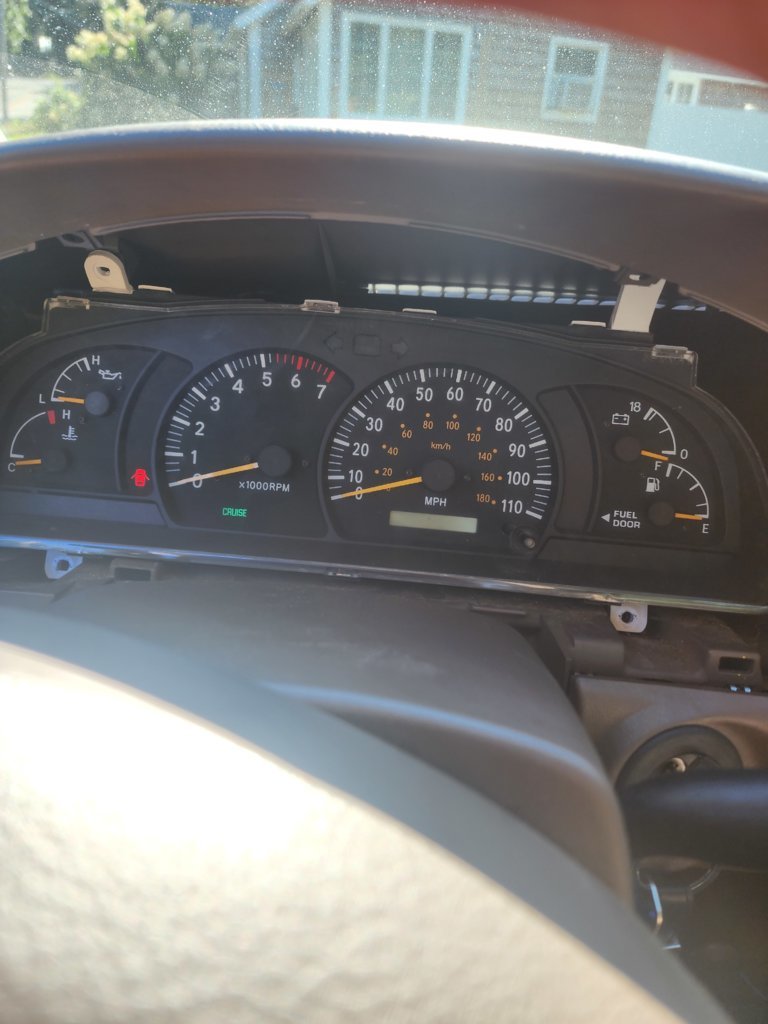

    #99

    No, that's why I bought one with a tach

    Gonna need to crack open the EWD and figure what wire you're missing, and where it connects to, so you can add that wire.

    Damn ok that sounds like a lot of work for a tach

    Lot of work for a tach, attack it if you're attached to the idea. You may Google around and see if someone else has been here. I can only imagine they have been.

    Bruh after putting the old cluster back in now none of the interior lights work except the clock, head unit, and check engine light. The interior ceiling light didn't work anyways. What the hell could I have messed up

    Check the Dome fuse.
    Your tach issue may have something to do with your truck being an 04 and the cluster being an 02. Probably want a 03 or 04 cluster but without checking wiring diagrams and plugs and such you'd probably be on your own. There haven't been that many people to do the cluster swap.
