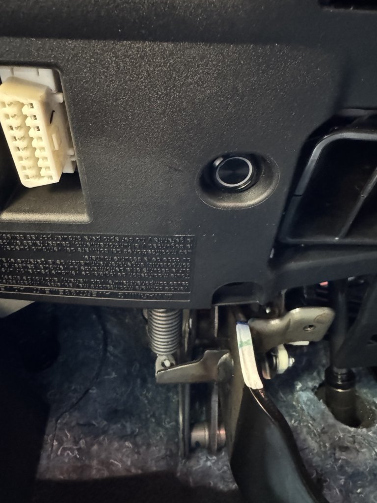

    I did the same as rockwarrior but I swapped out the switch to a round one
