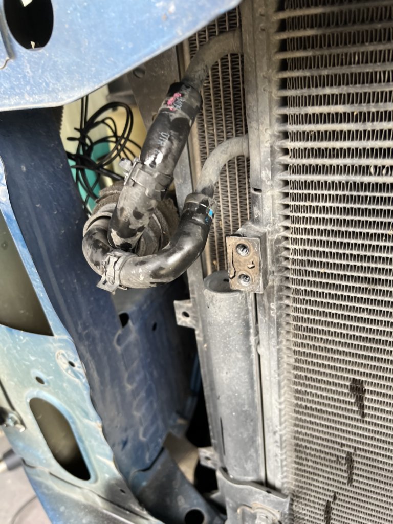

    Do you, of course. I narrowed my EXT temp spikes on long boosted runs while towing came from those lines. Jesse removed and ran the rubber lines like he did in his shop mule, but I haven't had a chance to tow with it yet to confirm it resolved everything.
    I don't know enough about the puck, but I'm debating doing a bypass at each end. Engine bay and closing the puck loop to itself as well. I am not opposed to keeping the thermostat functioning (183*), but I don't also need the pick countering it (196*+).
    I'm only sharing because you have access to those lines now, so relocating/rerouting vs bypassing the puck completely is sort of the same effort and may yield the same results.
    If you are open to bypassing the thermostat, too, either @Mdl or @blenton (I believe it was one of them) did so using LC elbow attachments. I'm not there just yet, but I won't be forgetting it's an option. Opens a lot of space down at the crossover collector, too.

    Thermostat is fine but eliminating the puck hoses frees up space which is nice. Do you know if the hoses are 1/2” or 5/8”?

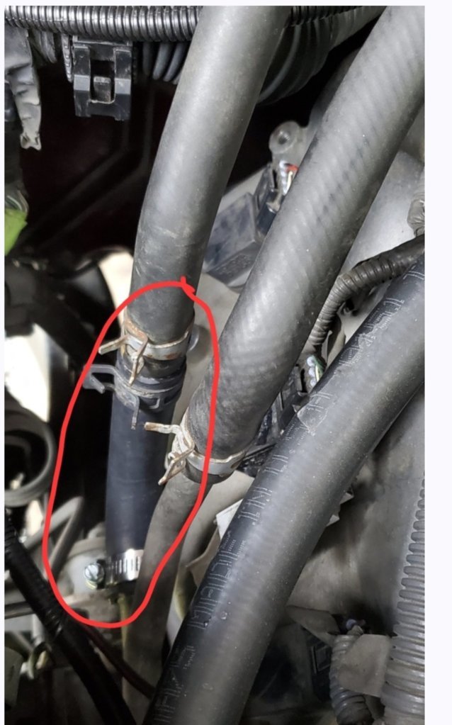

    It's 5/8 hose. I ran with the coolant lines off and bypassed the puck. I capped the pucks inlet outlet lines. Removed the hard lines. Then went straight elbows to cooler.

    I am interested in doing this mod. Do you have a link for the elbows? Any issue or leak so far?

    Got the elbow and feedback info from one of your posts :
    Thanks

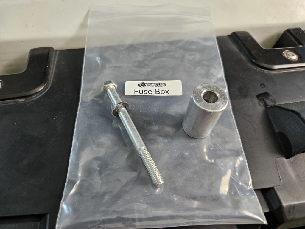

  10. Feb 6, 2025 at 6:25 PM
    #1690
    centex
    centex New Member
    Nov 27, 2022
    #87464
    2,229

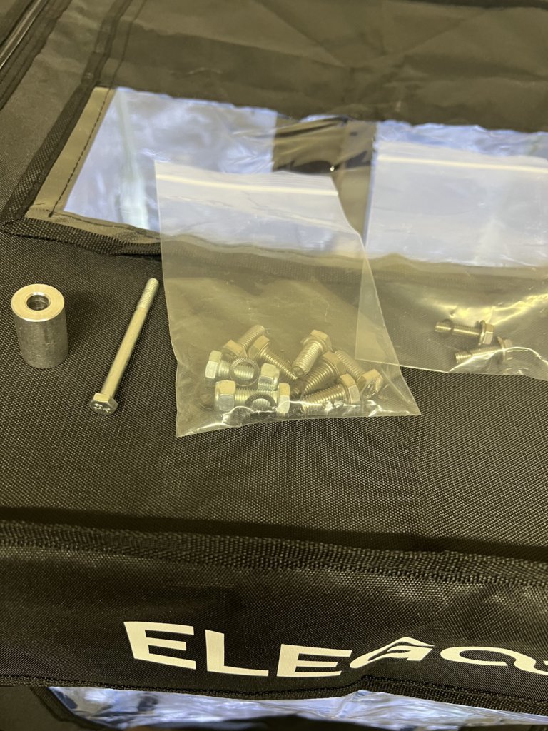

    What are these parts for? I can’t find a reference to them in the instruction manual.
  11. Feb 6, 2025 at 6:28 PM
    #1691
    Jego
    Jego New Member
    Jan 17, 2021
    #57757
    354
    Orlando
    PR
    2018 Tundra 1794
    First 2 from left to right are the fuse box spacer and bolt:
    This is how it looks when installed:
    The others ... :monocle: not there yet... @TurboKits / @bflooks ?
    bflooks[OP] likes this.
  12. Feb 6, 2025 at 6:33 PM
    #1692
    centex
    centex New Member
    Nov 27, 2022
    #87464
    2,229
    I knew it was a spacer but wasn’t sure for what. The bag wasn’t labeled. None of them are actually. @TurboKits might want to add that into the instructions or tell me I’m illiterate because I can’t see it in there.
    Jego likes this.
  13. Feb 6, 2025 at 6:41 PM
    #1693
    bflooks
    bflooks [OP] New Member
    May 9, 2020
    #46273
    2,296
    Metrowest MA
    Umm, based on the sizing and the tiny washers, I think the bag with qty 2 could be for the up pipe to the block (plate under the turbo)??
    The other bag I think could be FMIC hardware for brackets and intercooler mounting. Tell me if I'm wrong. I didn't have the Stage 1.5 shipped so I'm trying to remember what the hardware all looked like while we were installing
  14. Feb 6, 2025 at 6:42 PM
    #1694
    centex
    centex New Member
    Nov 27, 2022
    #87464
    2,229
    Ah yes. That makes sense now. Thank you all.

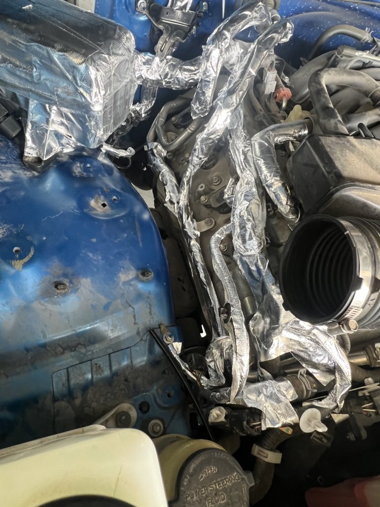

  16. Feb 7, 2025 at 10:34 AM
    #1696
    centex
    centex New Member
    Nov 27, 2022
    #87464
    2,229

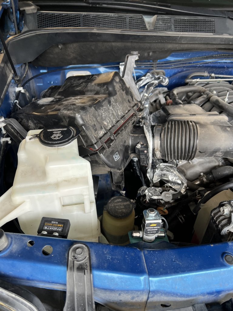

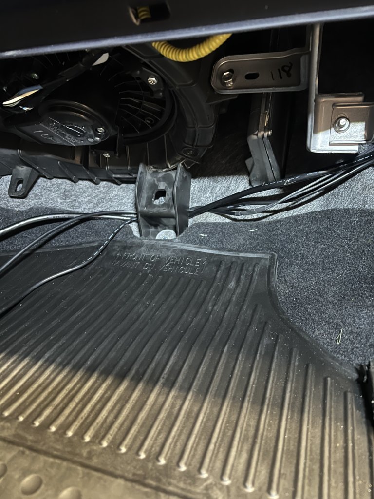

    Not much for today. Put some more heat tape on. Mounted my relay box. Pulled the map, boost solenoid, and o2 extension cable into the cab. Going to run out soon and get some fuse taps and hose barb to eliminate the puck and clean that up. Get the up and down pipes wrapped and the crossover pipe. Then that’ll be it until Sunday when I tackle the intercooler.
    M3Tundra-JK, Jego and AZTundra like this.

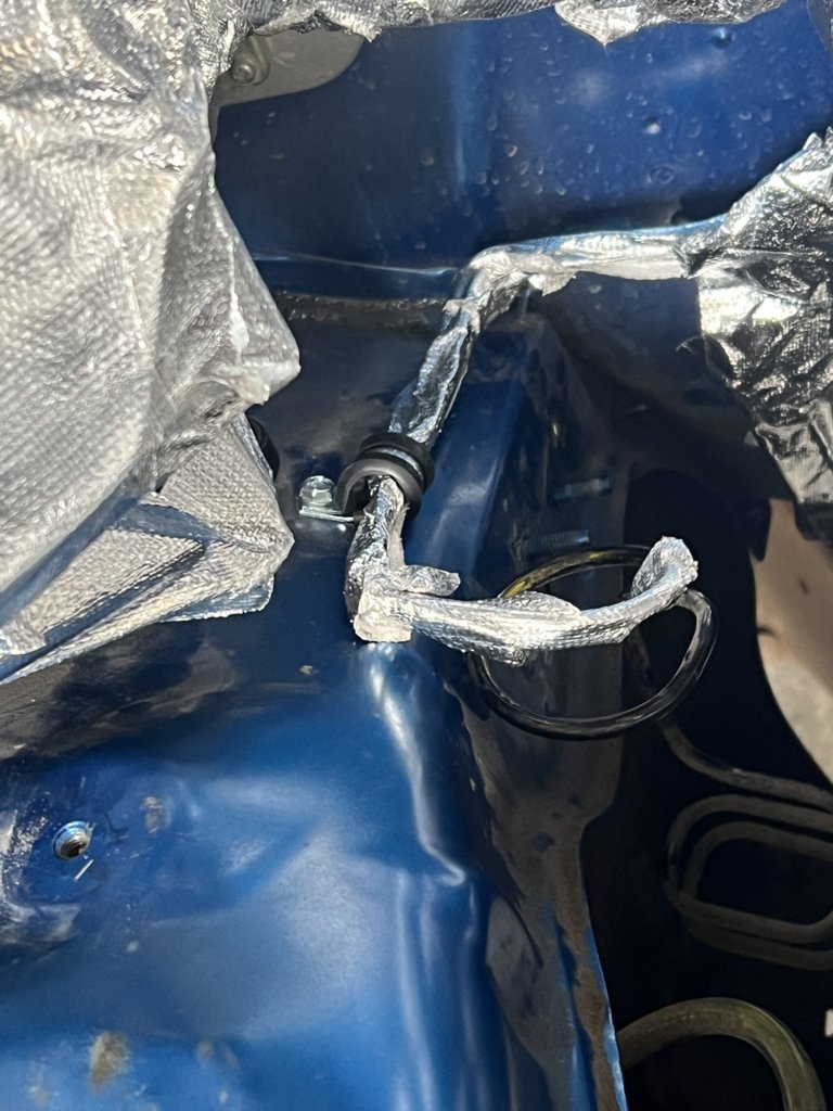

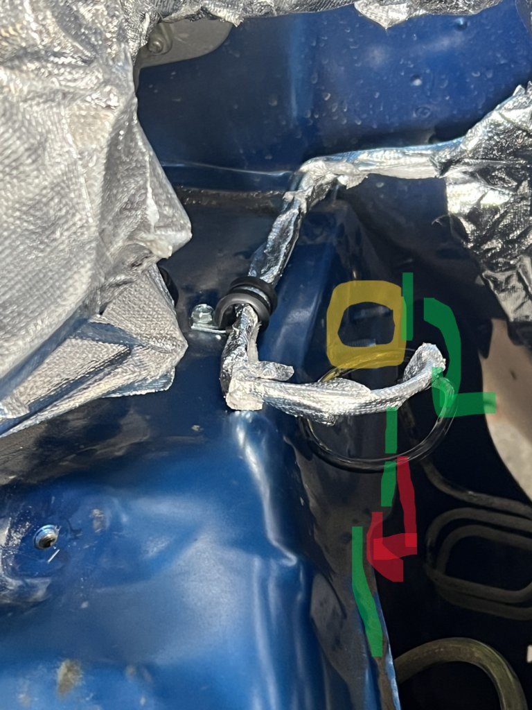

    Yup. Really like the idea of utilizing that other footwell for things. Driver's side is absolutely stuffed on mine. Good call!
    Easy, low stress, little time projects before you forget them -
    Yellow: grind/cut off the 2 studs on the inner fender that the brake line bracket used.
    Green: bend down the lip so it is vertical. Easiest from the outside and I used an adjustable wrench with smooth jaws.
    Red: You'll see what I mean when you fit the pipes, but that brake line loop will need to bend down so it is more flat. Absolutely save that for the dry fit.
    Keep up the quick progress!

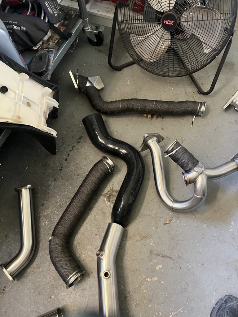

    Yup haven’t done the brake line stuff yet. Got the pipes wrapped just now. Can’t find my stainless zip tie tool so before I trim the excess I’ll order one and make sure they are good and tight.

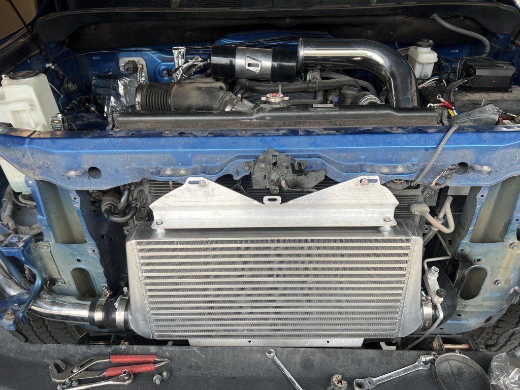

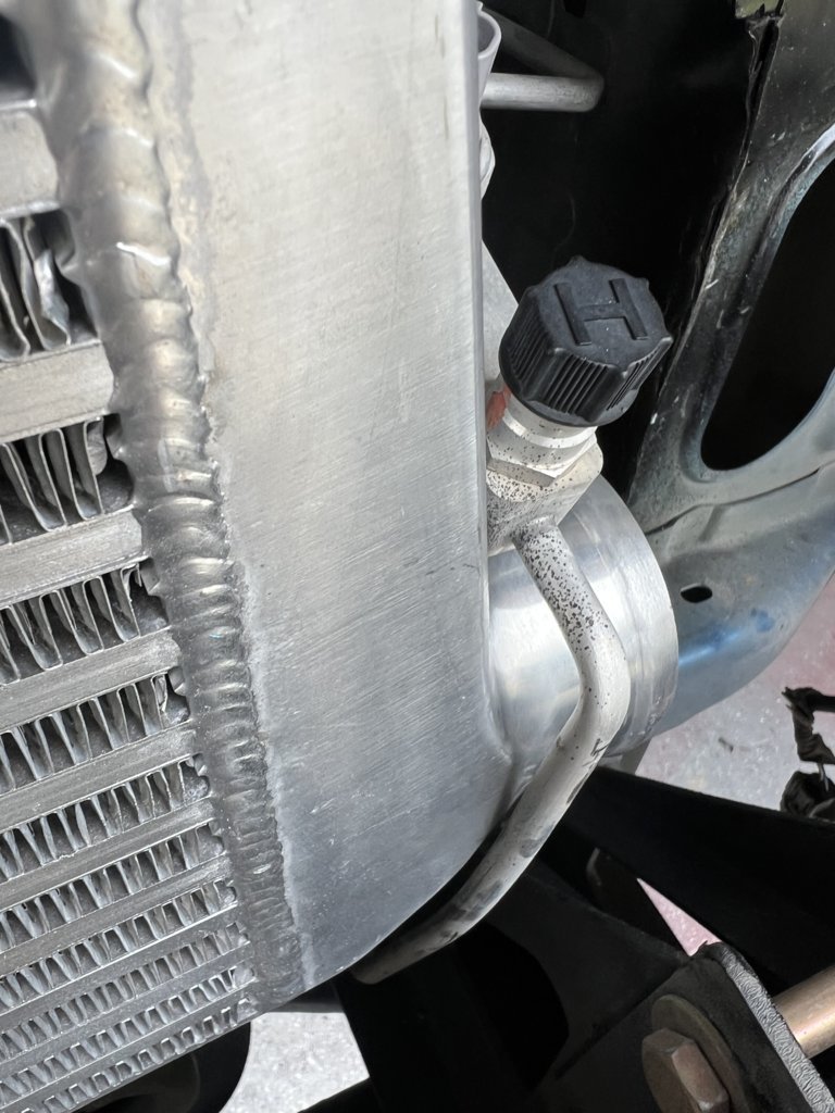

    At least there is space to fit the intercooler but the bracket and pipes must be modified for sure. :(

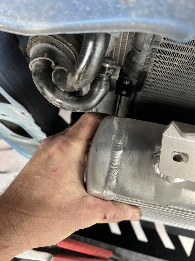

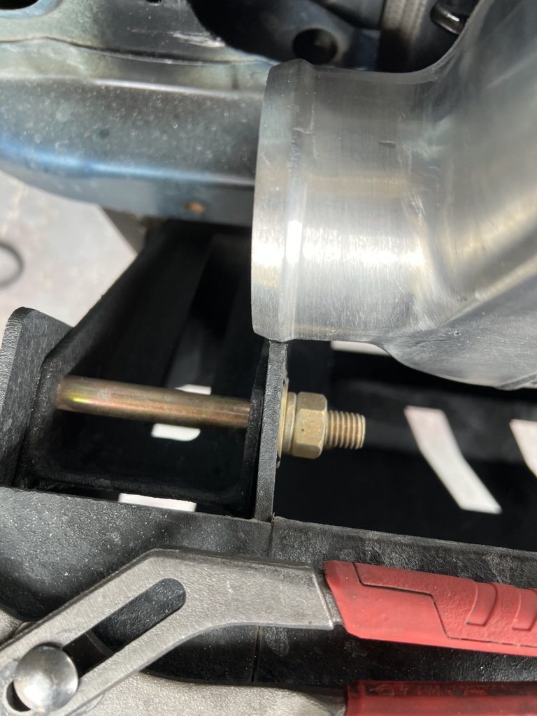

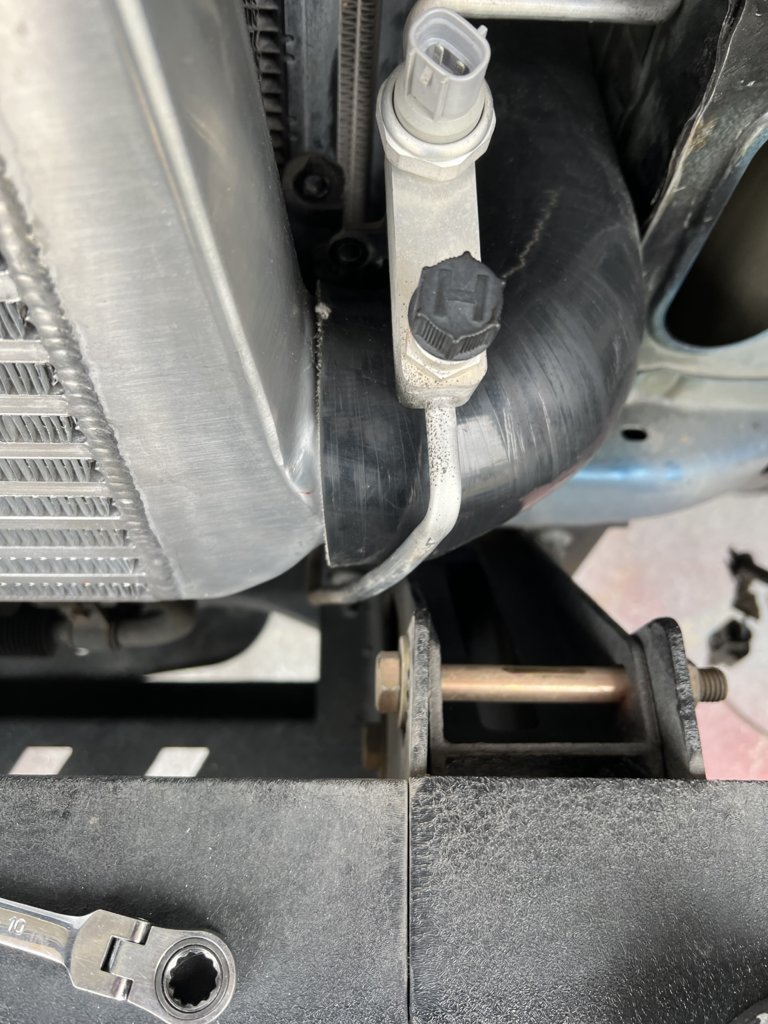

  21. Feb 9, 2025 at 10:12 AM
    #1701
    centex
    centex New Member
    Nov 27, 2022
    #87464
    2,229
    Fixed it. This should be mentioned in the instructions.
    M3Tundra-JK likes this.

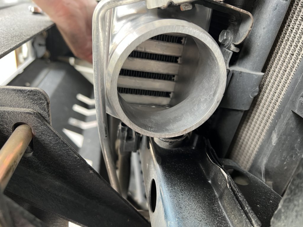

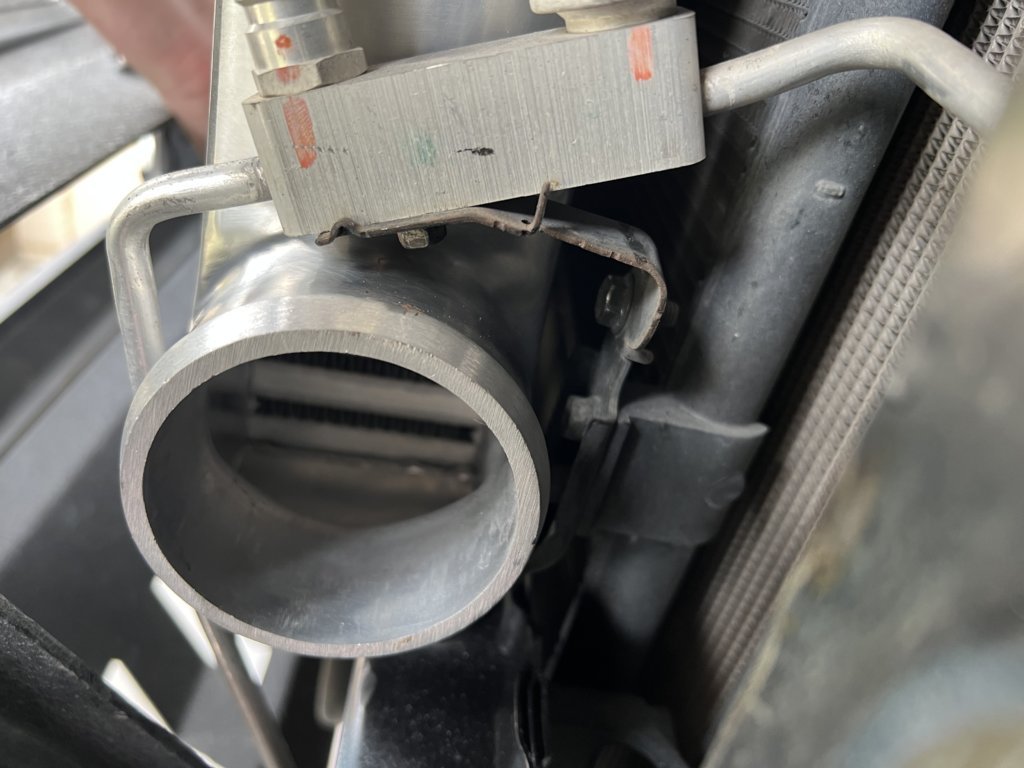

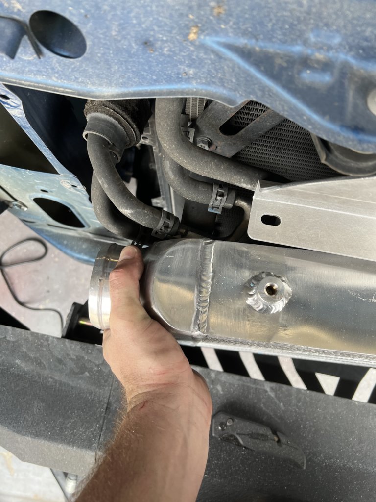

    This whole intercooler situation is nothing but one giant pain in the ass. I’ve got a bunch of notes and pictures to send to Jesse to help the instructions.

    The instructions down play the fight on this hose. I’m glad I cut out a bunch more than what the instructions said to cut out in the support. It’s TIGHT.

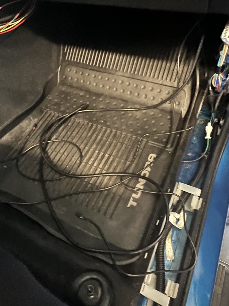

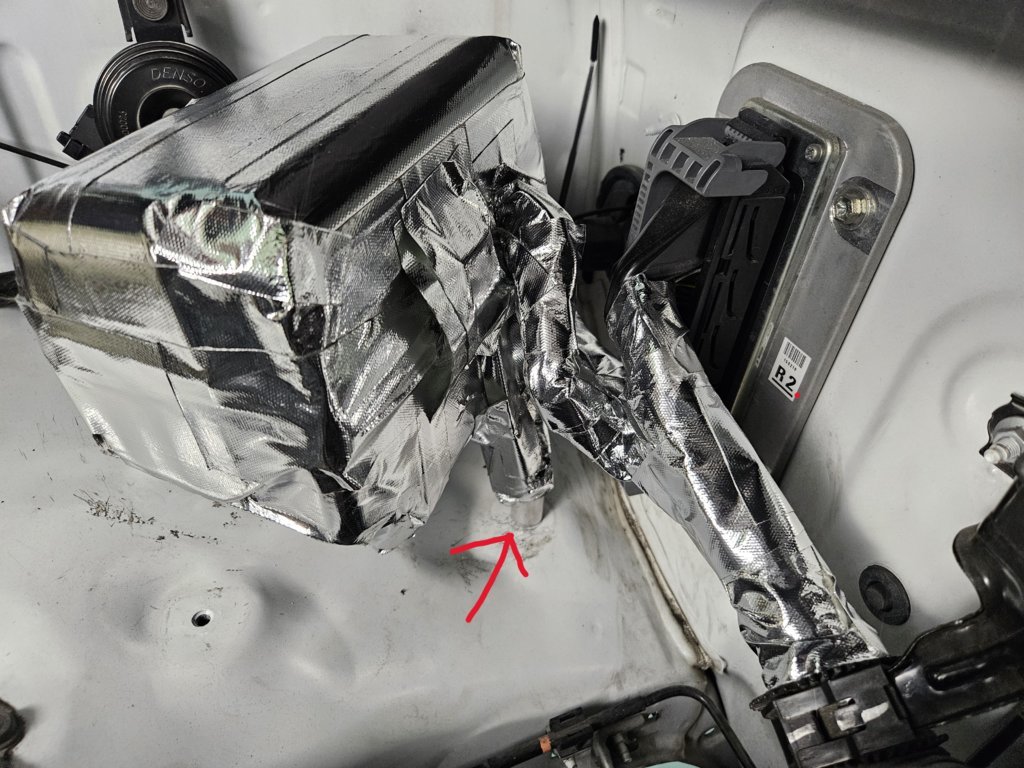

    I use the passenger side saves on length of wire too. I've also just said eff it and just drill through firewall install a grommet and run what I need. But whatever works as my ride is an 07...

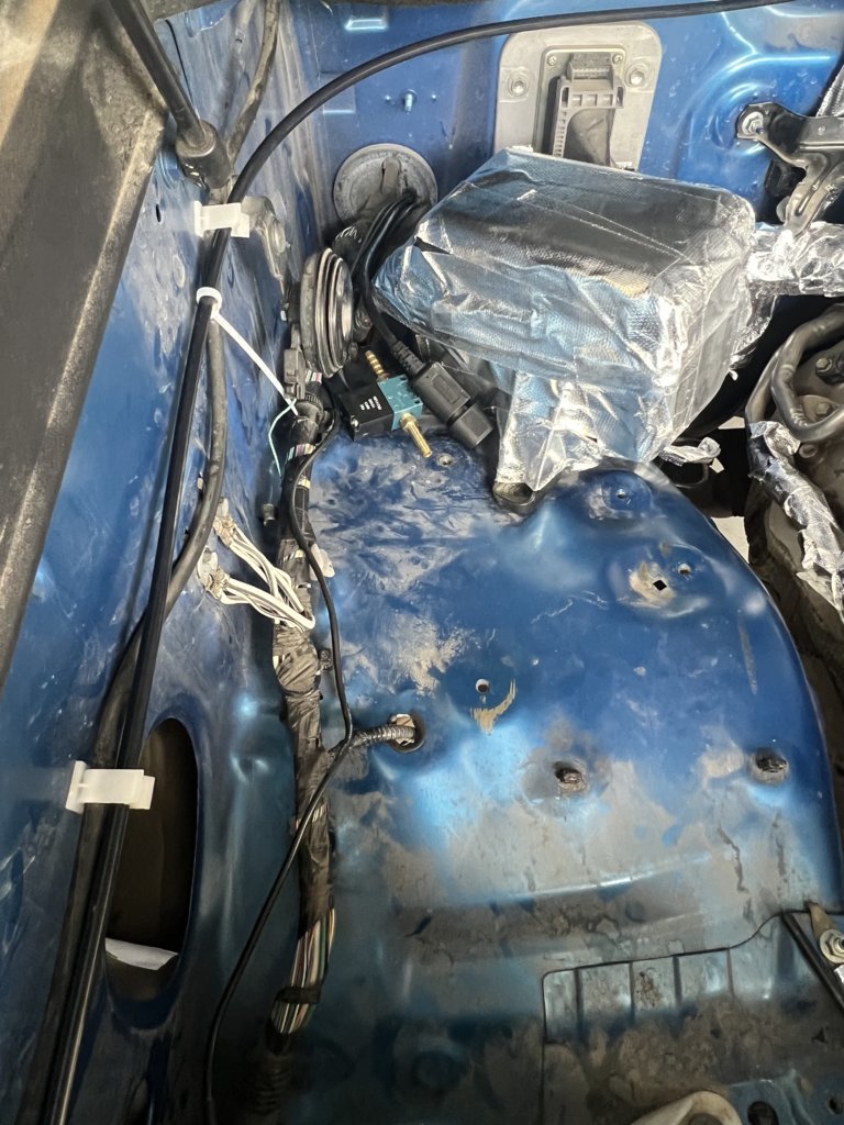

    I made the decision today to redo the meth stuff and run it all down the passenger side just to clean up the runs.

    Everything about this was a pain in the ass but it’s done. 6 straight hours. But it’s in and done and plumbed. Gotta get cleaned up for the sports ball game party we got invited to and then I’m out of town until Sunday so it’ll be a while before I throw all the pictures up with notes.
