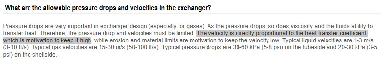

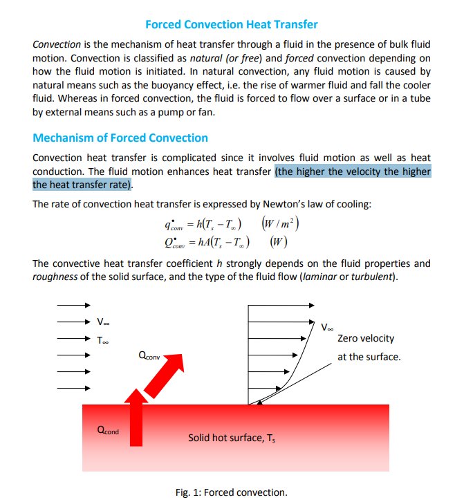

  4. May 29, 2025 at 11:49 AM
    armyoffoo
    armyoffoo Member
    Jun 4, 2018
    #15876
    1,482
    Cypress, TX
    2018 Black TRD Sport CrewMax
    Supercharged with all the trimmings
    More information on heat transfer related to liquid movement, this time from outside of the automotive performance industry. It gives me the brain pain...but if I'm interpreting it correctly, higher liquid velocity and more surface area that the liquid comes into contact with, results in a higher transfer of heat from the liquid to the contact surface. So in our world, higher pump speed + larger heat exchanger + higher fan speed + reducing restrictions (such as bends or small hoses) = colder IATs.
    Most articles I've read refer to Newton's Law of Cooling as reference.
    https://www.sfu.ca/~mbahrami/ENSC 388/Notes/Forced Convection.pdf
    https://www.torq-n-seal.com/why-does-fluid-velocity-matter-in-heat-exchangers/
    https://www.engineeringtoolbox.com/convective-heat-transfer-d_430.html
    http://www.cheresources.com/content...iderations-for-shell-and-tube-heat-exchangers

    Mathmatically, I am in the lower percentile, luckily for me, I rarely need to do math in my head (oddly, I'm good with $ math) lol
    That said, it seems common sense, if you increase flow, amount of coolant & the size of the intercooler, temps will drop. Hence I have a big intercooler, the ZZP pump & a ginormous reservoir.
    My IATs are pretty low.

    Aren’t you reading IATS at the MAF pre supercharger? I don’t think more flow can be bad in an intercooler circuit, which actually is a real concern in other applications like commercial chillers. I’d just argue that a pump that is rated higher by quoting its GPM capability pumping into a bucket vs against the head pressure of a restrictive intercooler circuit isn’t actually providing more flow as shown in that testing shared. A bigger intercooler is definitely effective for increased heat transfer. A larger reservoir is beneficial since it will take longer to heat up the greater volume under boost. A pump that flows 10% more into a bucket, but likely 1% more when pumping through the intercooler circuit. Meh. I’d probably lean toward the OEM selected, well tested Bosch known for its longevity and service life.
    One thing that would actually likely boost the flow big time despite using the same 3/4” lines and intercooler would be installing 2 pumps in parallel. The flow is most limited by the Total dynamic head pressure (discharge pressure minus suction pressure) it is able to produce against the restrictive system. With 2 pumps in parallel they share the work load against the pressure. 2 parallel pumps would reduce system head against each pump, and the pumps are able to operate at a more efficient spot on their pump curve. It would probably allow both pumps to move 4GPM before hitting a wall on their pump curve instead of just one, multiplied by 2 pumps could result in a true 7-8 GPM intercooler system on 3/4” lines. 2 Bosch pumps in parallel would probably only draw 6 amps too.

    You could just oversize the pump a bit and use a VFD with speed modulation based off of differential pressure. You’ll save on energy too, and it will modulate to meet the demand of the flow of the system as control valves open and close.
    The concern in HVAC applications for slowing down the flow to achieve a specific delta T to satisfy the needs of a refrigeration circuit doesn’t really apply in the scenario of an intercooler pump though. In an intercooler there is no such thing as too much flow. There may be a smaller Delta T on the entering/leaving water with more GPM, but there will ultimately still be more heat transfer that will cool the whole circuit down faster.
    BTUH = GPM X 500 X Delta T.
    More GPM does mean a lower Delta T, but doesn’t necessarily mean lower BTU removal.

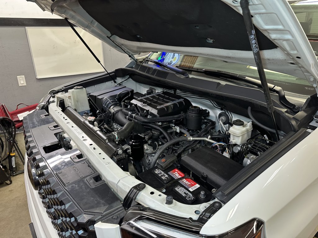

  21. May 30, 2025 at 9:18 AM
    bmw345
    bmw345 New Member
    Jan 24, 2022
    #73610
    341
    CT
    2018 Platinum Pro, Pro Fox's TRD Skid
    Very happy with the Maggie 2650. About 400 miles in so far. Loving it! Not sure how I ran 37’s without it! It’s my daily driver. If your on the fence do it! IMG_5770.jpg
  22. May 30, 2025 at 9:45 AM
    HulkSmurf14
    Aug 9, 2019
    #34377
    2,870
    2014 Tundra Limited
    Tastefully enhanced...
    Once you own a v8 truck with boost, you'll never not own one again! Congratulations!
  23. May 30, 2025 at 9:54 AM
    carn_dogg
    carn_dogg i don't think so
    Jan 10, 2022
    #72906
    630
    Pat
    Eastern Shore MD
    2013 Black Tundra Platinum
    Just wait til you get the smaller pulley, bigger injectors, better custom tune, and all the other peer pressure items from the forums. That blower is capable of so much more than the kit config and you’ll live every second of it
