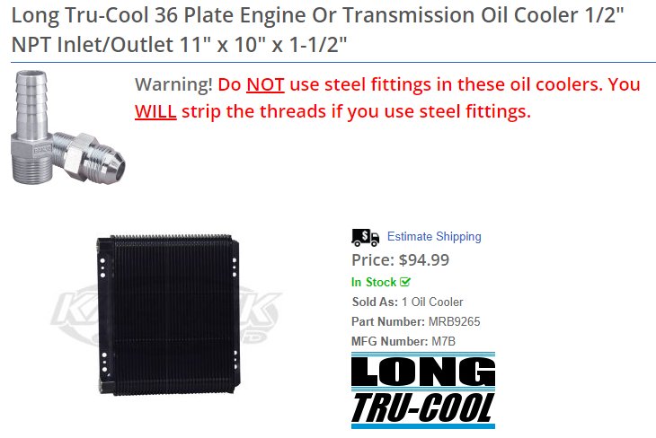

    For the transmission cooler I used a Tru-Cool 11x10x1.5 (per the customer's request) which was $94 from Kartek. There's some advantages to this cooler from a mounting perspective I'll get into later. But frankly, any old cooler will work and most coolers come with some zip tie mounting that lets you clamp it to the radiator if you want to do that. I've done that on my old trucks and they were fine.
    And then I used some 3/8" hose and grabbed some 90deg brass fittings.

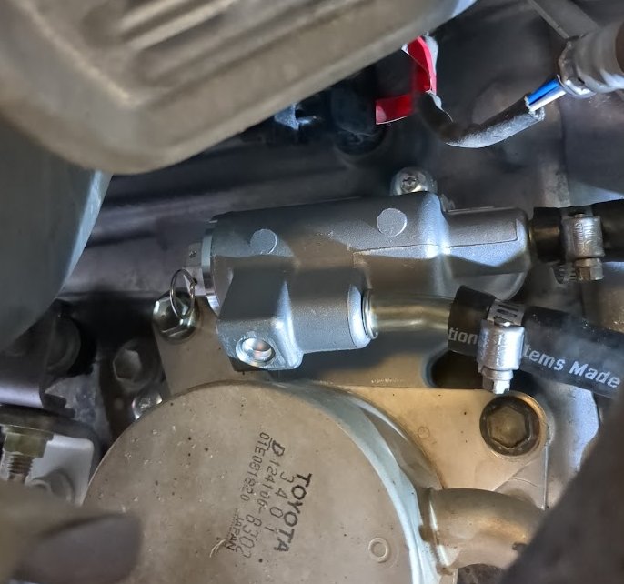

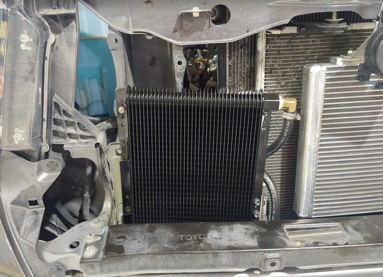

    Onto the installation. The 2021 (and presumably earlier years) have a brick that takes the place of the thermostat from earlier trucks. There are three bolts you undo that sandwich both the coolant heating puck and the brick to the side of the transmission. Undoing these bolts does NOT spill coolant, but ATF will come out (not sure how much, I already had the transmission drained). The new transmission thermostat is a direct replacement and uses O-rings (as does the original puck) so no messing with gaskets and stuff. Very easy and seamless swap out.
    Here's a picture of it installed and some hoses run to it, you can see the heating puck on the bottom. Anyone can swap this out in a couple minutes if you know how to use a ratchet.
    Moving on to the cooler. Once the grille is removed (kind of a pain in the ass, you can figure out how to do that elsewhere) I pulled the passenger side air duct panel and that opens up a lot of mounting options. Purely out of coincidence, the passenger side mounting holes on the cooler perfectly line up with the holes on the body. I did have to cut a slot to clear one bolt midway up that you can see (I just cut two lines and then folded that piece forward).
    On the driver's side, the bottom lines up pretty well with the bottom A/C condenser support bracket. I made a little bracket in a Z shape to tie into that, though there's a lot of ways you could go about that. Between the bottom mounts and a little support on the bottom driver's side, the whole cooler is sturdy enough I didn't bother mounting the top driver's side.
    As I said earlier, there's lots of mounting options and it's dependent on the cooler. This way is very robust and easy and nearly free.
    All in:
    $240 + $94 + $30 = ~$365 for the whole setup, and you could run a lot cheaper or more expensive cooler if you wanted.
    Trans temps after this were locked in at 190-200 while running a supercharger. I also left the thermostat pinned open, but that's a conversation for another thread.

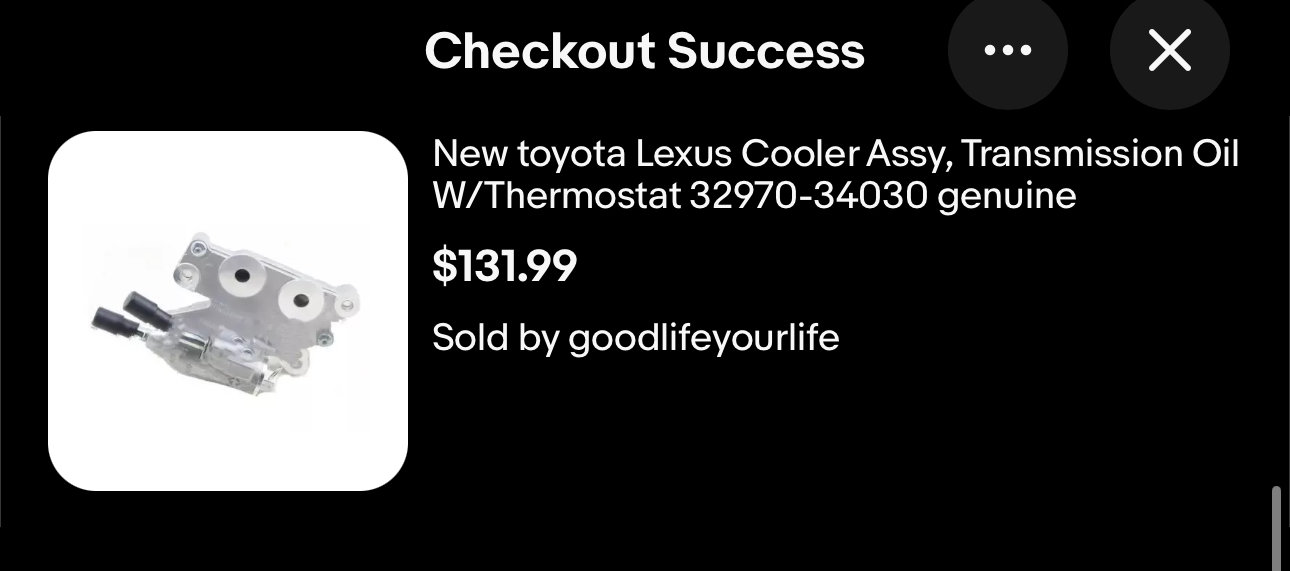

    Just purchased this for $132 on eBay.
    @snivilous If you don’t mind, could you shoot a few photos of how you ran the rubber lines on the bottom? Just want to get a visual. Or unless if it’s on your build page.
    Thanks!

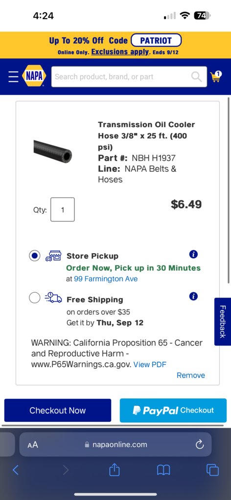

    @snivilous Are the Napa hoses sufficient? Or should I go with Gates?
  25. Sep 10, 2024 at 12:53 PM
    #25
    snivilous

    I checked to see how long it’ll be from the radiator to the thermostat and we’re sitting about 5-6’ total in length. I know you mentioned using <15ft of line.
    The Hayden cooler came with Gates hose, but unfortunately not long enough. I’ll probably just pick up 15ft from Napa this upcoming weekend.
    Now what I’m wondering is if Napa is actually selling 3/8x25ft for $6.49… or if this is a description error… :confused:
  27. Sep 10, 2024 at 1:27 PM
    #27
    snivilous
    snivilous [OP] snivspeedshop.com
    Apr 16, 2019
    #29192
    5,417
    SW UT
    300k+ Supercharged 2008
    Has to be per foot, hose is like gold.

    Yea this reminds me to buy some hose off Amazon, I went into napa the other day to buy 10ft of a bunch of sizes so at least I'd have spare laying around and ended up with a $150 bill!
