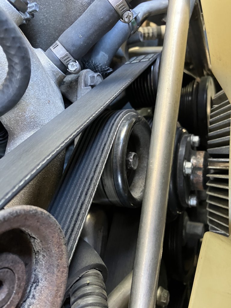

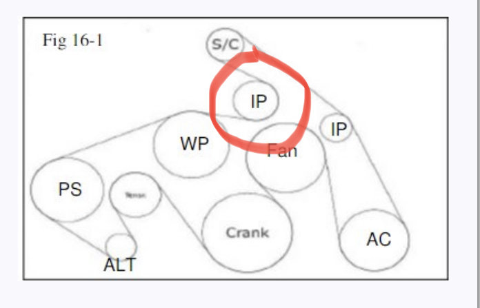

    Anyone have the Toyota part number for this idler? Trying to get rid of a dreaded belt squeak. I have a new tensioner and non-SC idler but having trouble locating this smooth, non ribbed idler pulley p/n.

    Would you be okay with a Dayco idler? I think that it's the part Toyota uses.
    https://www.rockauto.com/en/moreinfo.php?pk=961394&cc=1447102&pt=10346&jsn=930
    I like how in the image from this link, the part is all fucking dirty! :rofl:

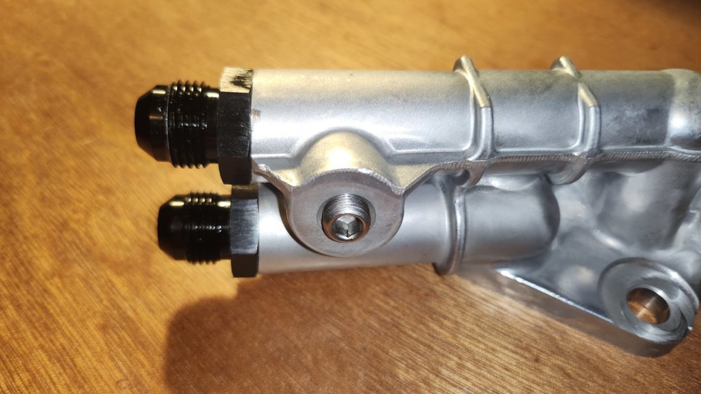

    I really wanted the fittings to sit more flush, so I went at it again with a file and got the result I was looking for. Now they thread down flush with the housing without the o-ring, and fit nice and snug with the o-ring, which seats nicely in the chamfer. I'm more confident in this holding, maybe next weekend I can make some lines and finally get this project completed...it's pouring rain now or I'd already be at it.

    That looks great. Will order up a non cooler bracket or try to find a parts yard one.

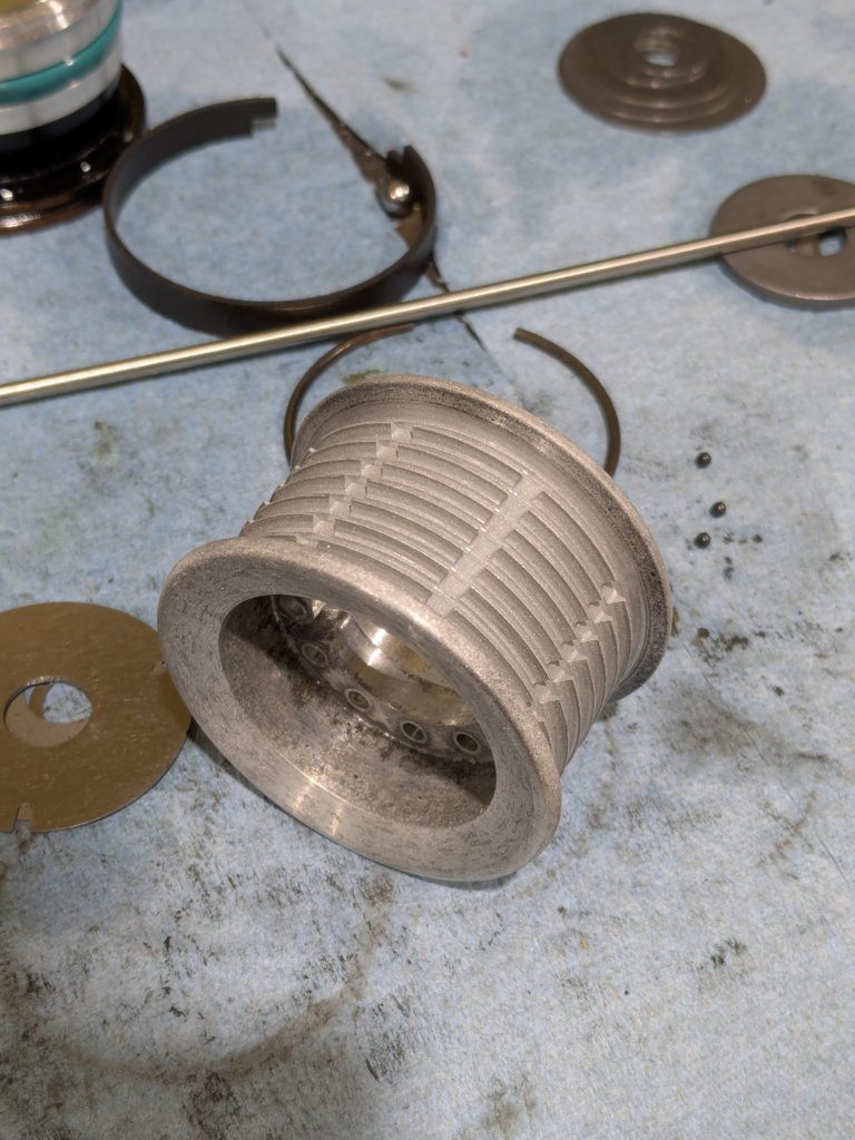

    Time for some experimentation and testing of belt slip on this OG pulley

    And it made no difference :rofl:

    Paired with the OG gatorback belts it does. This is old school cobra and lightning day stuff.

    That's assuming it was slipping to begin with though. Maybe @Mdl at sea level would see a difference.

    Yea exactly. We’d only see real slip in the upper rpm range you’d see it dyno graphs and boost slightly dipping. I don’t feel anyone of us are running small enough pullies yet to have this issues with the available belts out.

    I was trying to find a log where I saw a little dip from 13.9psi to 12.7psi. It happened before/during a shift from 3rd to 4th I believe around 5800-6000rpm.
