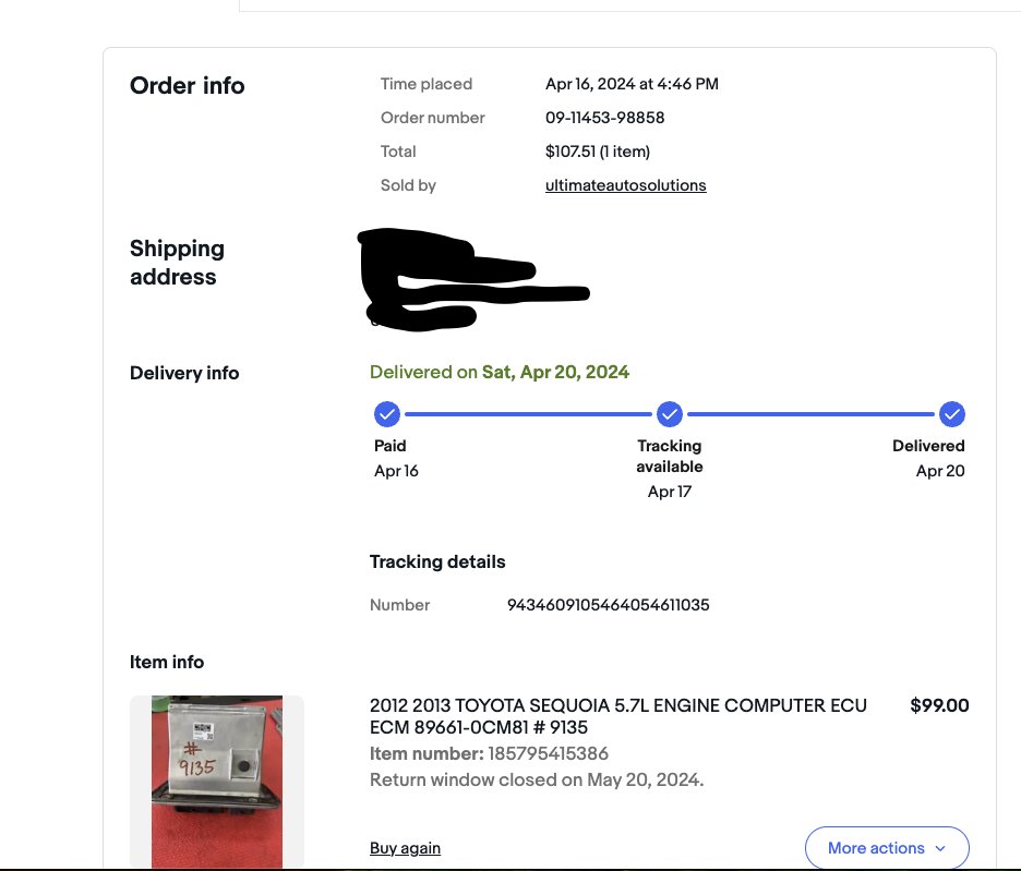

    After i read about a few bricked ecu's i've thought about keeping an eye out for a good deal on a spare.
    Any trick to make sure its compatable? Just match part numbers?

  2. Jan 4, 2025 at 8:34 AM
    helidave
    helidave Hellacopter
    Oct 3, 2018
    #20151
    1,432
    flagstaff
    2015 DC 4x4
    Magnuson 2650 w/76mm pulley, ADS suspension, 35's, misc overlanding bro-trophies
    get same part number thats on the cover of your stock ecu

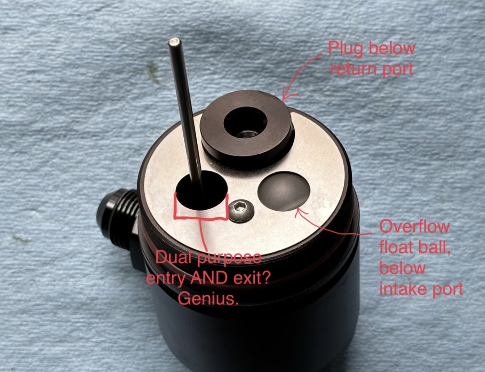

    ECU swap:
    Some time around 2014-2016 the ECUs increased in memory capacity and the calibration file sizes increased. So an ECU from a '13 might not work in a '17 and the inverse, for example. I don't know if anyone has had to try to cross that particular bridge or not to verify one way or the other though. Just a point of note.
    blenton likes this.

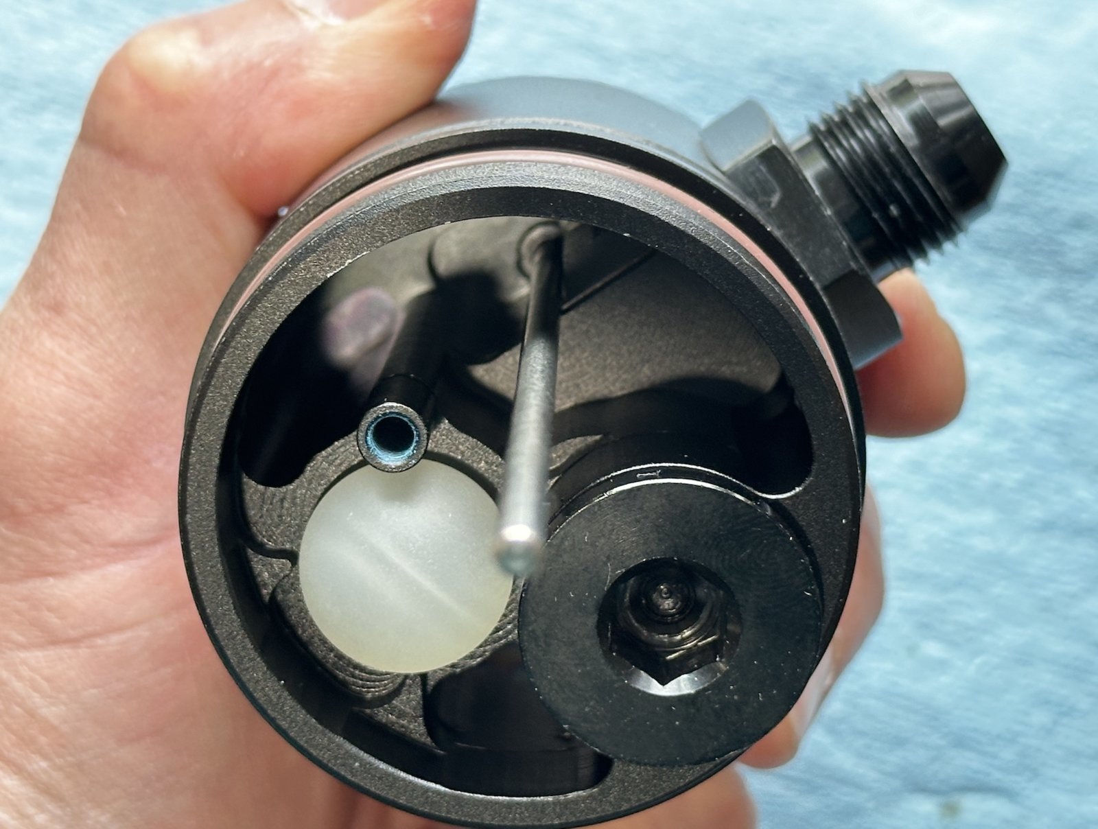

  17. Jan 4, 2025 at 2:10 PM

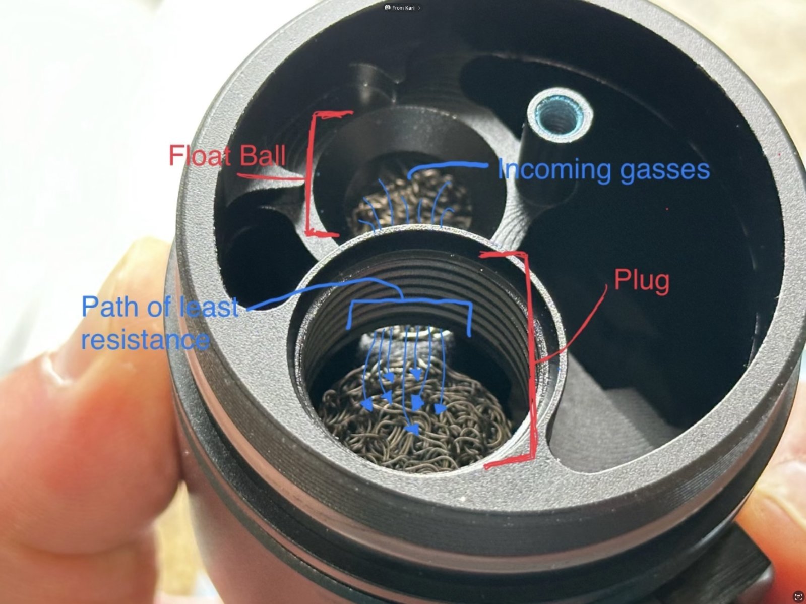

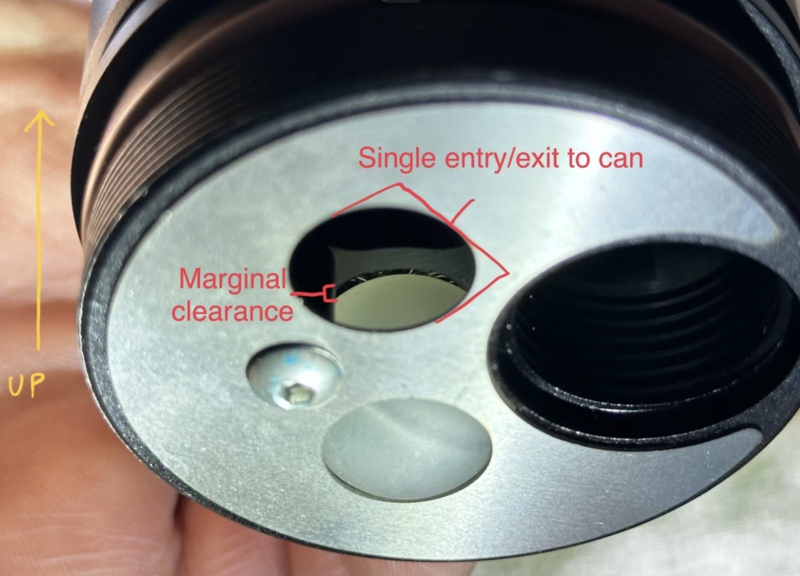

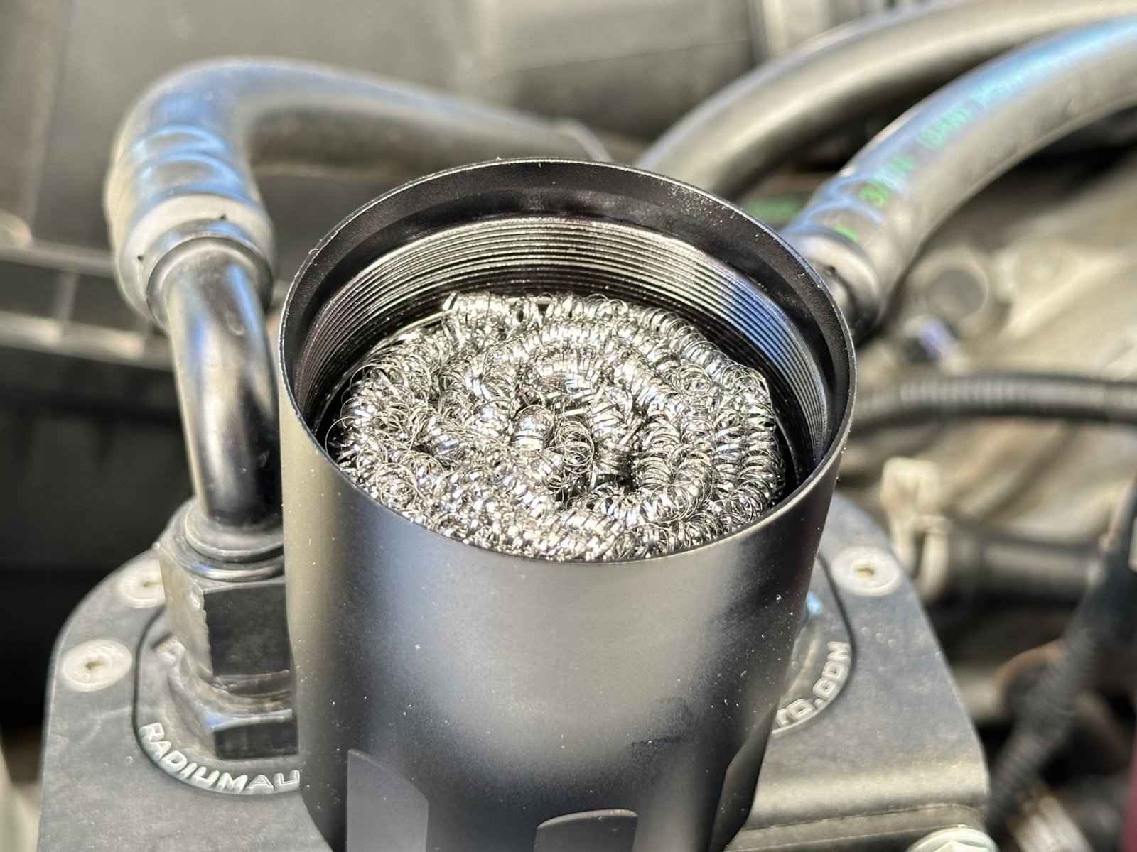

    I finally got similar results. Nothing in 3K after install, then pulled the check ball, another 2K and nothing. Replaced the PCV and finally got about 1/2 of what you did in 1,000 miles.
    I decided to put in more SS mesh but went one step further. I saw the crossover hole in the head of the Radium and trimmed/cut a piece of copper tube to block that passage, then filled the whole thing with SS mesh. Cooper piece is a 3/4" tube sweat coupling that's cut in half and slightly flared to increase OD. Cut a rough notch with snips so it would drop down. If this works like I think it will, I'll do actual measurements and build a drop in piece.
    Now the gas flow is forced out of the top cap into the catch body and then back into the cap, no chance for a short loop in the bypass hole.

    T'was me.
    @VWTim - What you did with your CC is a great idea. Mind sharing photos of the final iteration, all setup?
  27. Jan 4, 2025 at 4:09 PM
    VWTim
    VWTim Mid-Travel Crew
    Mar 1, 2021
    #59814
    817
    Corvallis, OR

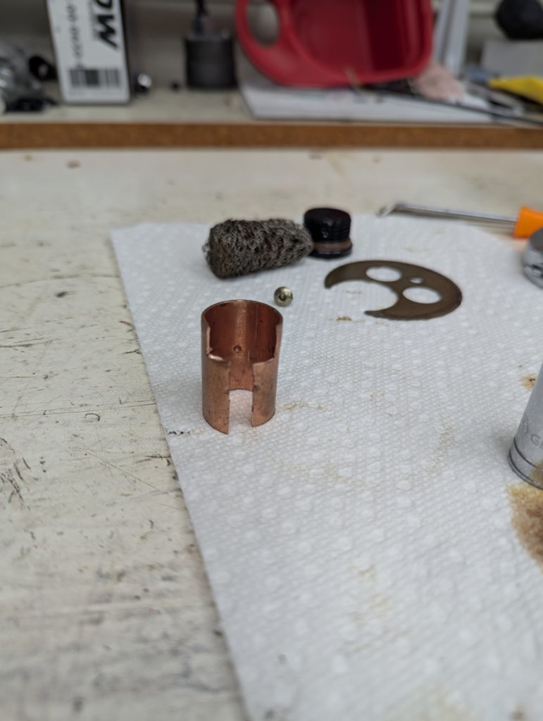

    Sorry, my hands were dirty and I didn't take any more.
    If you remove the top nipple that's inline with the check ball, you'll see down into where I placed the spacer. I put it in notch down, filled the tube/void with new SS mesh, and screwed the nipple back on.
    I pulled the other ports plug from the inside, but ended up putting the mesh and everything back together how it was from the factory.

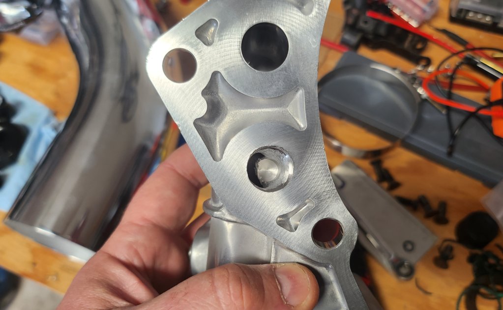

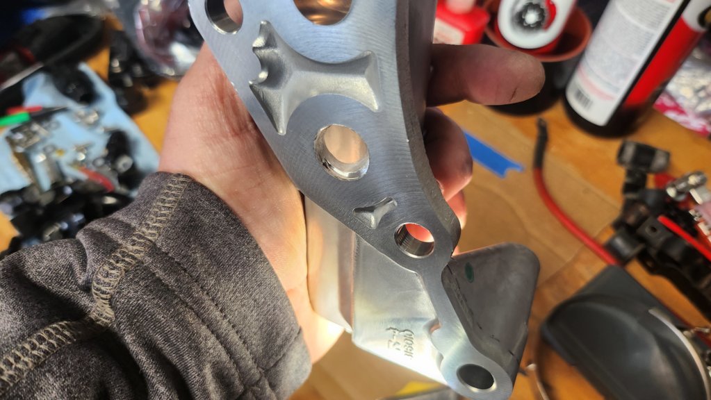

    I opened up the oil passage on my chopped up adapter. I couldn't drill it straight as the oil passage is off to the left and I would hit the outer wall of the passage if I drilled to far. I used a die grinder to enlarge the initial hole and carve more out of the passage opening for more flow. I can get my pinky up to the first knuckle into the top hole, and can do the same at an angle in the bottom hole, giggitty, so I'm calling it good. I also attempted to flatted the bottom of the passages perpendicular, but I didn't do a very good job. As a result, my tap wasn't exactly straight, but the fittings thread in and squish the o-ring into the chamfer, so I might test it to see if it's good enough and plan to make another. I consider this prototype a success, even though my result is sub-par. I need better tools, hand tools doesn't get the result I need.
