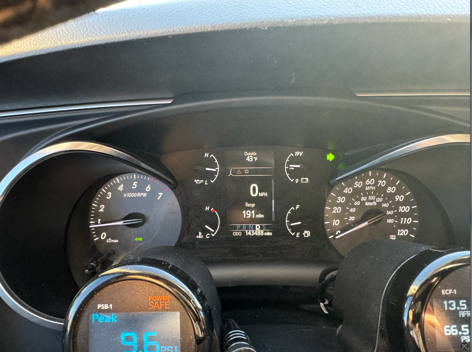

    Looking for an unobtanium 12mm thin wall deep 3/8 socket to get the BMW head off took these pics:
    43 ambient, after 5 start stops 154 trans, 174 coolant 69 intake.
    Northern discontinued it, offered a thick wall similar to one I have that can't get in there, the cams are hollow & I really don't want to touch them, they break easily.

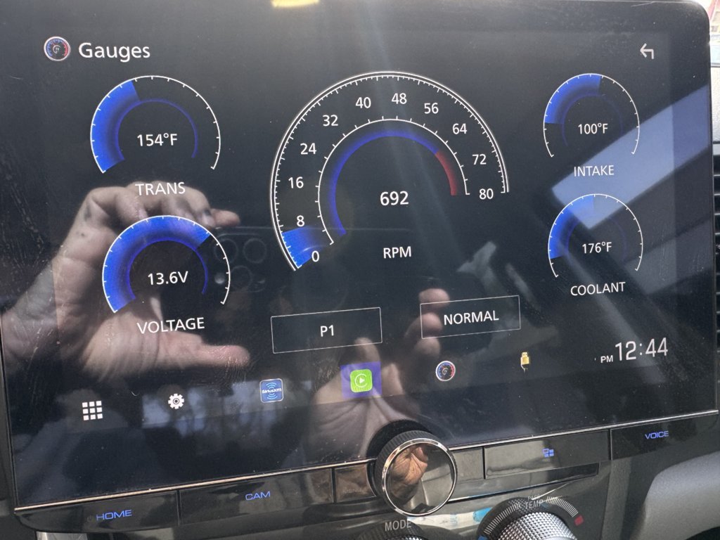

    What app are you using to display trans temp on HU? And which OBD device? Need this asap. My torque app on my unit won’t show me trans
  5. Dec 14, 2024 at 10:52 AM
    e30cabrio
    Oct 20, 2017
    #10410
    6,614
    West Valley, Phoenix, Az.
    Boosted 2013 Sequoia TRD FAUX
    It's a Kenwood HU running off a Maestro. It scans PIDS & displays 99% of the gauges, freaking TPMS keeps failing, it works for over a year then something happens & it's gone. I have a rear door open (when it's not) error driving me crazy so have disconnected the battery a few times & lost TPMS again :(

    I use wireless carplay but the Maestro does it's OBD2 thing independently of that (and Android auto)

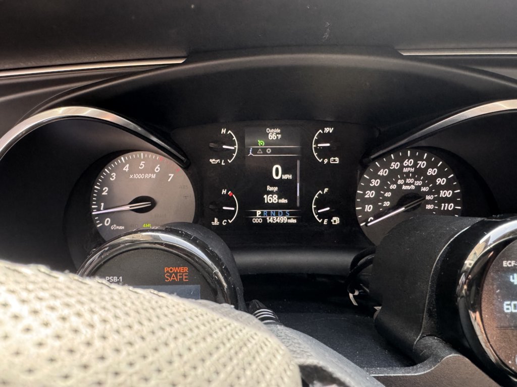

    Warmer, another trip.

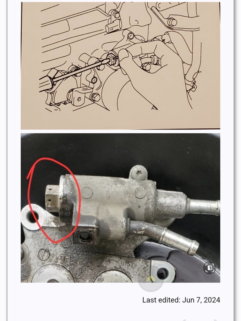

    The early 2nd gens were cursed with the stuck in 3rd shift with nannies off and the transfer case fork disengagement causing the truck to roll. It still amazes me Toyota never corrected it or someone got killed from it rolling free.

    yup when changing tranny fluid gotta pin it open
