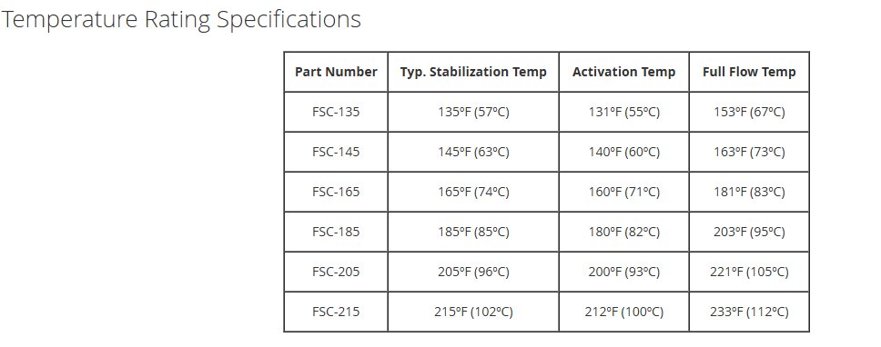

    Reviving this thread for a second. Anyone running the Improved Racing inline transmission coolers with direct feedback on how these trucks are responding to them? I'll take either unloaded or towing feedback and would like to know if you are using the 20gpm version or the 5gpm.
    If I go with the Improved Racing and no the Mishimoto, I'm a bit torn on where to go with it... The 145* option I believe to be simply too cool, the 185* being potentially better than stock based on their stabilization temp values, and then the real contender being the 165*. If these trucks do tend to stabilize at the rated 165*, then I might be more inclined to go with the 185. But if these trucks tend to run closer to the full open temp of 181*, then that's a different story. I think this circles back to the question about transmission pump rates.
    Link:
    20GPM: https://www.improvedracing.com/high-flow-engine-transmission-oil-cooler-thermostat.html
    5GPM: https://www.improvedracing.com/compact-high-flow-engine-transmission-oil-cooler-thermostat.html
    Table (appear to be the same):

    I was looking at the fsc in 145 or 165 degree thermostat. You can always change the thermostat pill up or down. I'm not 100% sure on flow rate. But lines are only -6, 3/8, and not -10, 5/8, so flow rate shouldn't be that high. When I get my new pan I'll try and do a flow rate when I do drain and fill.

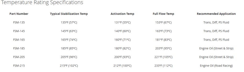

    Observation: A slightly different assignment for their temp ranges across these tables
    FSM:
    FSM Rebuild Kit:
    Applications
    • FSM-135 High-Flow, Low-Temp Fluid Thermostat
    • FSM-145 High-Flow, Low-Temp Fluid Thermostat
    • FSM-165 High-Flow Transmission Fluid Thermostat
    • FSM-185 High-Flow Engine Oil Cooler Thermostat
    • FSM-205 High-Flow Engine Oil Cooler Thermostat
    • FSM-215 High-Flow, High Temp Engine Oil Cooler Thermostat
    I might have a second OEM thermostat in stock (kept as a safety net that I thought was causing me issues). Once the truck is off to the shop for the motor swap and I can access the inventory side of the garage, I'll see if I can find it. I don't know what I'm looking at/for, so I can either take photos or I can ship it to someone who knows more about the inner workings (hint). :)

    Order place last evening, tracking number already provided. Went with the 165 and will be able to provide details this towing season on how it performs without the factory t-stat or warming puck, but with the new VB. I'm going to continue on the WS fluid for this season. It'll be interesting to see the results.

    I assume that is partially the "warming puck" helping heat it up, which is why I'm following the lead of @Mdl and bypassing all of that and just doing the elbows with a dedicated thermostat further away from everything. I'd be happy with 170*, honestly. Not too cool and def not too warm. I'm also hoping that the simplification and divorcing of the systems will yield slightly cooler ECTs, too, especially when under high loads and longer tows. Simplifying the system down at the side of the transmission will also open more space since that's also where my up pipe and turbo collector is located.
    @Mdl after seeing the Improved Racing chart for the rebuild kits call out 165* as the "transmission" kit, it sold me on my hunch. For under $15 I'll swap it out if needed. Thanks again for your research and help

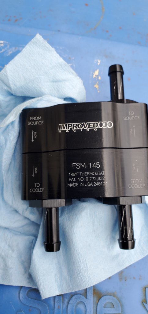

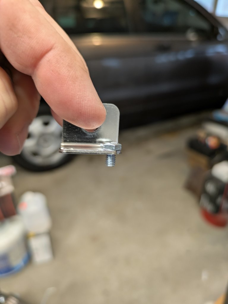

    I got my FSM145 today. Got it on ebay for $100. And 20qts of AISIN 0WS(5.7cst at 212F) to replace the DEX3( 7.1 cst), with shipping/tax was $9.60 qt way cheaper than $13 on Amazon. The DEX3 when cold causes "my" transmission to get confused in 3-4 shifts and a hard shift into 6th. Hopefully the AISIN remedies my issues. Others have used DEX3 and 6 without issues.

    @bflooks did you receive your improved racing t-stat? Mine was used and didn't get the bracket. Would you be able to give thread pitch and size? I installed it and I forgot to email the company.

    Acknowledged.
    I did receive it Let me better inspect tomorrow AM and I'll get you the additional details.

    Thanks! It's not heavy but still wanted to have it secured. Appreciate it.

    They are tiny little guys.
    8-32 with 1/4" total thread length.

    Thanks! The ones I didn't have only 10-24.
    Appreciate it. Enjoy the weekend!

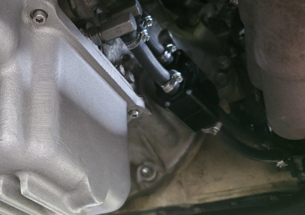

    Ok. M4 is the bolt that works. Will fab up a bracket but the 145deg t-stat is it. After a few good WOT pulls it was nice and cool. Ambient was 58deg F.
