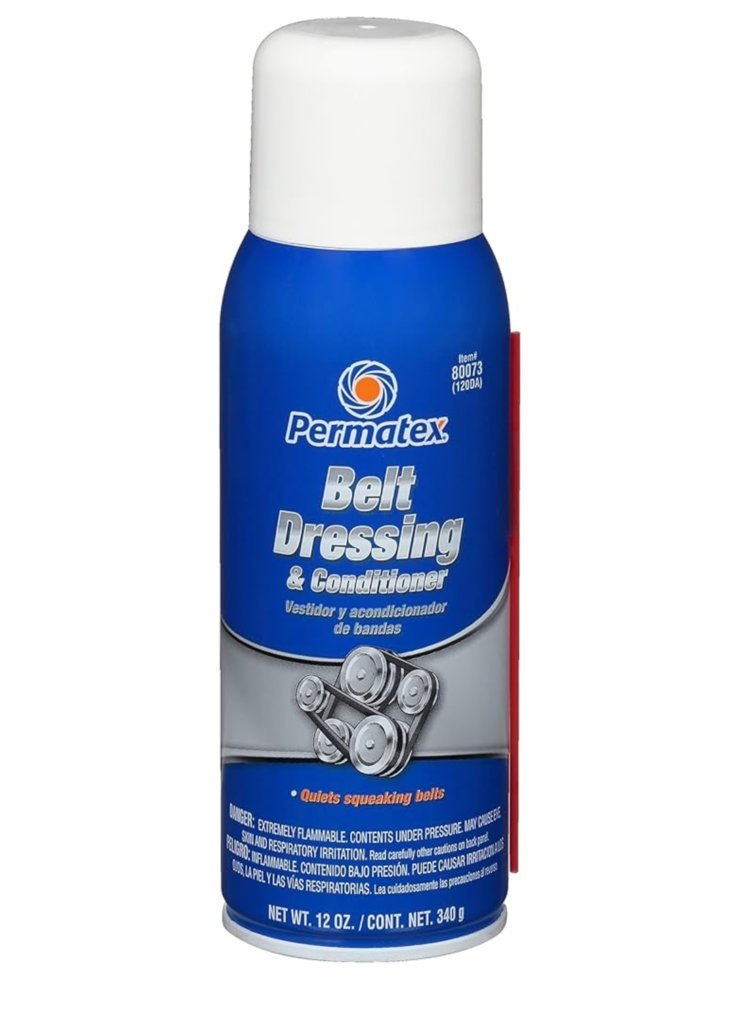

    Try some belt dressing. It’s a bit of a bandaid fix. Really good on salads.
