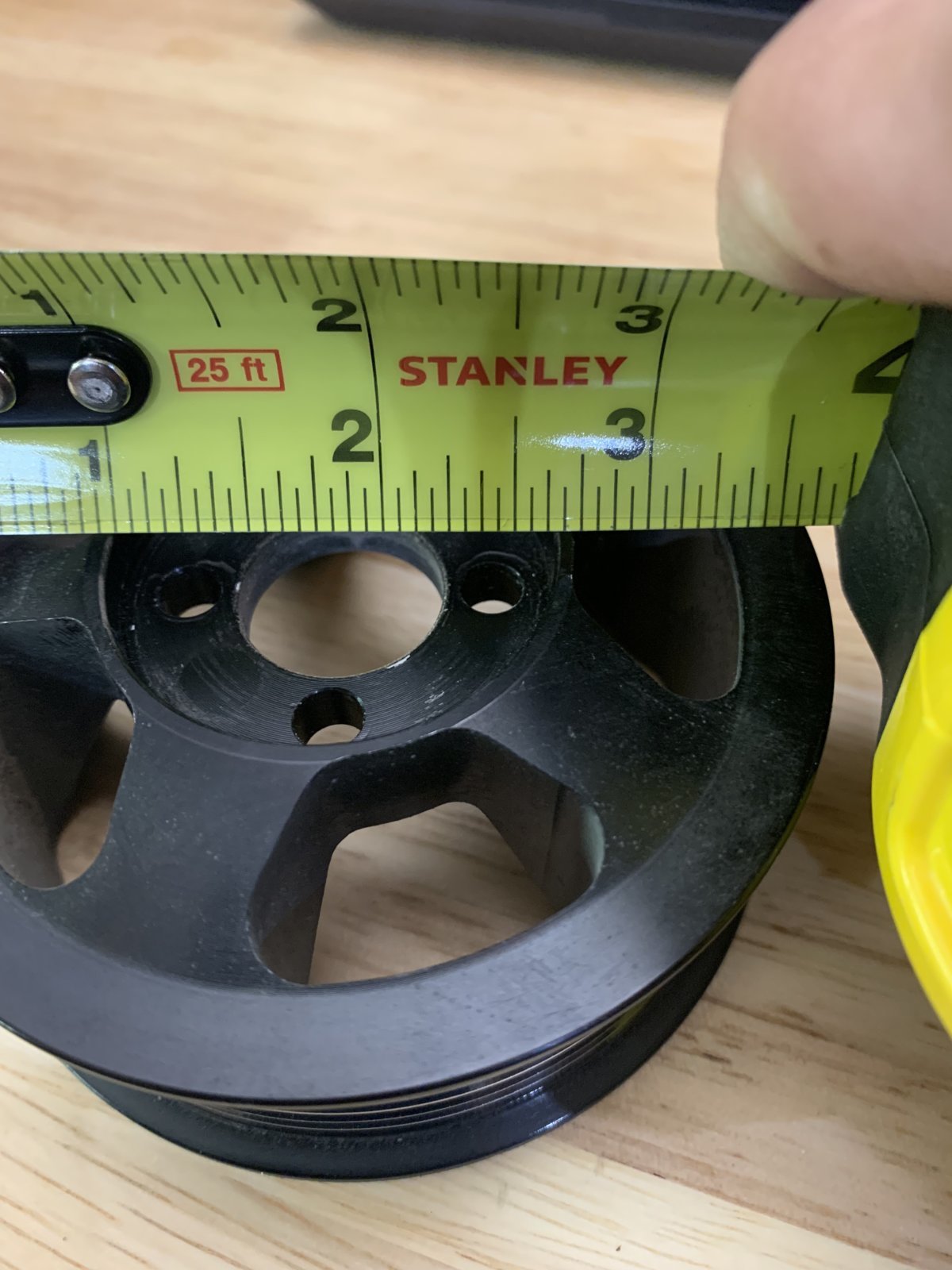

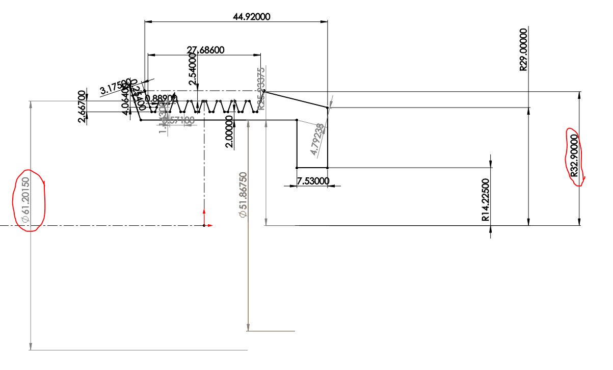

    Does anyone know the limiting factor to the Harrop or Whipple for pulley size? I just installed a 70mm on a Magnuson and measured the snout size to see how far I could push it, and due to the OD of the snout I can really only drop the pulley to ~66mm in diameter which isn't much gain. I could MAYBE play some tricks or use titanium or steel but even then I could only push down to MAYBE 64mm. I wonder if the Harrop 65mm is the absolute limit that can go? And I wonder what the equivalent Whipple limit is. Just trying to theorize which blower has the maximum boost potential.

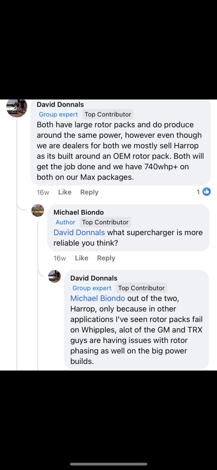

    No sir no meth just gas. Especially when I first threw on Downpipes. Had to increase power enrichment at wot. But no knock and she pulled real hard lol

    For the Whipple, the backside of the pulley shows the hub mounting diameter. My calipers have grown legs so I'll grab a metric measurement later, but American Engineering units shows ~1 21/32" . I think that's ~42mm. I should add that it certainly isn't a press fit when changing the pulley but not necessarily wobbly.
    The stock tundra pulley is 3.625" or ~92mm. For the altitude, I've pulleyed down two steps 3.375" or ~86mm.

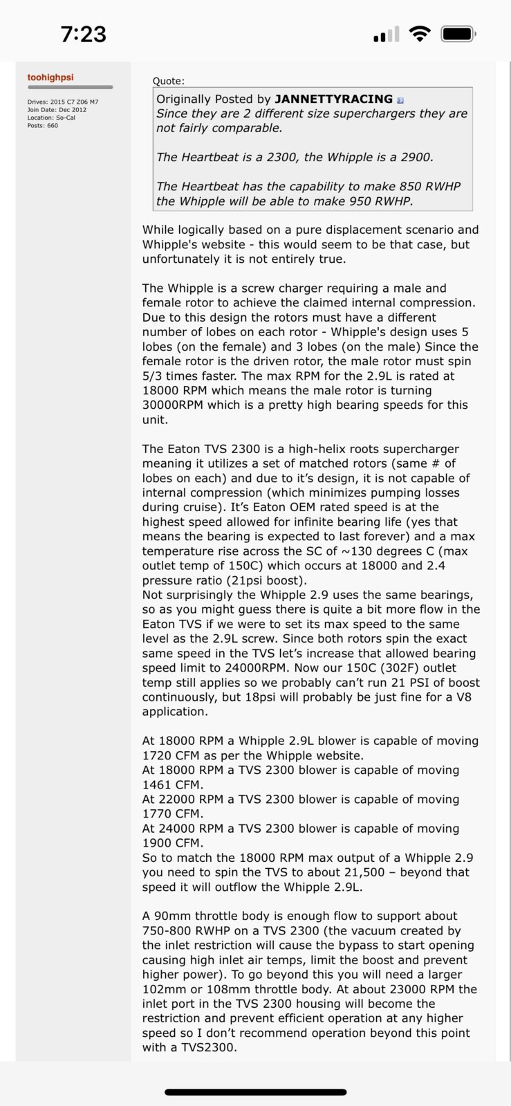

    Haven’t measured anything personally on the Harrop but in this post @ViktorG said 60mm was probably the smallest you could go. I guess you would have to pair that with a larger crank pulley to get the most possible out of it. A 60mm with a stock 6.125” crank pulley would be about 16,100 rotor RPMs at 6,200 engine RPM. With a 7” crank pulley it would be 18,600 rotor RPM. This is within the TVS limits. If you’re trying to find which can move the most air overall, one consideration when comparing to the Whipple is you should not spin twin screws that fast as they are more limited on RPM due to having 2 different size and shape screws. I believe most say 18,000 rpm is the hard ceiling on a twin screw vs 24,000 on a TVS. The reason being is if the female rotor is spinning 18,000 on an 5/3 rotor combo, the male is spinning 30,000! Apparently if spun too fast they have issues with rotor phasing and the bearings will not last. For this reason as you can see in the photo from a discussion on a Camaro forum, even a TVS2300 can theoretically outflow a 2.9 screw for the simple fact that it can be spun 24,000 RPM vs 18,000. A 2650 I suppose would flow that much more.

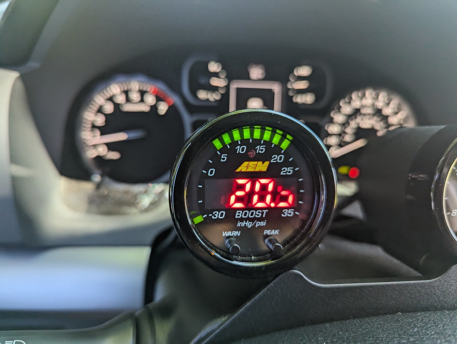

    With the A/C on it hits 20.5psi, 20psi.jpg
    on cold mornings it will hold 19psi all the way through, but I know its way out side of it being efficient.

    So according to @Silver17 post, to max out the Whipple at 18k on a stock crank pulley, the blower pulley would need to be 54mm. On a 7” pulley, you’d be looking at a 61mm pulley. Just making that clear for @reywcms

    Harrop mounting flange diameter is 51mm, the snout is 52mm.

    Same size as the Magnuson then. The Magnuson mounting flange is 51.8mm.

    According to this, @ViktorG had a 60mm on his Harrop paired with a 8” crank pulley. Depending on your engine redline that should be able to max out the 2650 RPM. He said he was running 7,200 rpm shift on his built engine, so with a 60mm pulley that’s over 24,400 RPM on the blower. The ad is for a 62mm, but in that post he referenced a 60mm. Not sure if he used a 60mm or if he is just referring to the 62 as a 60.

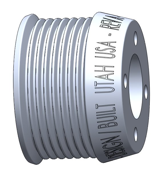

    Based on that and pulling up the Harrop CAD model I have, I think the Harrop measures pulley diameter at the top of the rib (this is how I measure the 1900 pulleys since it's easy to get the calipers on that), but the 2650 Magnuson's measure the pulley from the outside of the belt so a "larger" Magnuson is the same as a "smaller" Harrop. My 70mm pulley is really the equivalent of a 65mm Harrop since I use the same measuring convention for the 2650 as Magnuson does, and the 60mm Harrop would then match up with the 64-66mm Magnuson I'm thinking about.
    So really, the Harrop and Magnuson have the same power potential (ignoring intercooler differences) and can fit the same size pulley.
    Left number is the Harrop measurement, right number (radially) is how Magnuson measures it.
