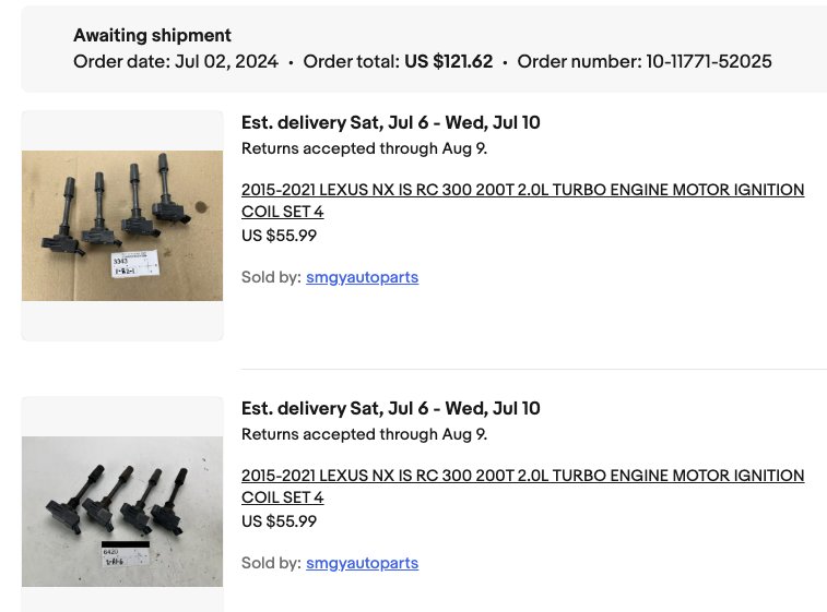

    I'm the guinea pig, ordered 8 used coils from eBay.

    They were from 2 different Lexus NX Turbos.
    I figure, if they work and one or more have an issue I'll get new ones once proof of concept has been established.

    They should work, I’ll dig further. If they work, are there gains other than durability? Durability is enough for me, but more energy for those pushing big boost surely is welcome.
    OEM Lexus part number 90919-02269 retail $112 discount around $80 Japan sourced $46
    Denso aftermarket 673-1206 retail $70 discount $49 when purchased 4+ quantity

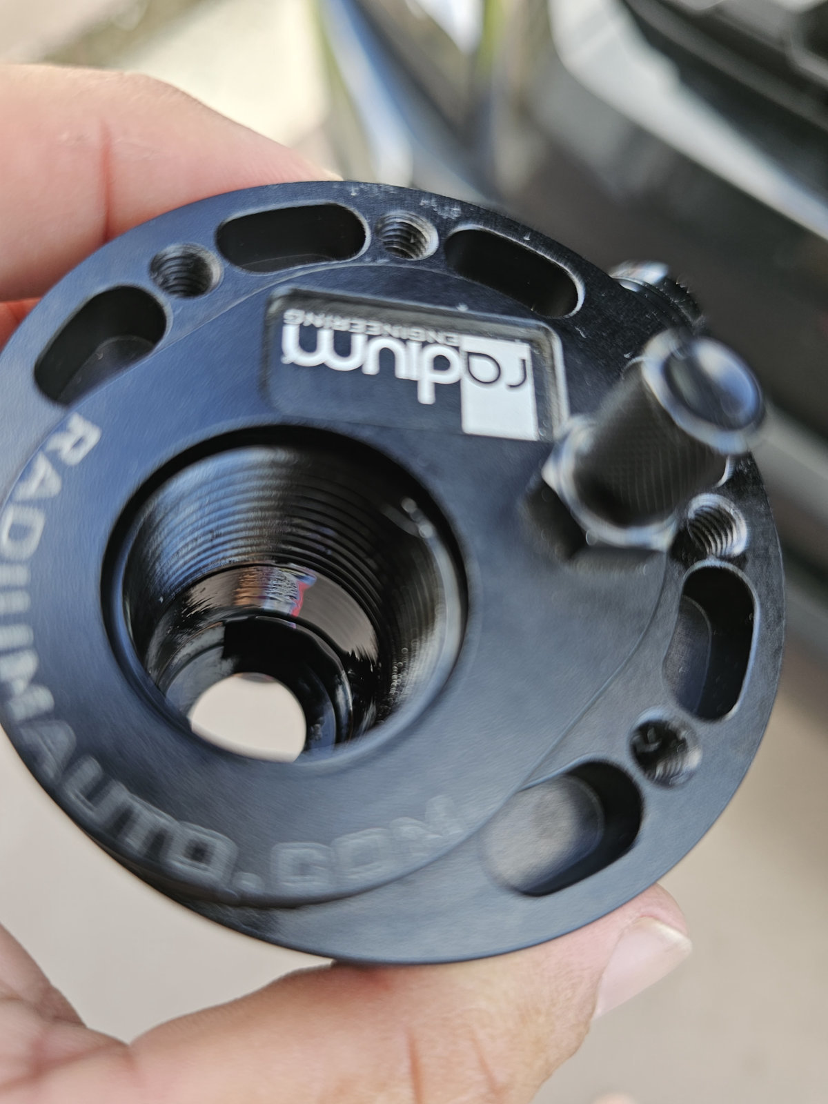

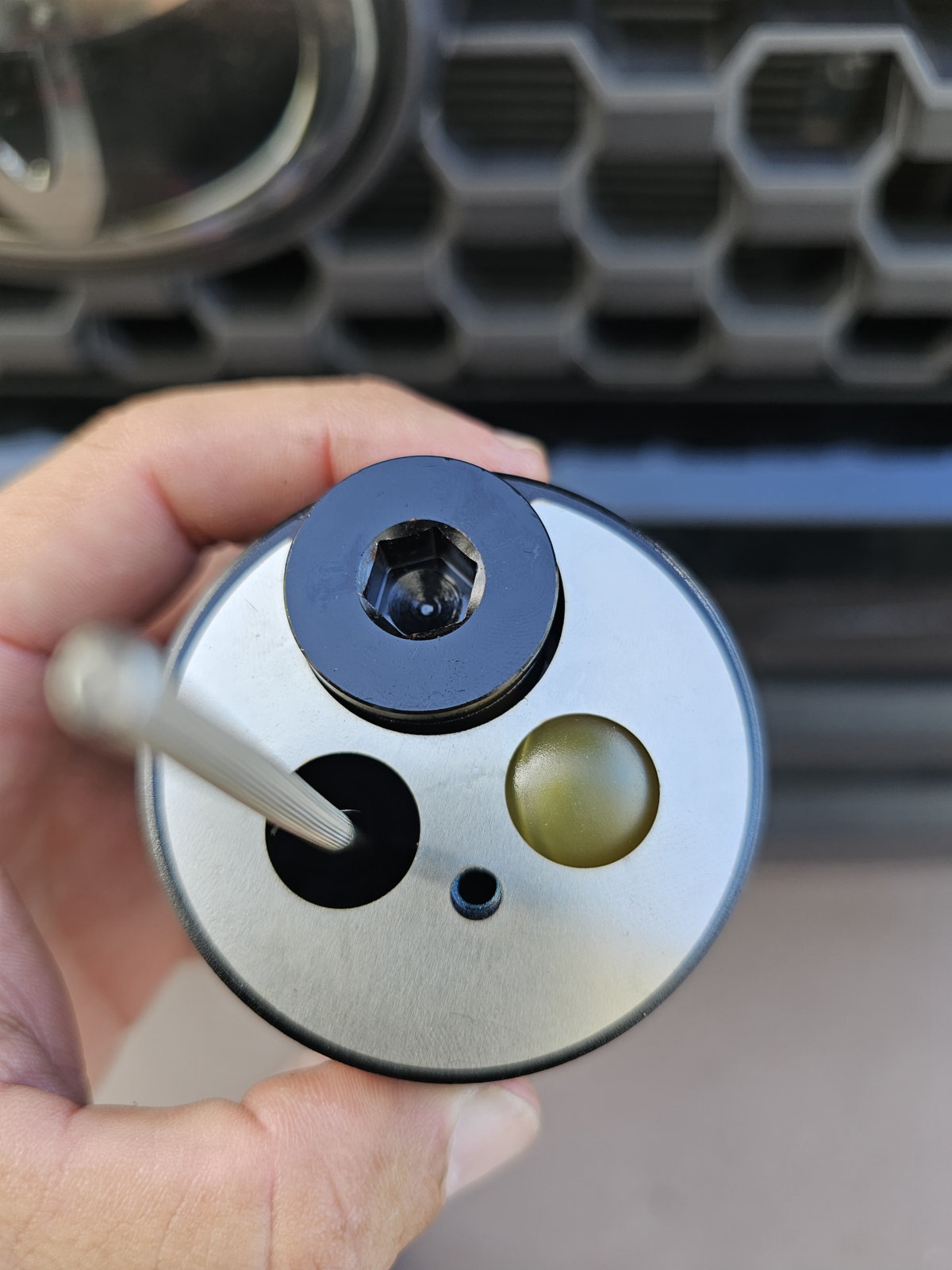

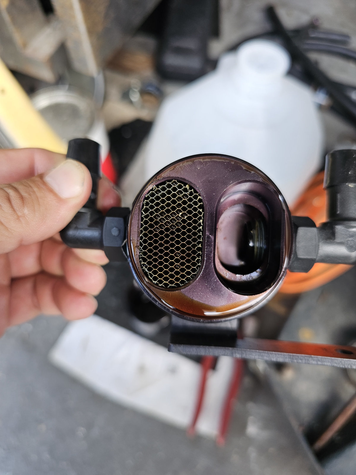

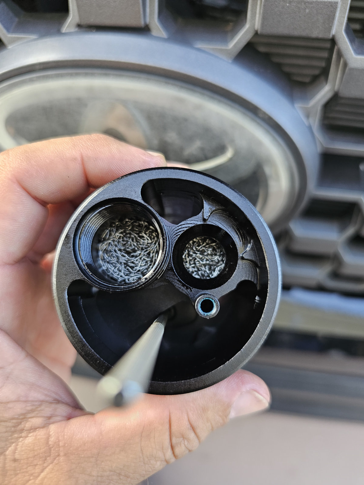

    So I am doing an oil change before a lo g trip this weekend. I go to check my Radium catch can, nothing. Not even a hint of oil. WTF. My cheaper J&L would have oil in it already. I probably have 5k on the CC and not a drop.
    So I go and recheck everything. I can suck but can blow back through the pcv valve, valve is good. Check my connections as per Radiums instructions, perfect. Hose to SC is fine, blows and socks. I can't believe this right now.
    So I start to take the CC apart. I must say, it's a shit design the way it is. The top port, pcv valve, is connected to the side port. There is a SS mesh I there which is what turn the oil vapor to liquid oil. Well, if vapor is coming in from the top, gets converted as it goes through the SS mesh, it just get sucked once it turns to liquid at the bottom port that goes into the SC. I have attached a Pic and you can see how this makes no sense to me.
    My J&L are not connected what So ever and the liquid oil drops with no chan e of getting in the port going to the SC.
    Someone please explain this to me because I can't believe after 5k I have no20240703_172236.jpg oil.

  24. Jul 3, 2024 at 2:32 PM
    PolishedTRD
    PolishedTRD Lorem ipsum dolor sit amet
    Jan 2, 2023
    #89638
    333
    CO
    Supercharged 2011 DC
    Magnuson's Finest Whine
    Yep. Terrible design. I posted my findings here a while back in the General SC thread. I've removed the plate, plug, and ball and threw in a Scotchbrite SS scrubber and now the catch can finally catches.

  25. Jul 3, 2024 at 2:43 PM
    pursuit2550
    pursuit2550 New Member
    Jul 29, 2020
    #50029
    2,279
    Florida
    That's what I am going to do. I called them and the tech was clueless. Here are the Pic I just took. First is how it comes. The oil have to get pass that ball, shit design. 2nd is everything off. How it should be and 3rd Pic is the JL can. The way it should have been designed. Vapors come in through the mess and converts to liquid. Suction port is no where near to suck it up. 20240703_173828.jpg 20240703_173847.jpg 20240703_173904.jpg 20240703_173828.jpg 20240703_173847.jpg 20240703_173904.jpg

  27. Jul 3, 2024 at 2:57 PM

    Yea the radium is kind of a pile, but looks nice. The mounting bracket is even a POS. The $30 Amazon one I have on my buggy collects way more shit, looks just as good, and cost 10% as much. Definitely paying for the name.
