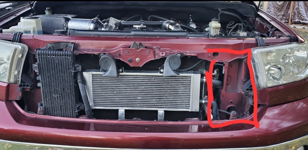

    Know you got other stuff going on. @armyoffoo did you install the engine oil/air cooler. Looked at a Greddy setup and a few Rcf ones on fleabay. Thinking of fitting a 15 row cooler on my driver side. I got a cheapo digital oil temp gage to plumb in for now.

    I've got all the parts and fittings I need, just haven't done it yet. I'm due for an oil change, but might not get to it this weekend. My plan was to try and put the heat exchanger behind the bumper cover, so it would get air through that opening vs the radiator/intercooler opening. I figured it would be easier to do oil changes if it was lower, and should still get plenty of air.

    Did you say you had the Lexus rcf filter housing and it clears the sway bar. I believe @Jowett said we needed a larger end cap for the 3urfe filter. Looking back at posts on pg 398. If it bolts up I don't mind a horizontal filter if I can install a oil to air cooler without the Baxter adapter. Want to keep parts at a minimum. Found some cheap rcf housing local junkyard. Thanks!

    1UR FE GX 460 filter housing, but it needs machine work to the oil passages for proper flow and to accept the oil coolers. The 2UR GSE filter cap allows the V8 filter to be used with the GX housing. I’ll post some pics tomorrow.

    Thanks! Trying to get some ideas just to add an oil/air cooler. Saw a gx 460 housing that had external ports, for oil cooler?

    I ended up getting the Baxter remote adapter and a Thermostatic filter housing...I just need to figure out the mounting/hose routing, but I will install during my next oil change. With the 1UR housing, I would have still needed a remote adapter and the remote filter housing, so this way required fewer parts overall.

    Looks like an easy deal. I was hoping that the rcf housing I have access to would work . It's $95 plus another $45 for the air cooler. Man, supercharging is just as bad as fly fishing with the gear.:rolleyes: and yes I just compared the obvious. I have family that remind me of the gassers. What an Era!

    If you can obtain all those parts for $140, do so. Lexus USA charges charges well into multiple four figures $$$$ territory for all of it.

    It turned out that the other Toyota housing has a different filter element depth, so the adapter didn't fit, and of course none of the other adapters I had fit it either. That, and I would still need to work out fittings/adapters to get oil pressure and temp logging, so I scrapped that idea. The Baxter remote adapter has ports out the bottom or out the side, so it'll clear the sway bar no problem.
