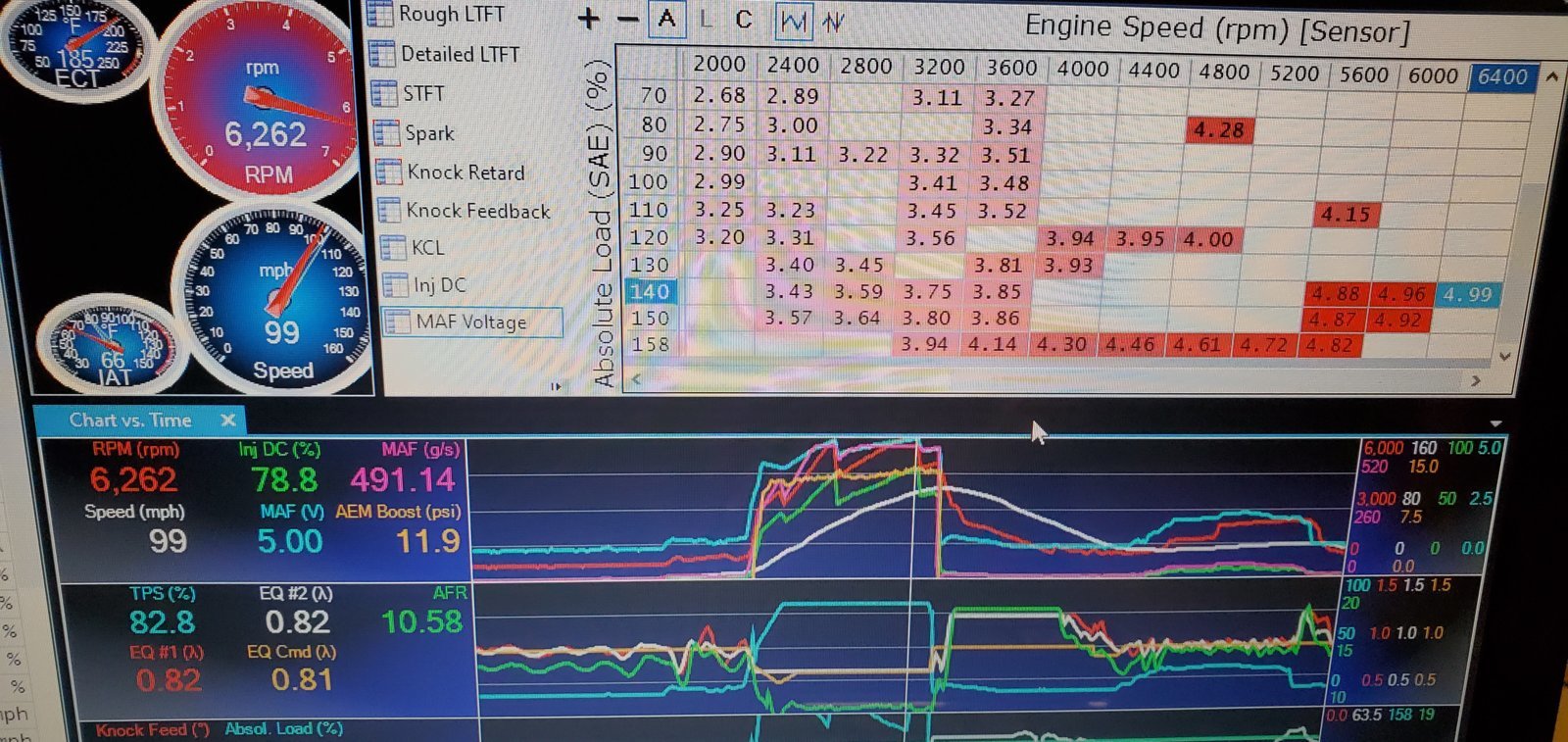

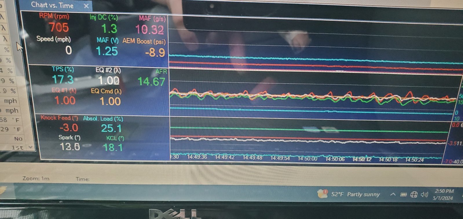

    My maf and narrow band O2's were flat lined but after the 4.5 inch intake and 95mm TB it's jagged. Would turbulence cause it? It's runs sweet otherwise. No air leaks etc...

    Think it may be time for turbokits MAF...

    That looks like a first gear pull, how do you even have traction?

    The 2007 aLSD let's me pull through the nannies. My Auburn is toast and has been 6mos after getting it.
    Went to the airport to test 6000rpm pulls.
    My exhaust mod has me down to 12psi.
    https://vimeo.com/941811316

    And i threw in a newish maf I had for emergencies. Same result.

    Time for that honeycomb shit, if you care about how jagged it is.
