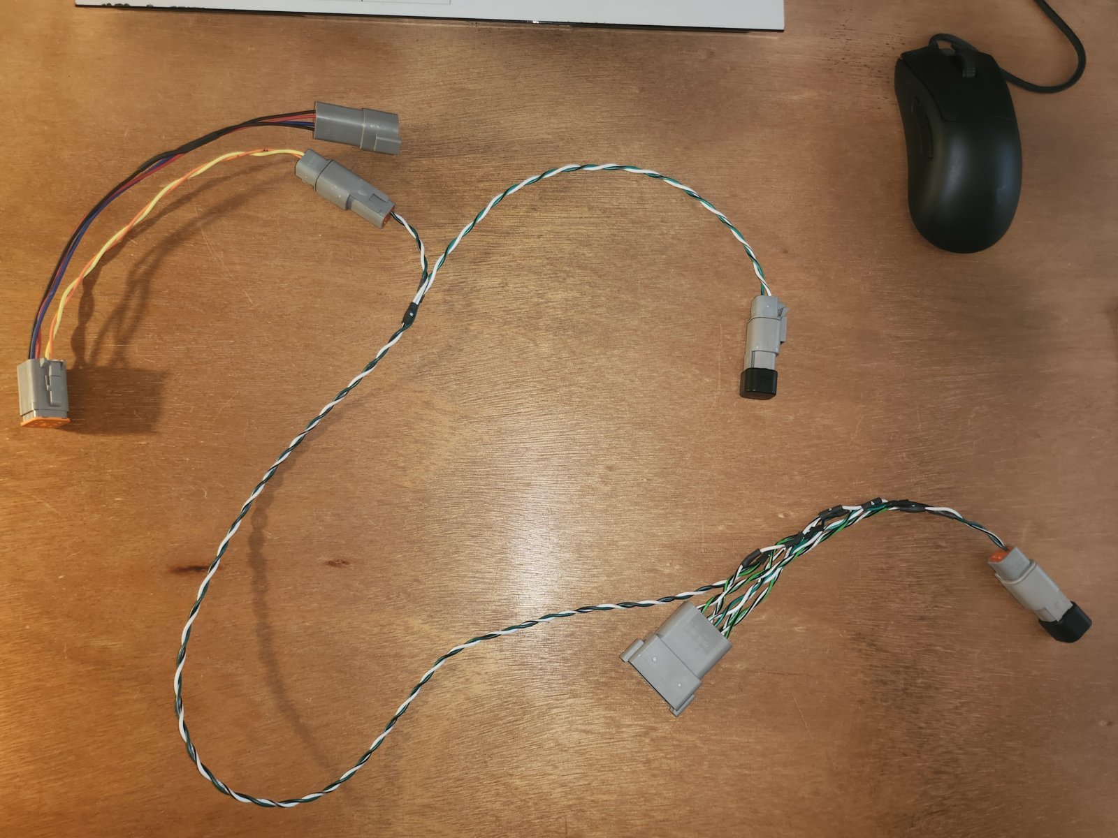

    CANbus below is one twisted pair "trunk" going from the terminator at the top right, to the terminator at the bottom right. Each device has a "stub" crimped onto the high and low wires of the trunk and connects to the CAN high and CAN low from the device. I have 5 stubs terminated to the 12-pin connector for my gauges, and one stub for the MPVI3. The other connector is for the analog inputs.

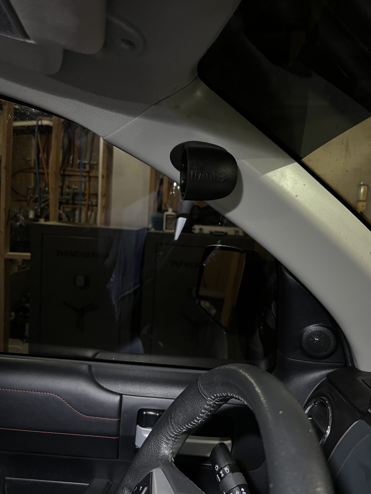

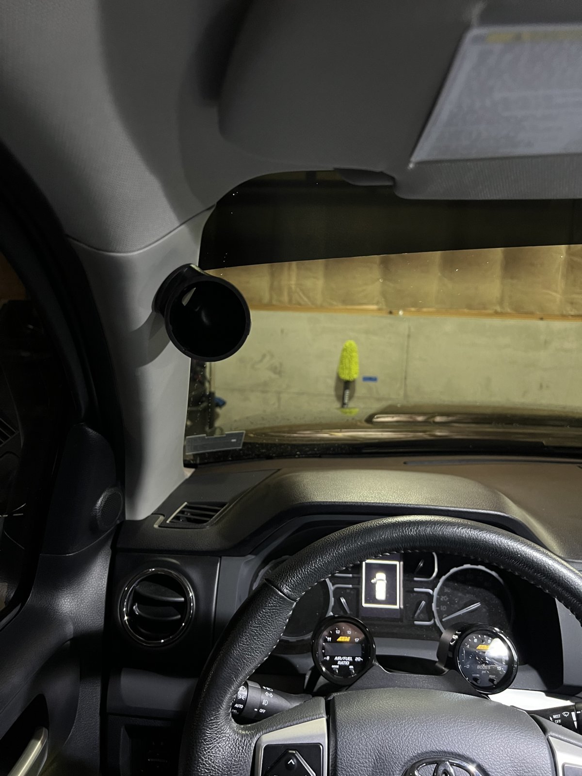

    I’ve been doing some test fitting with banks power on their a-pillar pod that they have for the 16-23 Tacoma, appears to fit like a glove if anyone is interested in have a gauge in this location. I just need to find some paint to match the pillar. IMG_4327.jpg IMG_4326.jpg

    That would be driving me crazy. (Short trip)

    Nice. But I would need it lower out of my field of vision. I'm used to giving quick glances at my gages.

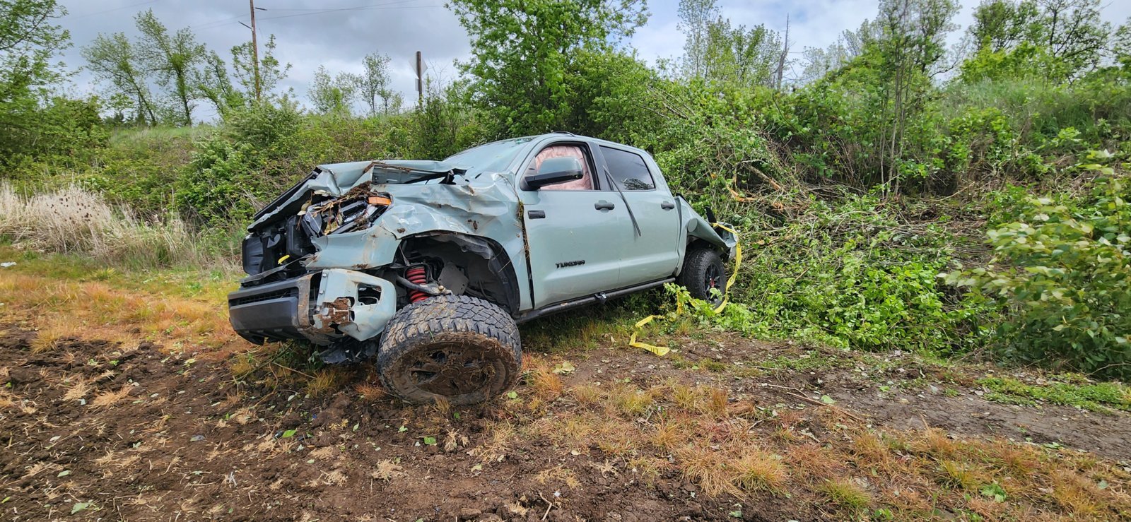

    Well, it's been a pleasure. Hit a rock patch on a damp road coming around a corner and couldn't save it.

    Damn, sorry. Are you ok?

    Aww man that's harsh. Was it a roll over? Bed looks crushed too.
    Hope everyone is doing well and truck did its job protecting you. I used to run our logging roads hard until they closed them off. Hope insurance treats you well!

    I walked away and was by myself thankfully. Little sore. I went through a tree and down 15ft into a farm field. The wreck didn't seem that bad from inside. Bags deployed and I thought I was in a big pillow. Thank you everyone!
