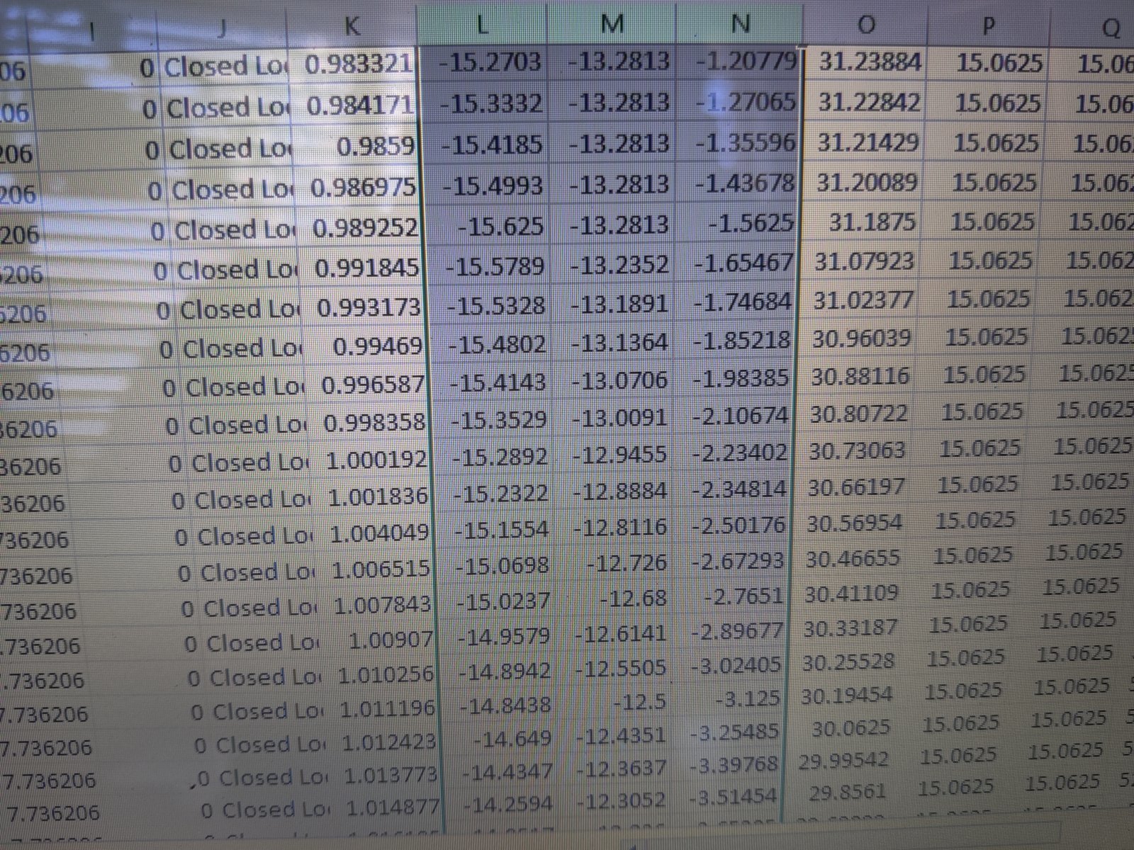

    I just looked at a log @Grenades4Bacon sent..... If he's on the RTD device is so out of wack it's insane. Can see STFT -20 still trying to take fuel from the LTFT that are already negative! He for sure needs a MAF tune from what I can see with my limited knowledge.

    Ironically a datalog he sent me earlier showed the fuel trims actually very dialed hahaha

    :rofl:Well shit looks like out of the 5000 datalogged line items I scrolled to a -20 area, not sure where that was at. Just clicking around I found this spot but if this is 1single massive data log overall his LTFTs are close to zero with -7 being the worse haha. @Grenades4Bacon was the excel one single datalog or multiples?

    Yup, it was one long drive.

    Holy shit that is a lotta data:rofl:. Well at the end of the log your LTFT are within -+2 so I degress..... Lol. Do you have a log in open loop WOT?

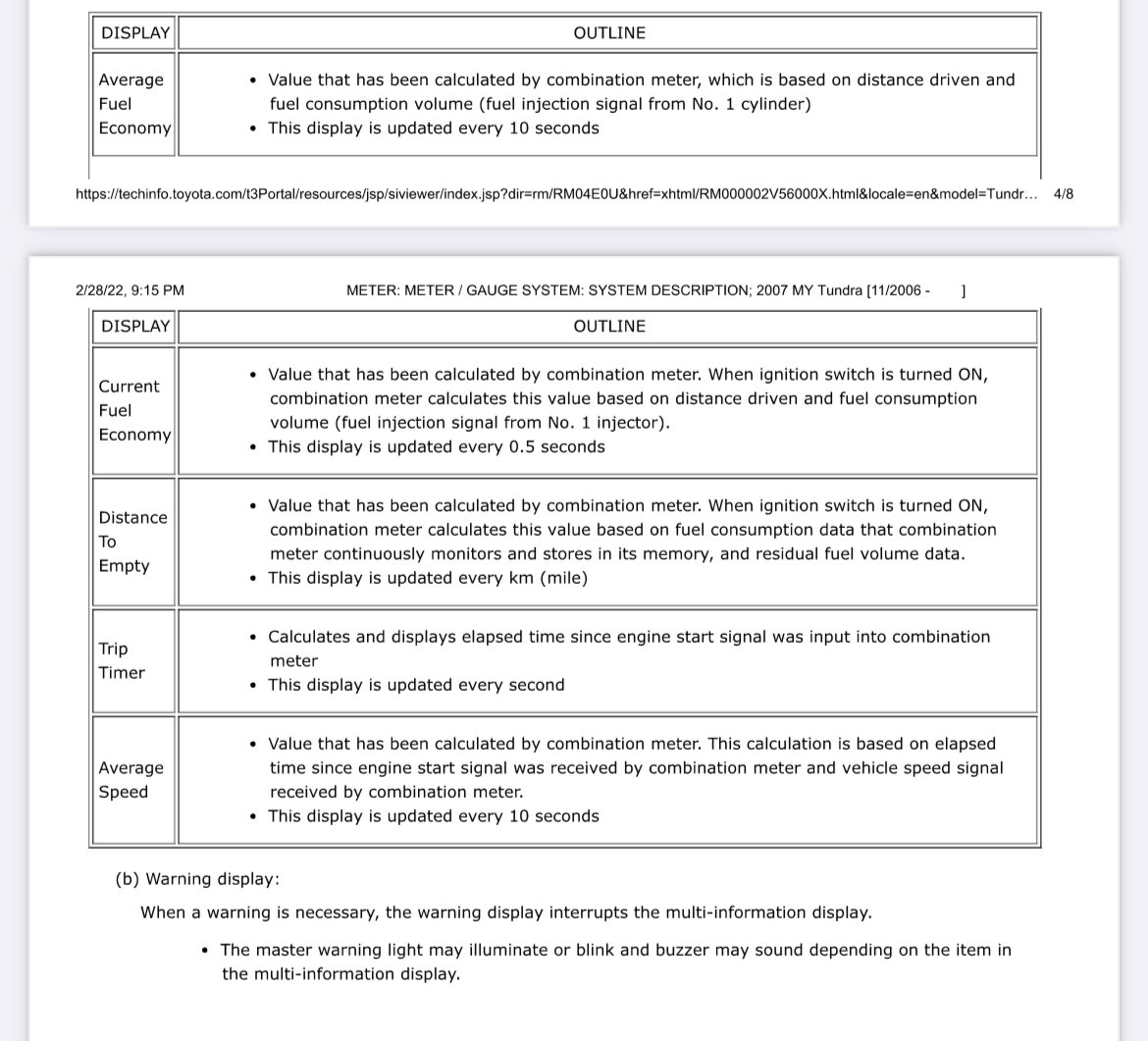

    For those with larger tires or want to adjust shift point in HPT Grant from TRP gave me a excel spreadsheet to adjust shift points. You can enter your gear ratio and tire size and plug in each gear ratio to get your new shift point. Does upshift and downshifts. Hope it helps! I have it in excel and another that works in open source or the like for those that don't have microsoft crap. The site wont let me upload the open source document so if you need that I can email it.

    Seems most the inaccuracies come when the truck doesn’t correctly determine “distance driven” due to tire change ect.
    Yes ECM sends CAN message relating to fuel injector #1, Cluster uses this data, distance driven (from ABS ecu/wheel speed sensors) and fuel level (direct line resistance from tank) to calculate Avg, Instant Fuel Economy and Range (DTE)

    That seems to make sense as many people change tire size and it throws everything off. I'm using the stock tire size, but we've all changed the Injector Constantin our tunes for larger injectors, and that's gotta be throwing off the cluster calculation with the pulse duration of larger injectors being shorter giving the false result of a higher MPG. Thanks for the attachment detailing how each of the other values are calculated. Dig stuff like that.
