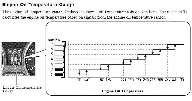

    @Mdl I’m happy to be part of this, to contribute, learn, and share.
    No oil temperature sensor exists on these trucks. My 3rd gen Taco attempts to gauge oil temperature via coolant and other parameters, not sure it works very well.
    @snivilous is this oil/oil cooler talk too far outside the intended purpose of the thread?
  3. Nov 24, 2023 at 7:07 AM

    If one was to add an additional oil cooler, what is the recommended unit?

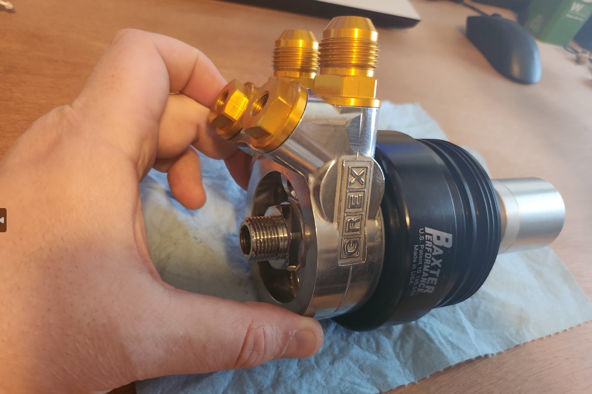

    It looks like that adapter/bracket uses the same cartridge filter, only mounted horizontally and without the engine coolant connections. I know there are adapters for these cartridge filters that remote mount a filter, which would enable you to plumb in a cooler. Baxter makes a couple different adapters for our engines, but their cannister to traditional screw-on oil filter adapter caused interference issues with my sway bar and the oil filter, so I wouldn't recommend them for the stock setup, but mounted horizontally should be no issue.
    I ordered one of these anyways, I have a timing cover from XAT I can test fit it on. If it fits and clears the larger crank pulley I plan to run, it's a win-win.

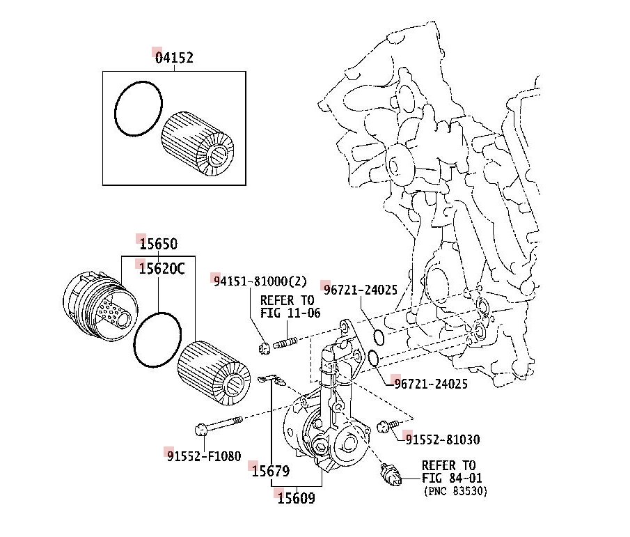

    A couple of things to note.
    The GX460 bracket requires the Lexus IS-F oil filter cap in order to run the V8 sized cartridge. A restrictor machined out of one the gallery tubes. An OEM donut oil to coolant oil cooler AND a thermostatic take off sand which plate can be added to the blanked off side (this will require machine work). For that matter, a spin cartridge could be mounted there, too… However, the horizontal filter is far easier to drain than is the vertical unit.
    I had a GX bracket, but it disappeared. I may order another. If you look at the parts diagrams for the Lexus IS-F and RC-F, they have a similar bracket and show how coolers mount. The IS-F uses only the oil to coolant, the RC-F run the oil coolant AND an external oil to air.

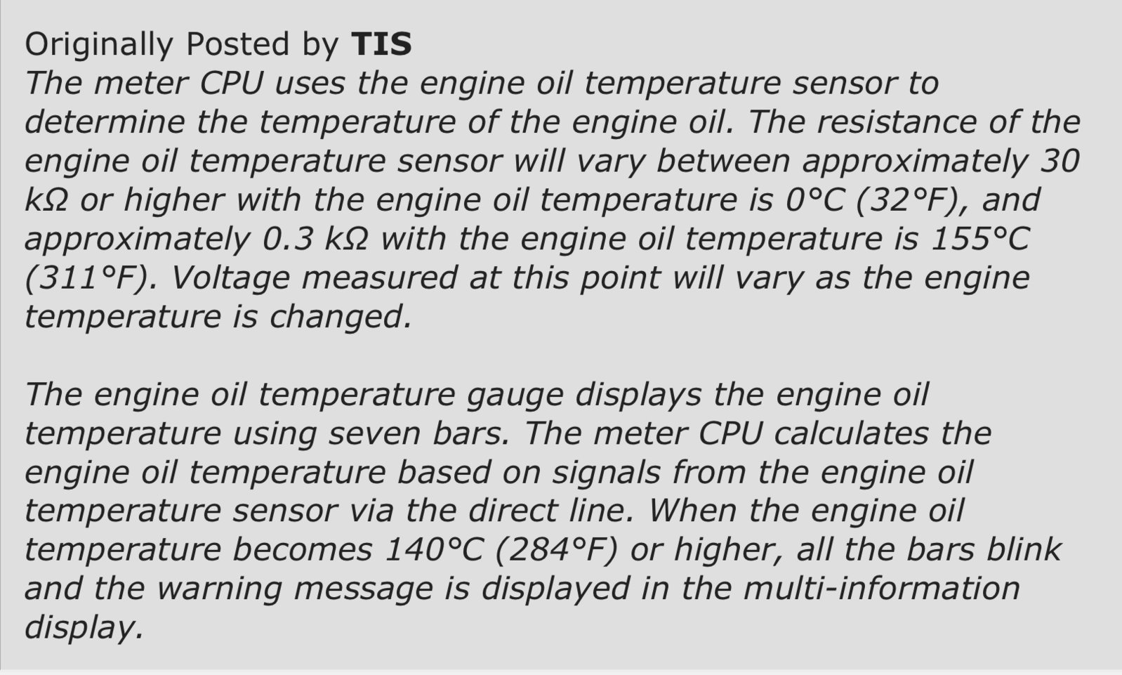

    I don’t have oil temp info for the 3UR-FE, but the high output 2UR-GSE from the above mentioned F cars is available. 284F/140C is overheat. The IS-F 416hp engine with single oil to coolant cooler, similar to our 3UR, can push the oil to overheat is as little as 10 - 15 minutes of track lapping. I suspect the RC-F w/ 467hp version of the engine gained an additional oil to air cooler in response to that.
    If an aerodynamic 3800 lb car with a 416hp 5.0L UR Series V8 can overheat the oil, what will a 500 - 600 hp 5.7L UR Series V8 pulling around 6000 lbs of pick up truck do? Now tow 8000 lbs over the mountain when it’s 90 degrees + in the summer. I don’t want anything close to 284F spraying the bottoms of my cast pistons when the hot boost is pounding on the other side, we are not normally aspirated here.
    Ideally, we should measure our oil temps under real conditions, collect the data, and work from there… but my best educated guess is that an additional oil cooler will be of great benefit. Anyone have thoughts? Please share.

    I forgot I had this from my Tacoma, so I mocked it up with the Baxter adapter...it fits, but it's way too heavy to be hanging off that side-mount housing. No doubt would crack down the road. I think I'll have to get their remote-mount adapter and the inverted mount to make this work. Good news is I now have ports to monitor temp and pressure! I might need to paint the housing though, and get some black fittings...loots like it belongs in Rey's engine bay!
