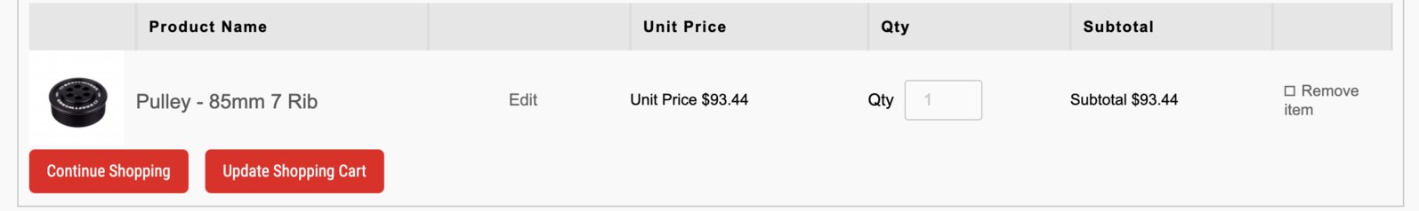

    Nope, belts and pulley ribs are universal.
    seems to me if it’s one rib bigger should be ok but what do I know?
    lol

    The 6-rib belt "should" work on the 7-rib pulley if the ribs line up...but you'll probably go through belts faster if there are any alignment issues. Might want to run it by a Bimmer forum.

    Thanks, I did. In a thread specifically about this set up, the previous last post was in 2011 & it's been a few days, nada.
    lol
    https://www.bimmerforums.com/forum/...Rotrex-S-C-on-s52-Z3M&p=30916339#post30916339
    Also, as far as the fitment, it is just a need to mess with the hoses to fit the hood slope, I found several YouTube videos where the issue is resolved.
    I need to find a meth kit now too.

    One rib bigger is fine. On my supercharged LS the supercharger pulley is actually two ribs bigger and the belt spacing ends up using the 6 middle ribs out of the 8 total. As long as the spacing is fine I wouldn't worry.
