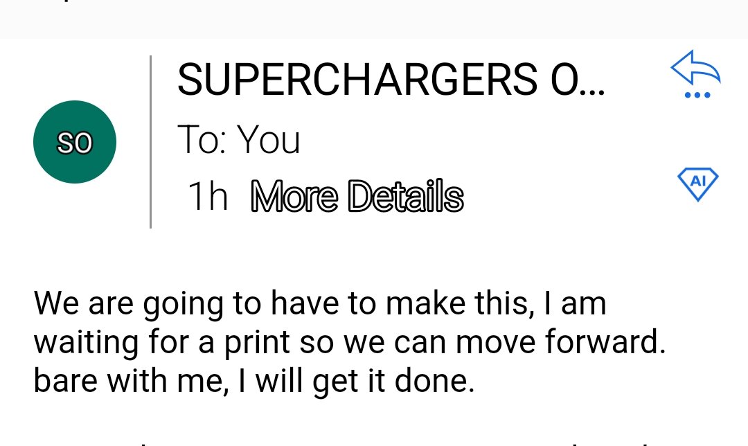

    Well apparently like an idiot I spoke to soon .... SCOL is on it

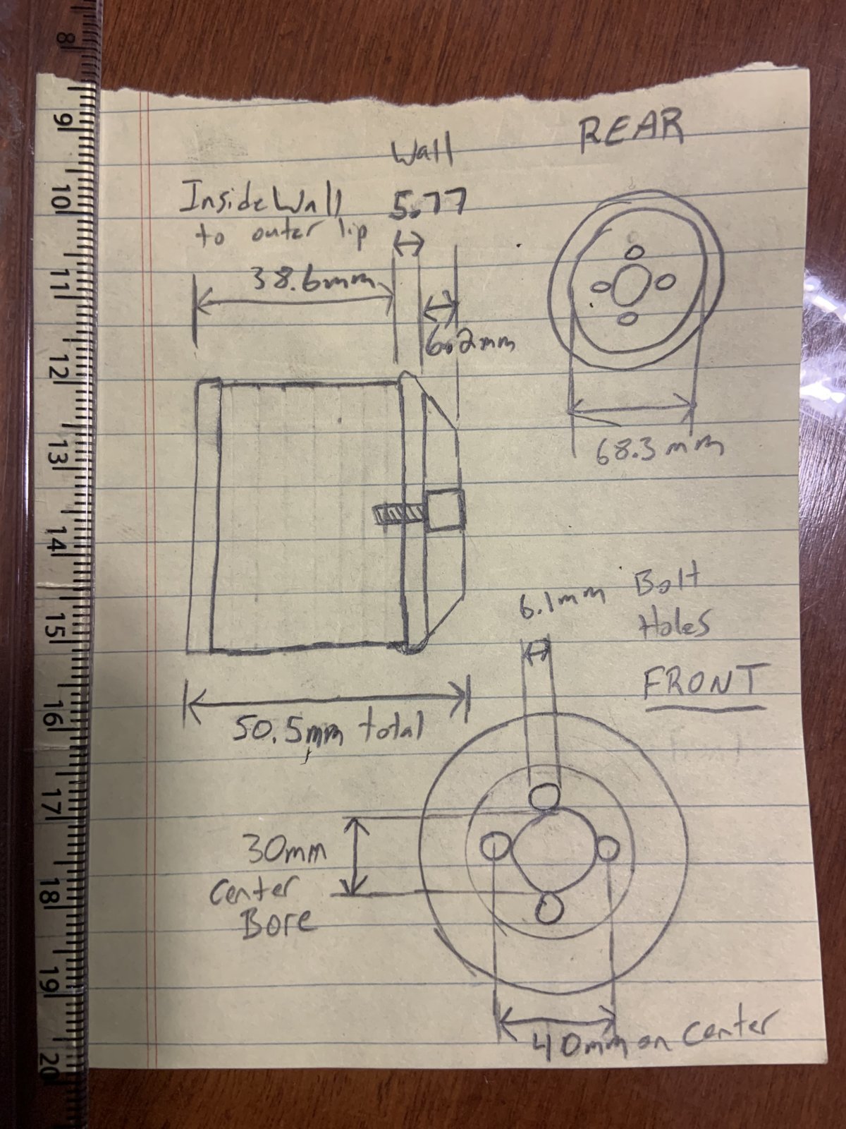

    If you can read/understand it these are the pulley Harrop measurements I just grabbed with a cheapo caliper. I used metric instead of freedom units, but can be converted by dividing 25.4/x measurement.

    Additional/updated measurements edited to the post. Not sure if that’s all of them. They’re really just to give a rough idea if by some chance they are compatible if the Harrop style bolts were used.

    Anyone off hand know existing crankshaft pulley diameter? 6"?

    Looks like 6.25"

    I have 2 on the shelf but no decent caliper to get OD over lip and 6.25 as @armyoffoo sounds about right. You have to remove the oil sender for ASP and Prospeed needs a relocation nipple. Not sure if ASP has any in stock but they do have the smaller water pump pulley for $75. Also a 2013 highlander tensioner pulley is 1/4 inch smaller than the Tundra and will give an extra 1/8 inch to get belt on for TVS1900 owners. Other models shouldn't have an issue.
