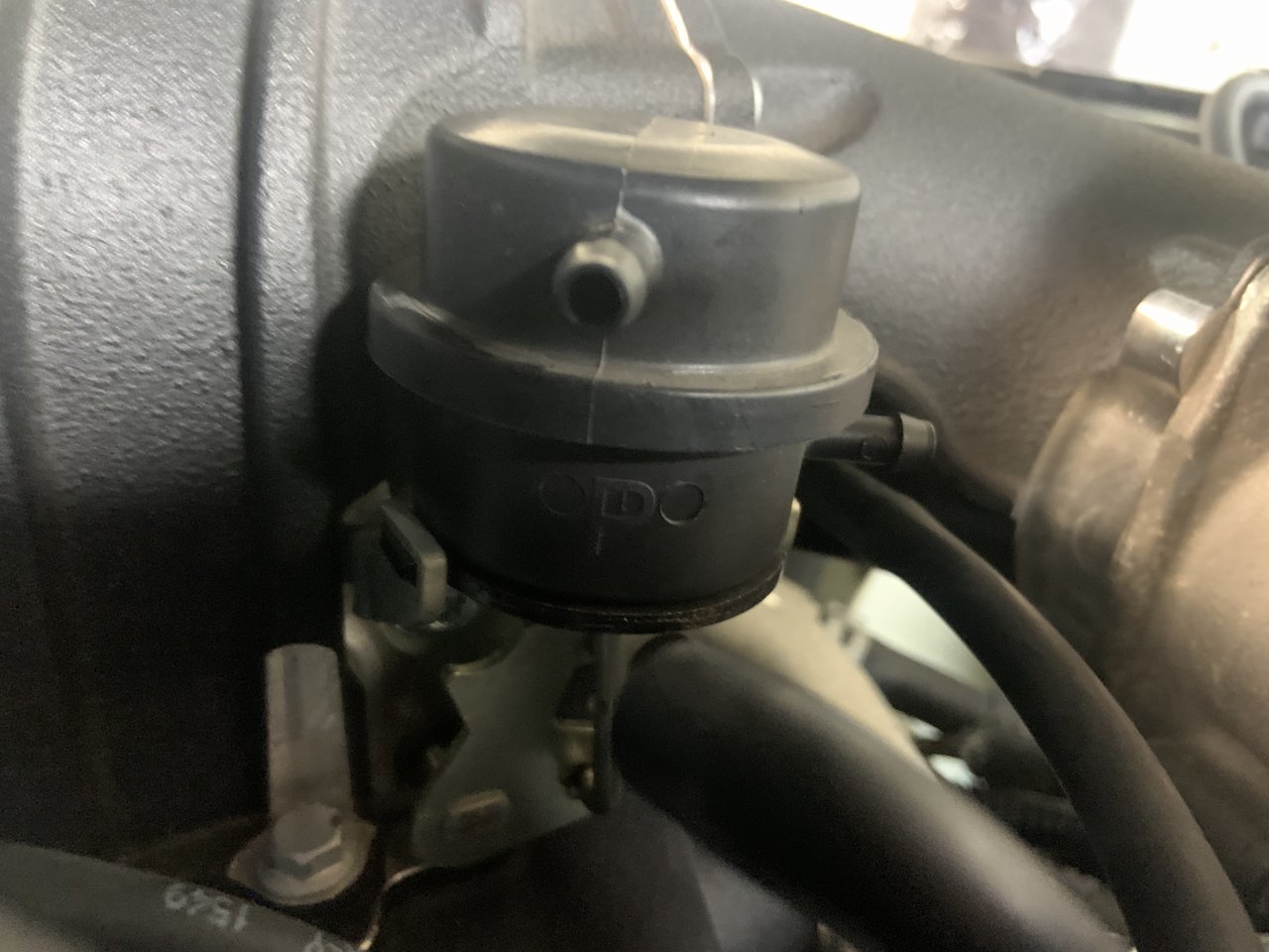

    Online I saw a few videos about adjustable bypass valves to control the rotor bypass plate. Interesting...

    Well, like I said there is no such orifice on the Harrop bypass, so it can’t be that big of a deal to not have it unless they just sized the port on the valve itself accordingly for the same purpose.

    Is the port positioned such that you're able to see the ID? Remembering that the jet is all of 0.035in. About as big as this period: .

    Looks like .162” according to my harbor freight special calipers.

    Mine says the OD of the jet is 0.17"/4mm, so close enough. So I suppose that it could be considered that it has been established that it's probably okay to run it or remove it dependent upon preference. :thumbsup:

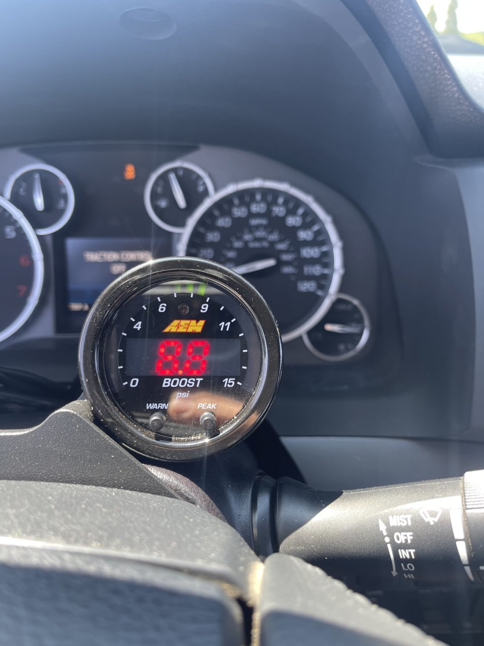

    Still waiting to get the tune done but went out today and got on it and watched the AFR’s. Right where it needs to be so did a few more pulls both from a roll and dig. Felt awesome. Lights them up through first no problem. Boost spike to 8.8 before settling to about 8

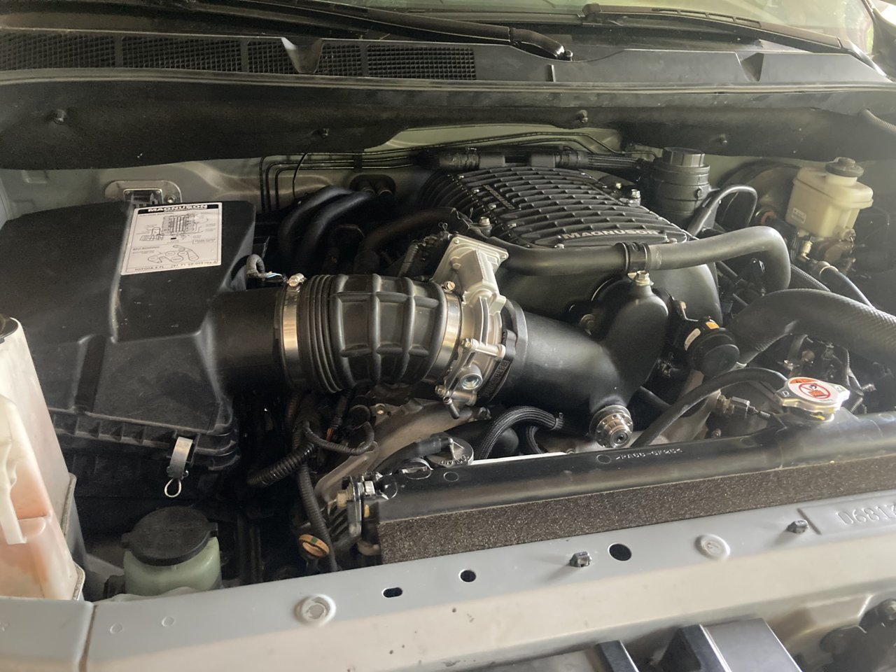

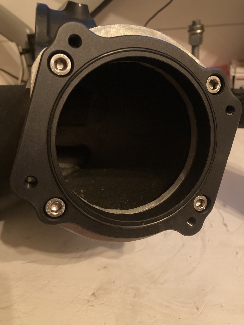

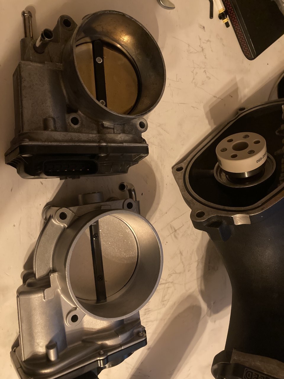

    Finally got new 750cc (really 725 in my case) injectors, RCF throttle body (with adapter and bored out intake), griptec 2.3”, 450 walbro and new coupler installed. Likely should have gone Sniv pulley system but had the griptec already. Removing the stock pulley is not fun and was surprised how heavy it is. Another surprise was that although I was careful to immediately seal the intake ports the fuel ports share the same port so some dust around the fuel injector ls fell in and had to painstakingly clean them. Best thing I found was a wooden skewer with a wet wipe to clean around the valves. There is one open valve pair so watch out haha. Then when I fired it up the first time got P030x codes (misfire) and was scared I messed up then realized the prospeed/development fuel injector harnesses can be very hard to get to “click” and no more codes.

    I'm surprised at how much debris flies out of there when I hit it with compressed air before taking things apart. I raid the First Aid box at work for the cotton swabs with the long wooden sticks for cleaning up the FI ports.

    Yea no kidding, dirtiest part of the engine is the one place you can't clean at all (I guess that makes sense, but I never clean anything anyways soooo). I usually try to shove the shop vac in there and then dig out the shit with a cotton swab or something, which still seems to be extremely ineffective to the point I look at the engine and go "if you die you die" and just hope I don't spill 5lbs of dirt into the intake.

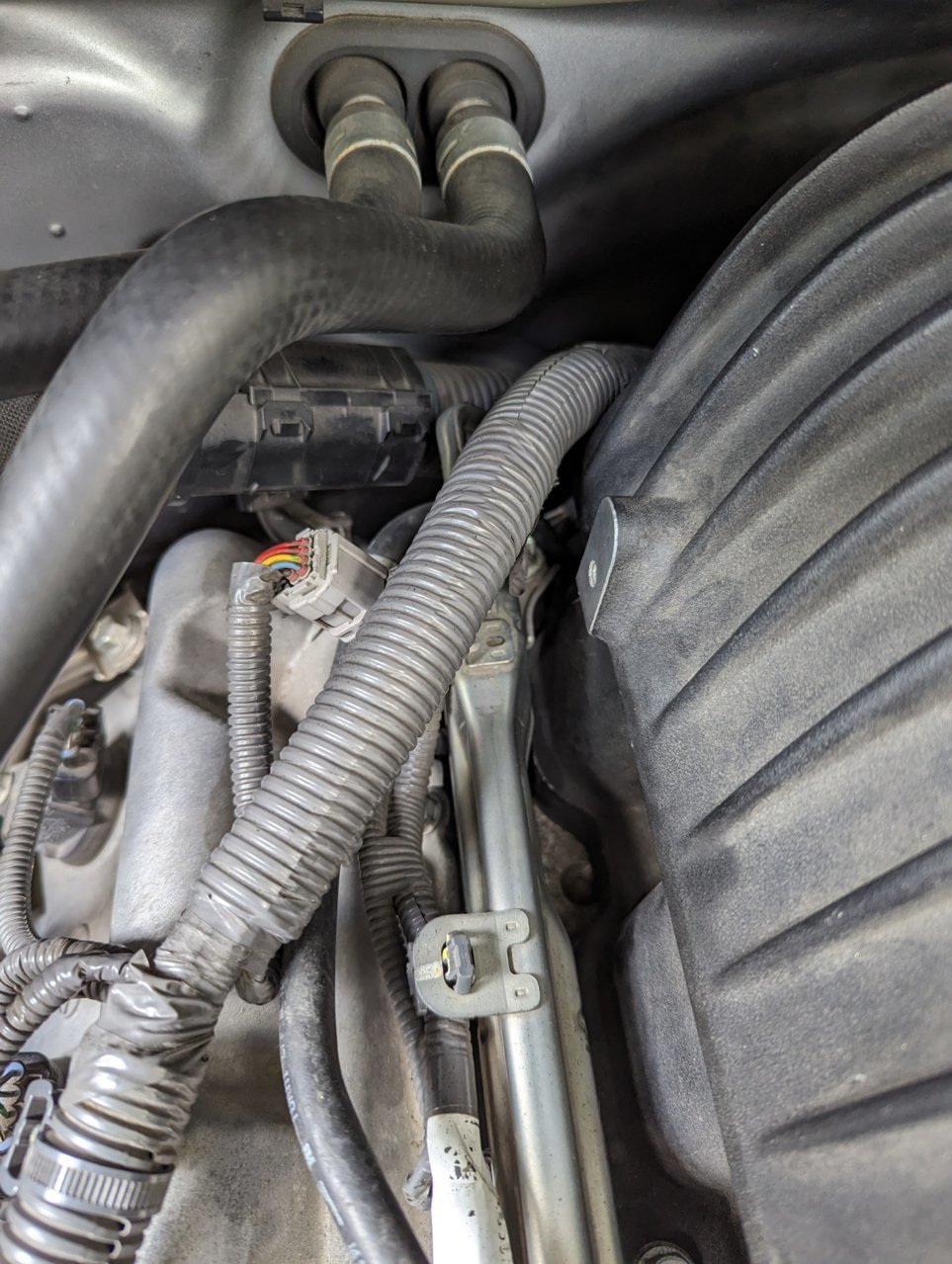

    This wiring harness just kills me when working on the passenger side. I have yet to figure out how to create enough slack in it to make changing the injectors easier without removing the rail completely. And if you pull the entire rail out with the hose that runs behind the blower, have fun blindly routing it back in. :frusty:

    Yea I have yet to figure out a good way to do that side either. Between the huge wire bundles and the hoses and then trying to molest the fuel injector connector off...

    Good, so it's not just me. Misery loves company. :rofl:
