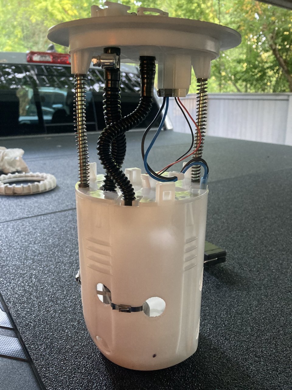

    Hey thanks everyone for your help with the walbro/ti 450 install. Dropping the tank is an experience but once you’ve done it seems not so bad! Used two floor jacks to do a controlled landing. I used the optional summit 450 install kit that was great, used their fuel line, wires, etc. everything I needed. Modified the basket to have a dozen 5/8” holes and a large opening in the top to make the summit fuel line fit easier. I ended up using three stainless steel ties to keep the pump upright and tight. First turn over was long but that’s likely due to no fuel pressure then several turn off/ons on the test drive had OEM like experience. Next up is stage ??? 2.3” pulley, RCF throttle body, 750 injectors, colder plugs, ARH headers with 3” BAM race exhaust haha.

    Update over night now after sitting for a few hours has a long 2-3 second start. Truck drives normal and AFRs seem correct. Guessing the fuel pressure is slowly going down. Sounds like the TI450 model 274 does have a check valve so this means there is a leak somewhere. I’m now realizing I used a 3/8 nylon hose on the 3/8 fuel pump barbs but then the other end is a 5/16 OEM barb which I tightened down alot. I would imagine the correct thing to do is have the 3/8 nylon go to a 3/8 to 5/16 adapter (two sided barb) then a 5/16 hose going to the OEM 5/16 barb. This may explain why others have a similar issue if using dissimilar hose sizes.

    I'll say it again, I think it's a bad idea to use that black plastic corrugated shit on the high pressure side. I find it hard to believe that will hold a seal under pressure considering how stiff it is, and normal rubber fuel line is better.

    Haha yeah starting to think this. I confirmed today that Walbro 450 model 274 do have check valves. So very much points to the feeder hose. I’m gonna try a 5/16 hose replacement for the 3/8 and if that doesn’t work switch to rubber style. Will be a professional tank dropper when this is done lol. Also interesting reading on amp usage for walbro models where the ones without valves produce 20-25% more flow but at the same amps as the 450/274 model at around 17amps max. I was also surprised that my 2021 fuel pump fuse was 25 stock whereas I think prior models may be 15, wondering if anything changed (possible the flex fuel trucks were 25amps originally and Toyota switched to all 25 in later years?).

    I dropped the tank a few times testing 4 different pumps and always used submersible rubber hose without fail. It just seems to hold up. I stopped cutting up the canister as I never liked how it would act under 1/4 tank. Glad to see tuning available after a long hiatus. You guys are inspiring!
