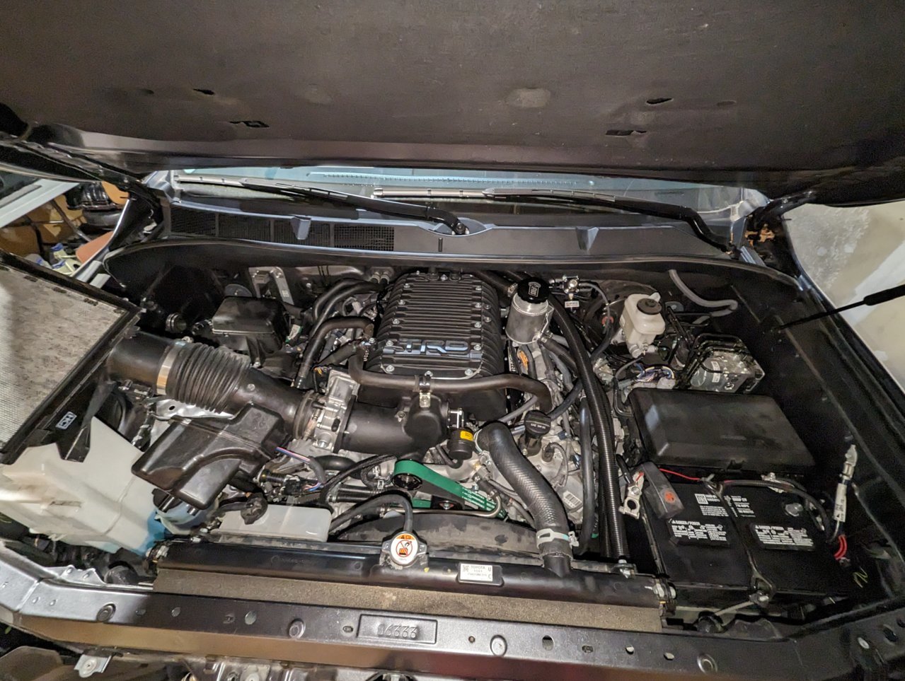

    Pretty much ready for tuning! Tomorrow I just need to get hose for boost referencing, Toyota coolant to refill radiator and intercooler. Then reconnect battery and cross fingers!
    Oh and I am missing the intercooler reservoir bracket, but can get along with our that for now.

    She sure is purty under there

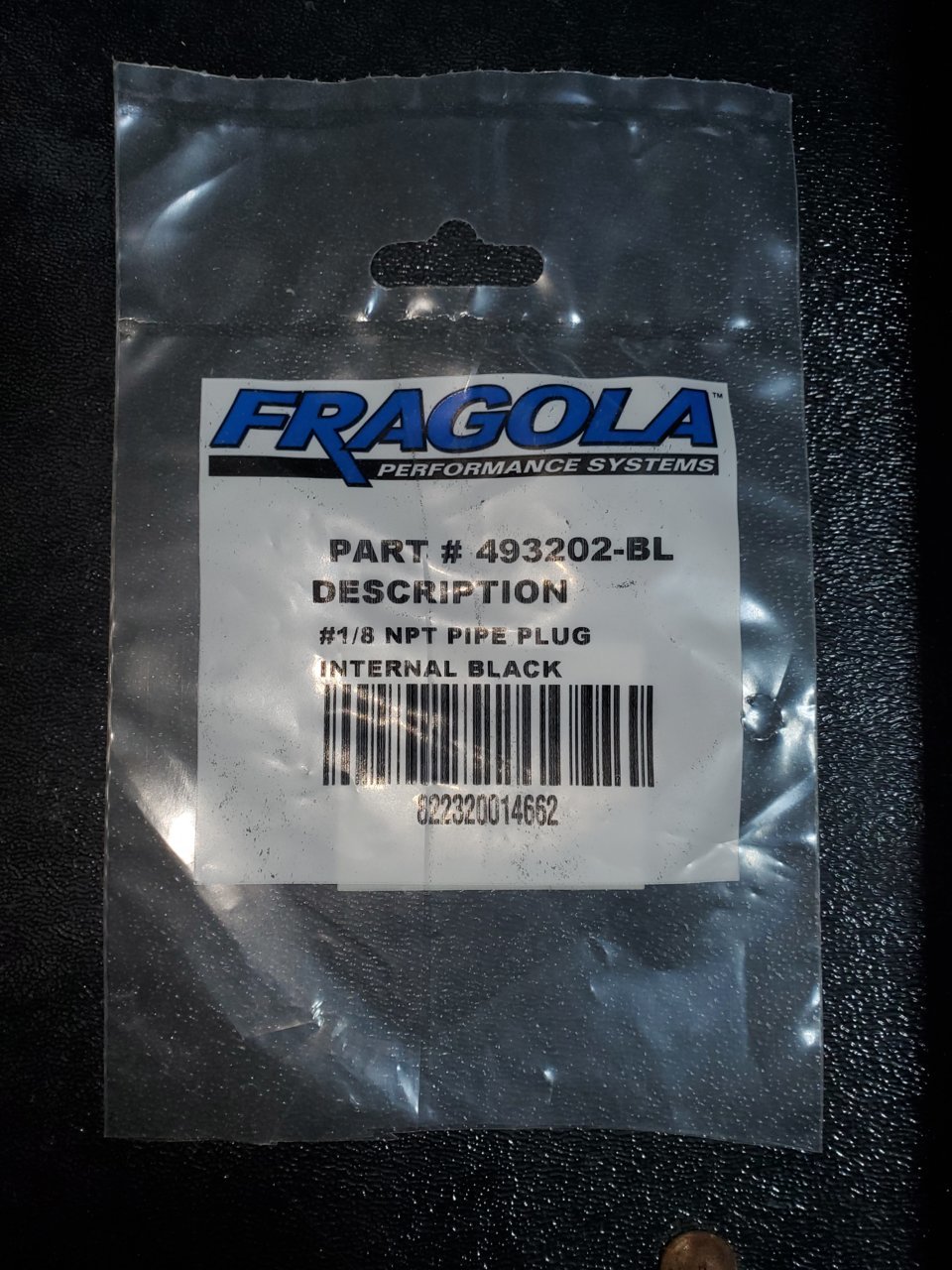

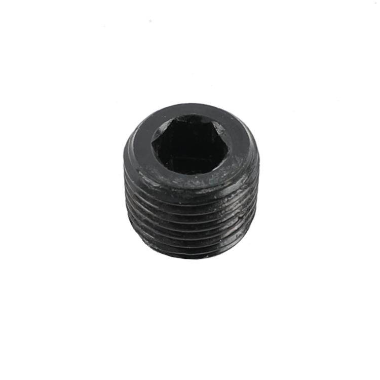

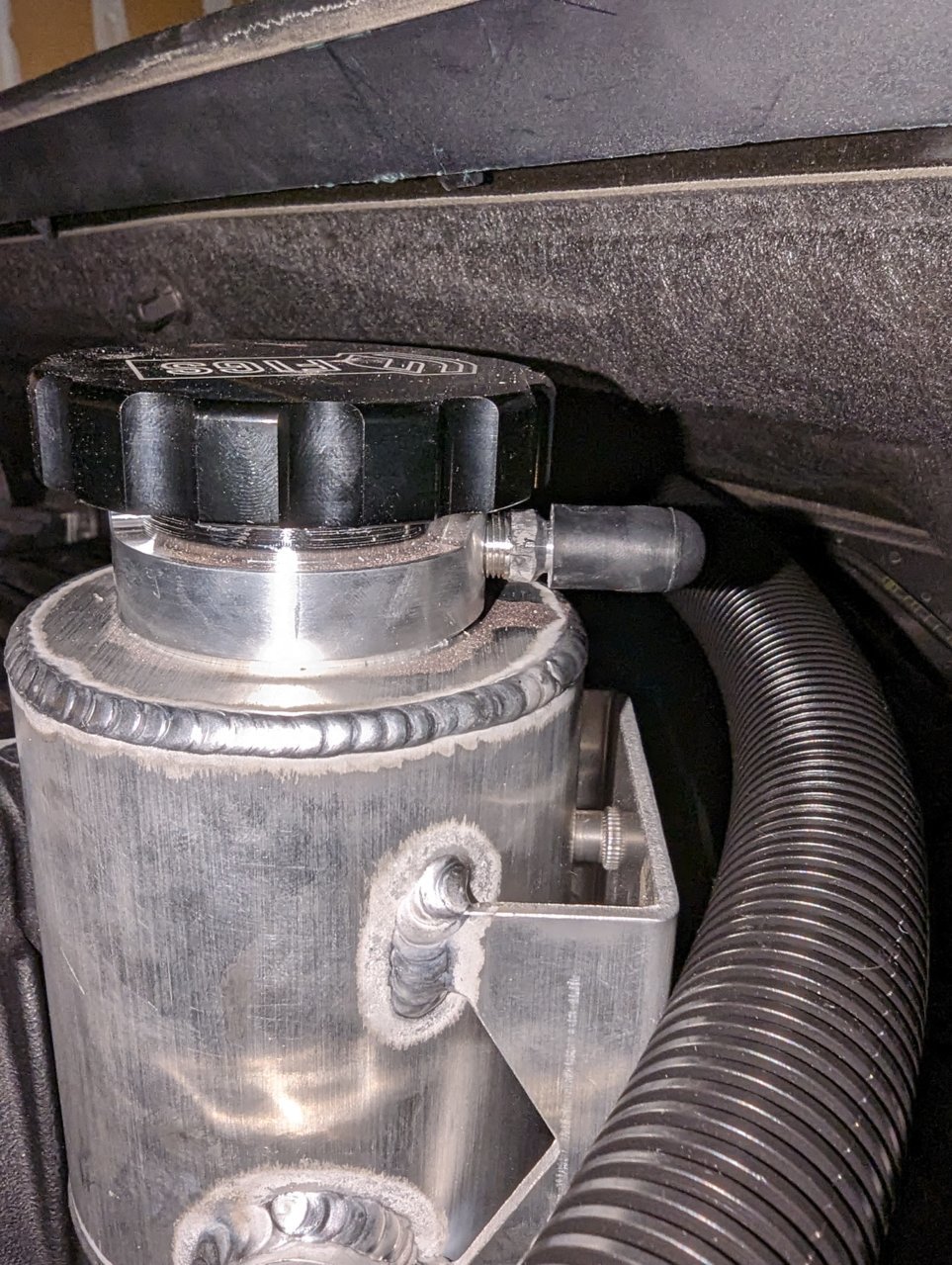

    Figured I'd post the part number in case anyone else wants it. I used Fragola part# 493202-BL to plug the Figs Coolant reservoir overflow on the neck instead of running a hose for a drain. Not sure what others are doing. You can get it for around $3 - $4 at summit or Amazon among other places.

    Awesome. I was just looking at that today and capped it off for now. That's a better solution

    I've seen so many running the Figs tank now that I figured I'd post the part I used. Had mine on for 3 years already.
