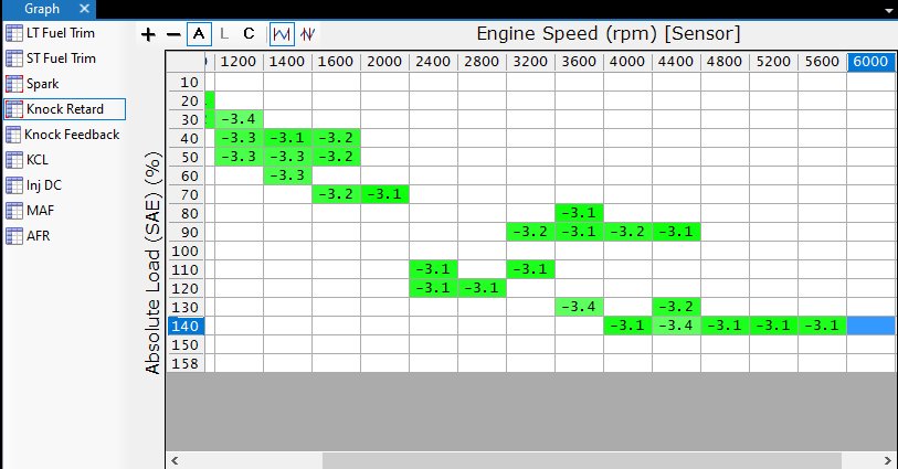

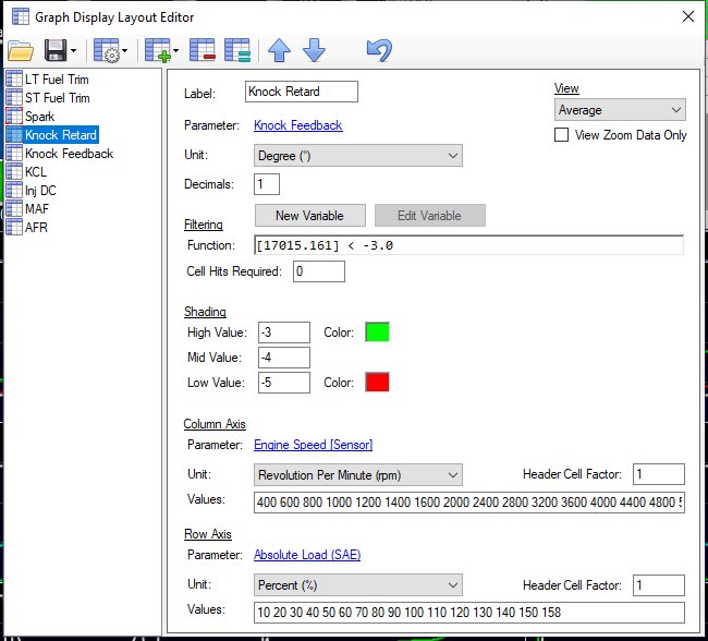

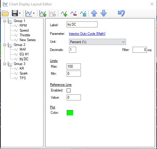

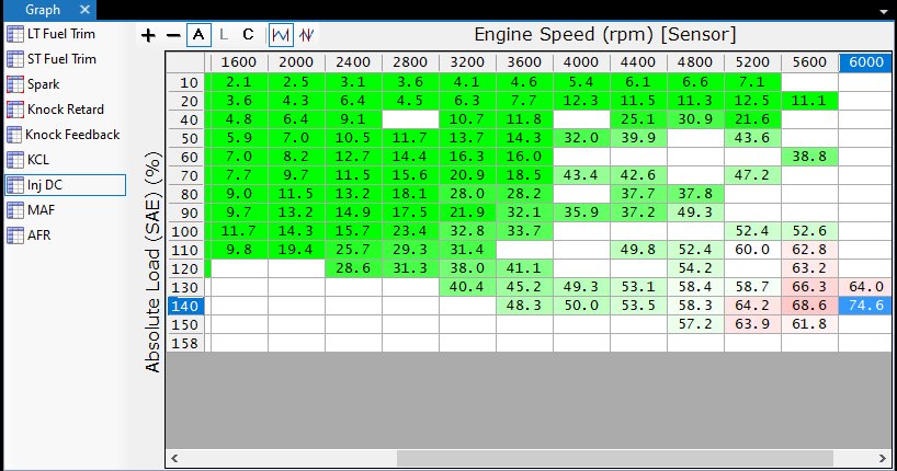

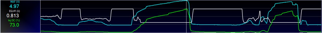

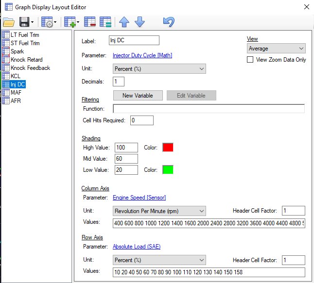

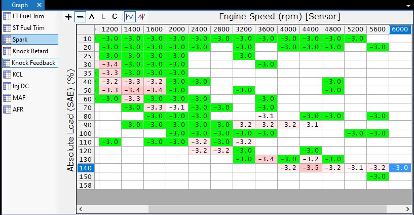

    @Wynnded I thought this would be a better place to answer your questions:
    Injector Duty Cycle and Tables/Graphs:
    Injector Duty Cycle is an internal calculation to HPT and can be found by searching "Injector Duty Cycle" and under the "Maths" section it will be shown.
    Injector duty cycle tells you how much of your injector capability you are using. The injector maxes out at 100%, so if you are seeing 100% injector duty cycle then the engine physically cannot inject more fuel and is most likely starting to lean out. This is good to know when sizing injectors and for tuning on beyond-stock applications.
    To display this, or any item in the graphs, right click on the graph and go to "Charts Layout" and you'll see this appear:
    At the top where it shows the plus sign, click that and then click the parameter you want and other variables and it will be displayed like the following:
    Another useful way to display data is with the "Graphs":
    On the left side (below the different graph names) right click and select "Graphs Layout":
    Again, the green + at the top adds graphs and the red - removes them.
    Select the parameter you want to view, in this case Injector Duty Cycle. With that alone it will show the value at that instant in the log (same as the line graphs above). To view multiple cells, you need to add values to the "Column Axis" and "Row Axis". The most common usage is Engine Speed (ie rpm) for the column axis, and Absolute Load for the row axis. The individual cell column/row values then need to be set, and are denoted by a space----ie for rpm it's 400 600 800 1000, etc. which is the cell values for the columns, and same thing for Absolute Load.
    If you want to color the cells, the "Shading" zone comes into play, where you pick a high and low color and values, and then the "mid value" will be white. If the mid value is in the middle of high and low then it's a linear color change between the two, where as if you select a higher mid value then the greens would be more spread out in this case and the reds would happen over a shorter span.
    There are ways to filter the data that is shown, which I haven't looked into, but for instance the "Knock Retard" graph I have here only shows cells where the cell value is less than -3.0.
    If that filtering function is deleted, then all Knock Retard values are shown. Below shows how that can be useful. The first table only shows knock feedback of <-3.0, meaning it's only displaying cells where Knock Feedback is detected. The second table shows all Knock Feedback, and shows the same cells as the first table as well as all the other cells that are -3.0 (which represents no knock feedback detected). So the first table represents where knock is detected, and the second table shows that also but also shows all the other cells where data was logged.
    Again, not sure on the specifics of the filtering function, since this was my first time messing with the tables. But just configuring the tables and colors can be very helpful. Here is the MAF voltage for example:

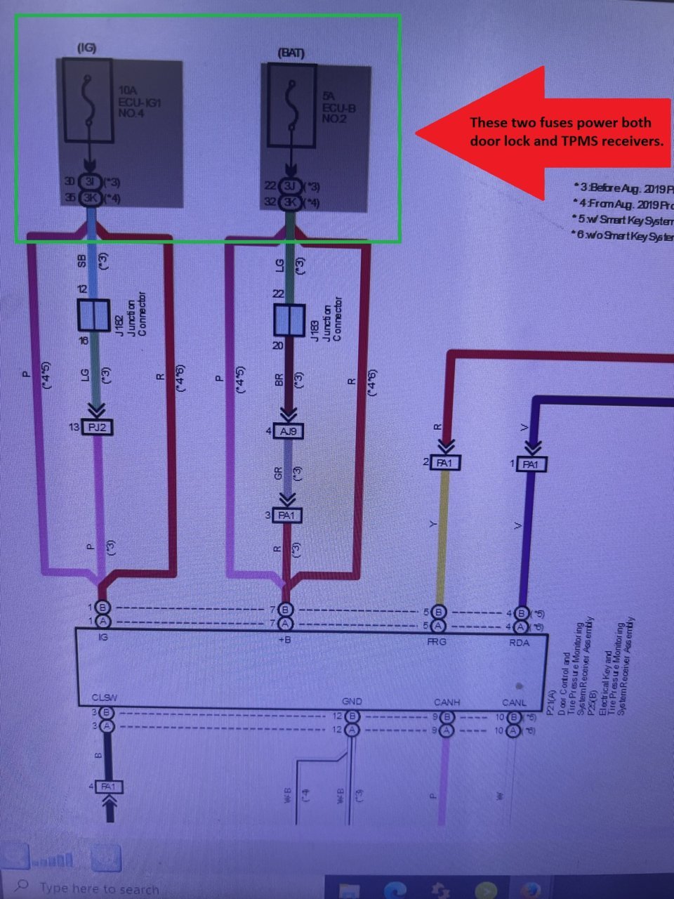

    Out of curiosity, try these two fuses which are in the main fuse box under the hood on the drivers side. They both power the door lock and tpms receivers. The ECU-B no 2 fuse also powers the occupant detection ecu which would also cause an srs light to come on too. They could have possibly popped these fuses. If not i suspect they might have left one of the main body ecu connectors unplugged on the left side of the steering wheel. IMG_0933.jpg
  29. Feb 23, 2023 at 9:00 AM
    #149
    ssmokedz
    ssmokedz Toyota Master Diagnostic Technician
    May 9, 2019
    #30282
    326
    Shelton CT
    2019 Super White Tundra TRD PRO
    I apologize those fuses are in the junction block under the drivers side dash not under the hood
