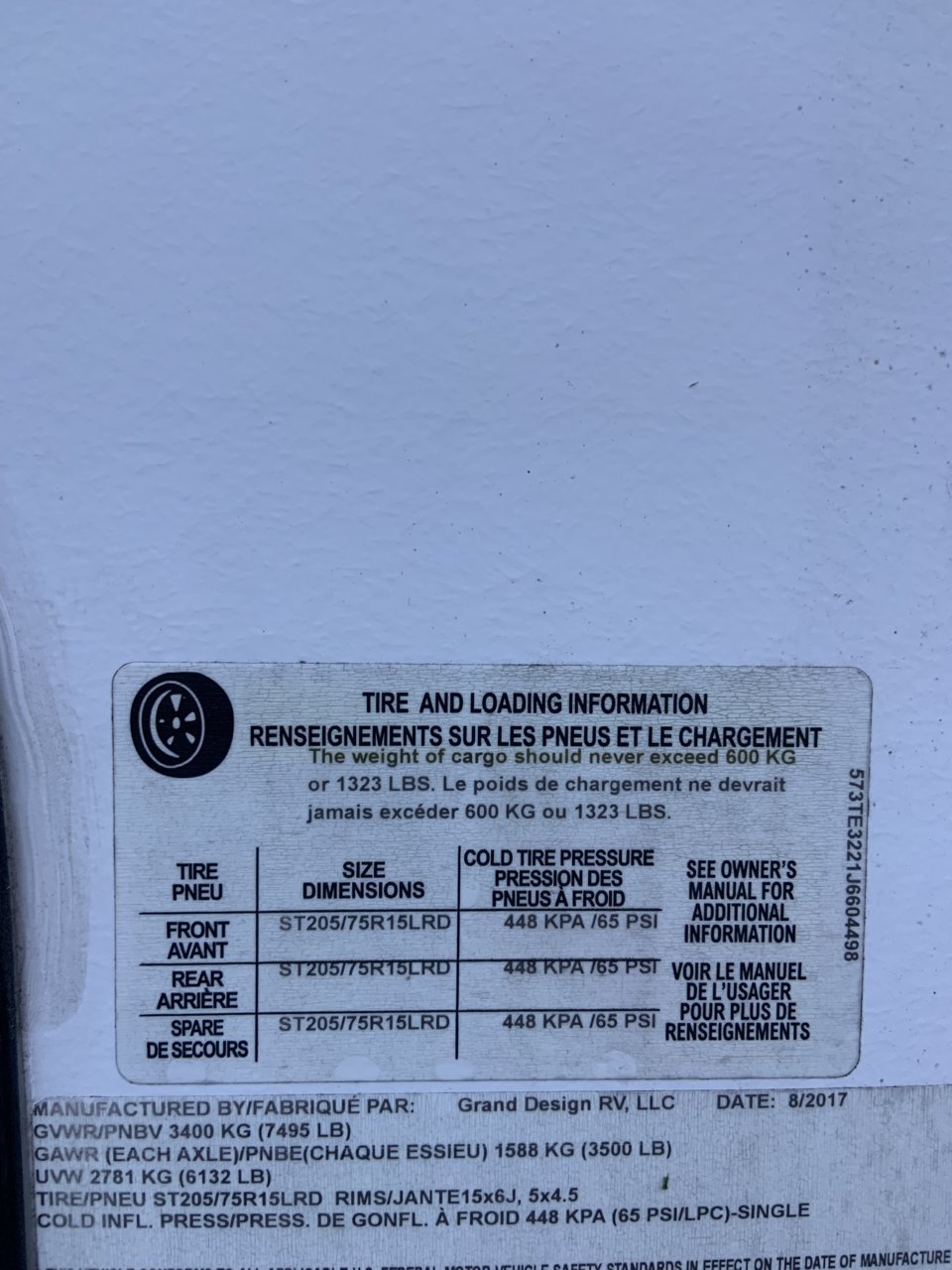

    OP Here - Thank you all for your input so far. We actually do take the current trailer out around 12 times a year, and plan to start leaving this awful heat all summer. So I will be racking up the mileage. 32’ TT sounds doable but maybe too close to the line for ME. I’m now looking more into the 25-27’ length 5500 dry weight options. Seems a bit more appropriate although based on responses perhaps some would suggest it’s still a bit much. Current trailer is 22’, 3800 lbs dry and VERY easy to tow with the 2018. Single axle w/slide out so the hitch is 520 lbs dry. I have to load everything carefully. 1378 lbs available payload. I set up the scale contraption and got 590 lbs hitch weight all loaded up. Even a few hundred more lbs available payload from a 22/23 would be nice.
    Would 3-5’ longer, 1700 lbs heavier with same hitch weight feel significantly different?
    Thanks again!
