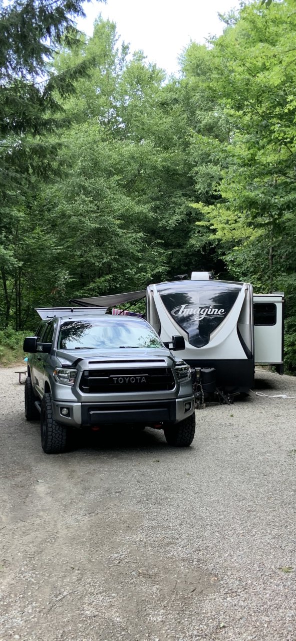

    I tow a 2800bh with my 2017 doublecab with a cap, AAL for the lift in the rear, WDH, and 20psi in the bags for some extra stability. I have no complaints and am very comfortable towing in all conditions and terrain. I just towed it 5 hours up to Lake George, NY from PA. I wouldn’t go longer or much heavier with any half ton though, as I’m sure I’m on the cusp of it getting uncomfortable. I plan to get a 3/4 ton for my next truck mainly for payload concerns, but I plan to keep the tundra as well when the time comes. I mainly don’t like giving up the warm up fuzzy reliability tundra feel for a domestic.

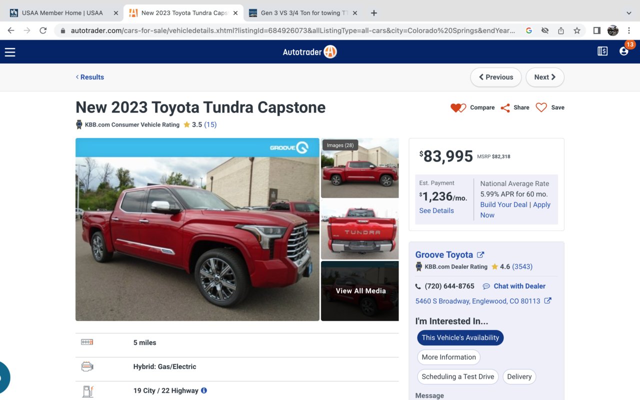

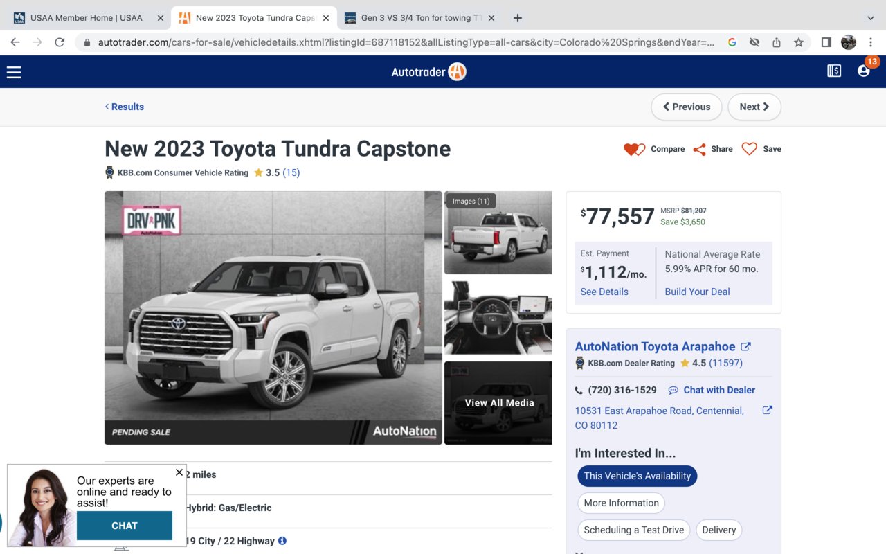

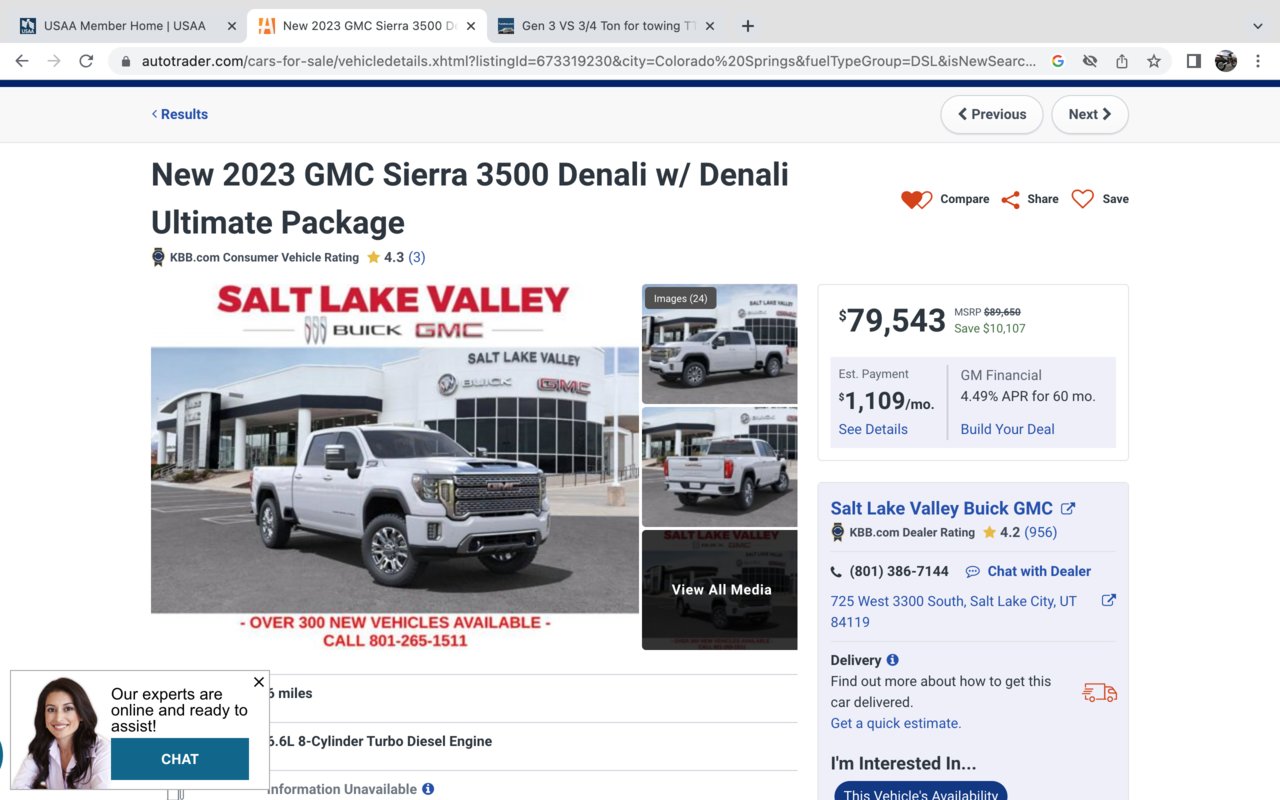

    Ahhh come on man. Top of the line Toyota Tundra Capstone vs top of the line GMC 3500 Denali Ultimate diesel(It doesn't get any nicer than this). Now if you want the gas motor scratch 10000.00 off the GMC price. They pretty much cost the same.
    Now the toad idea isn't a bad one. Do you know if the trailer toad is a braking axle? That would be pretty nice in addition to the service/trailer brakes.
    Screen Shot 2023-07-16 at 4.29.04 PM.png Screen Shot 2023-07-16 at 4.28.34 PM.png Screen Shot 2023-07-16 at 4.26.24 PM.png

    My 2800bh (the exact trailer you’re looking at purchasing) towed very similarly behind my tundra as my previous 25’ 4,500 lb trailer. It’s perfectly capable and well within GCVWR. It’s rated to tow 9,500 lbs with this configuration, which I wouldn’t do especially with a wind sail travel trailer. That said I feel 6500 dry is well within its capabilities, and its a relatively drama free towing experience with the 2800bh. This tundra is easily more capable than the 3/4 tons from 25 years ago that my dad used to pull heavier campers with when I was a kid. They didn’t have j2807 standards back then, but I bet if they did that old 98 k2500 with a 454 wouldn’t have anything on a modern half ton.
