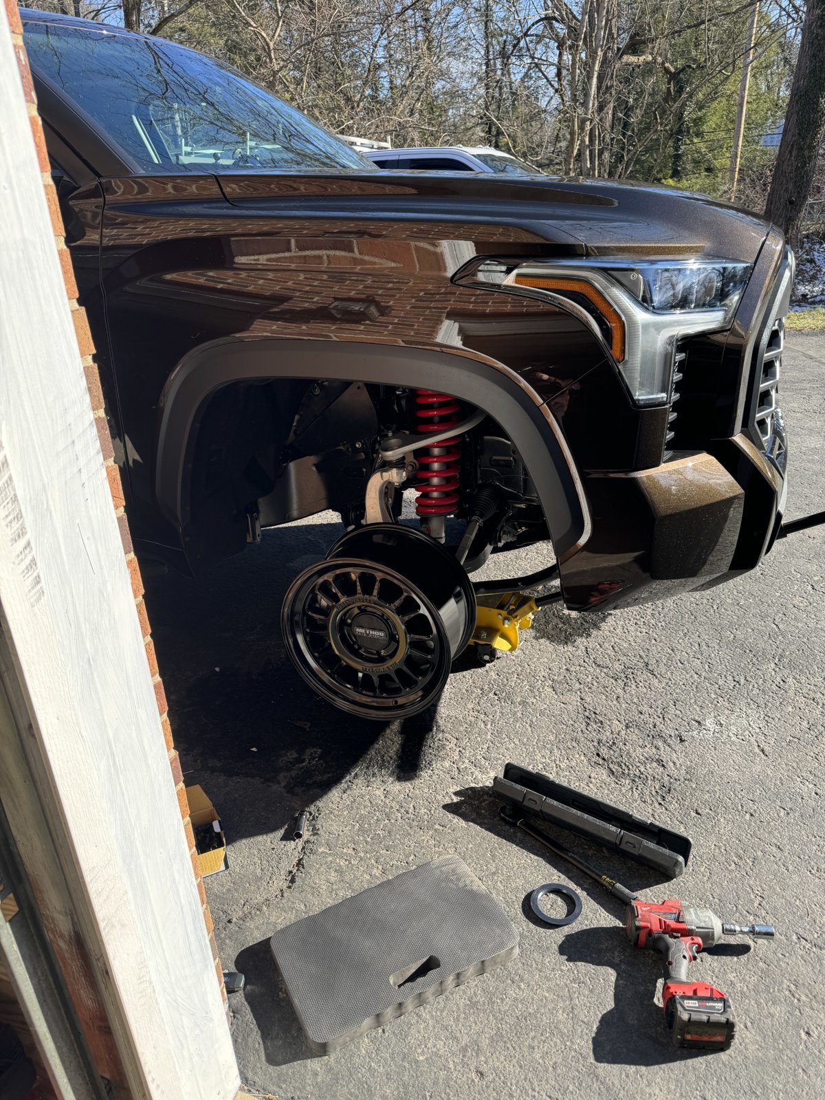

    Testing fitting my wheels today and became a little confused
    The hub on the truck I read is 95.1mm but the new wheels are 106.25mm
    Is this a problem that I’ll need to find hub centric rings for?
    I purchased extended lug nuts as well. Thanks dudes!

    Yes, buy hub rings.

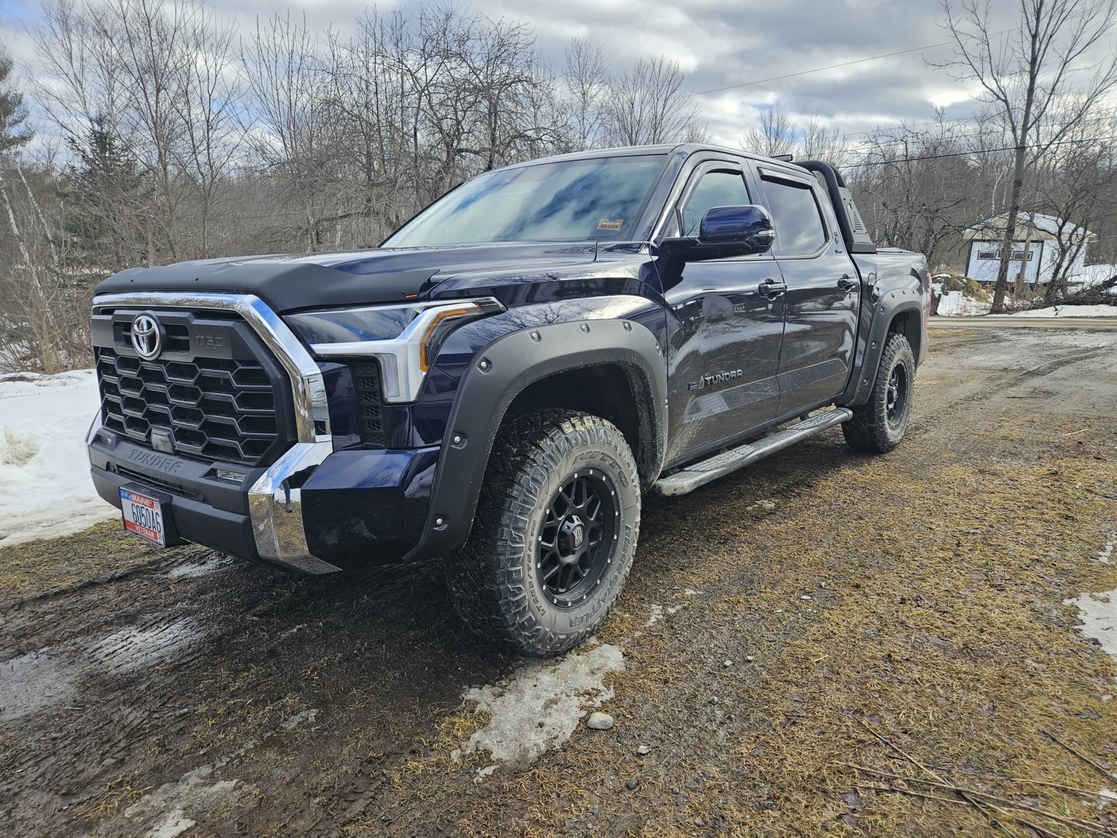

    1.75 in leveling, Loadlifter rear airbag suspension, Access roll-up tonneau cover, EGR fender flares and hood guard, GoRhino sport bar, off-road lights, 185/75R18 Nitto Ridge Grapplers on XD 18x9 +18 offset rims.
    285/85r18
    Nitto Ridge Grapplers on XD rims with +18 offset
    1.75 inch leveling on front and loadlifter airbags in back.

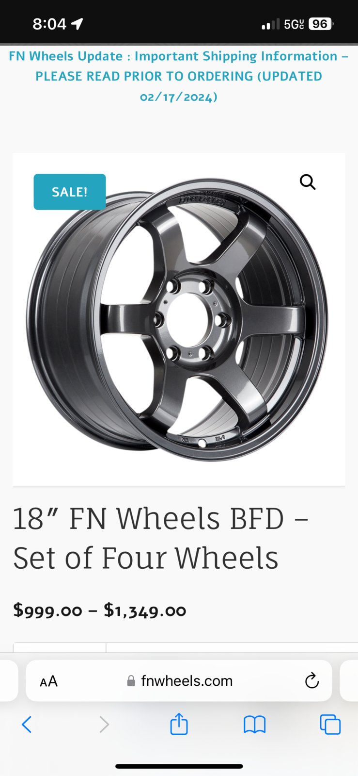

    So I will tow my 5k boat once a week most the year about 20 miles.
    Just got the FN BFD 18’s (+20 offset) coming in around 23lb
    I’m debating on going:
    General Grabber ATX 275/70/18 (~46lb) and these woukd keep me close to the stock combined wherl and tire weight of 70lbs (23+46)
    OR-
    Cooper Discoverer AT3 XLT 275/70/18 (~56lb) which would put me at 10lbs over
    Will I take a considerable mpg hit if I go Cooper route?
    Worth it to go E vs SL?

    Hub rings will fix you up. Very easy fix.

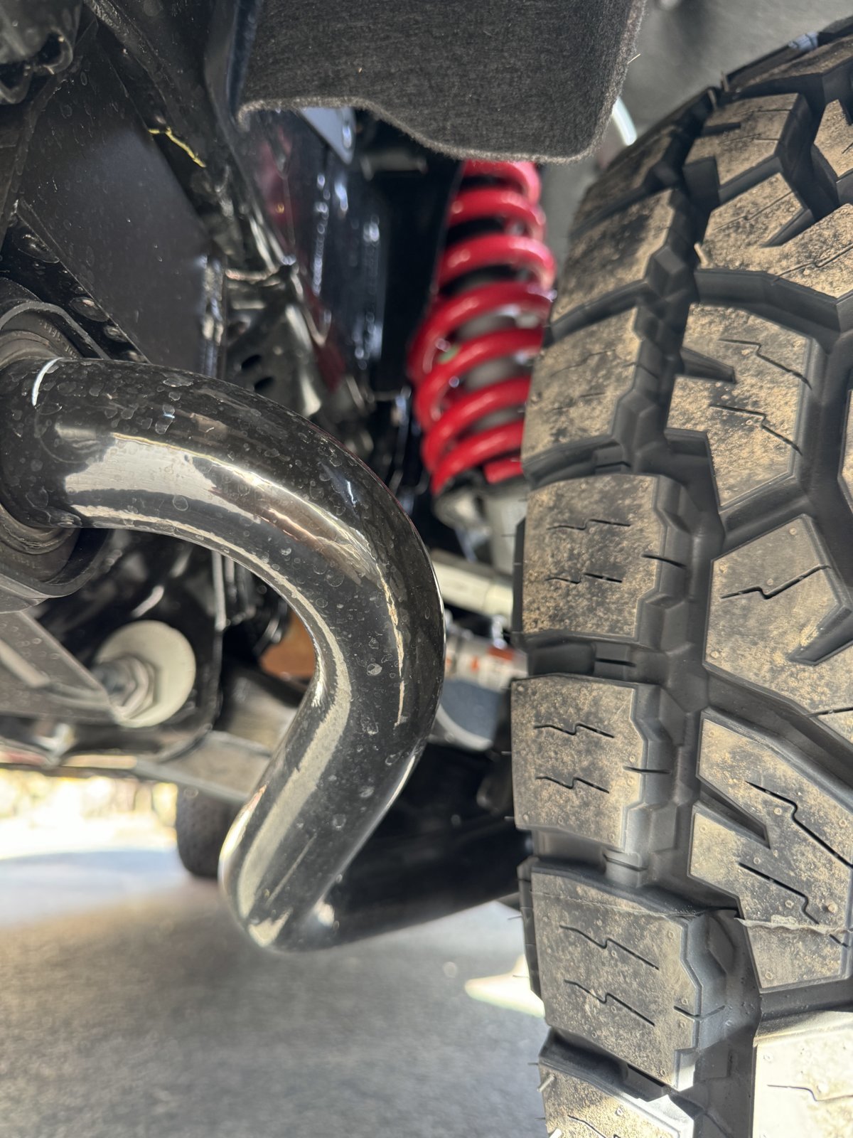

    @T-MAC , just curious, and I am sure others here would be too, could you provide more information on driveability, or is it a special project vehicle for showing etc...
    Just looking at it from what I can see, as good as it looks (looks killer!), I don't see much clearance for any movement of the wheels; up-down or steering rub.

    -Method 318, Gloss Black 17X8.5”, 6X5.5” Lug, +25 Offset Wheels.
    -Toyo Open Country A/T III 35X12.5r17LT
    Load Range C.
    -Method 14X1.5 Black Extended Lug Nuts
    -Amazon Stancemagic 95.1mm to 106.25mm Hub Ring Adaptors
    Truck has the factory installed 3” TRD lift. No rubbing at all to report of not even on the sway bar with the drop bracket still installed.

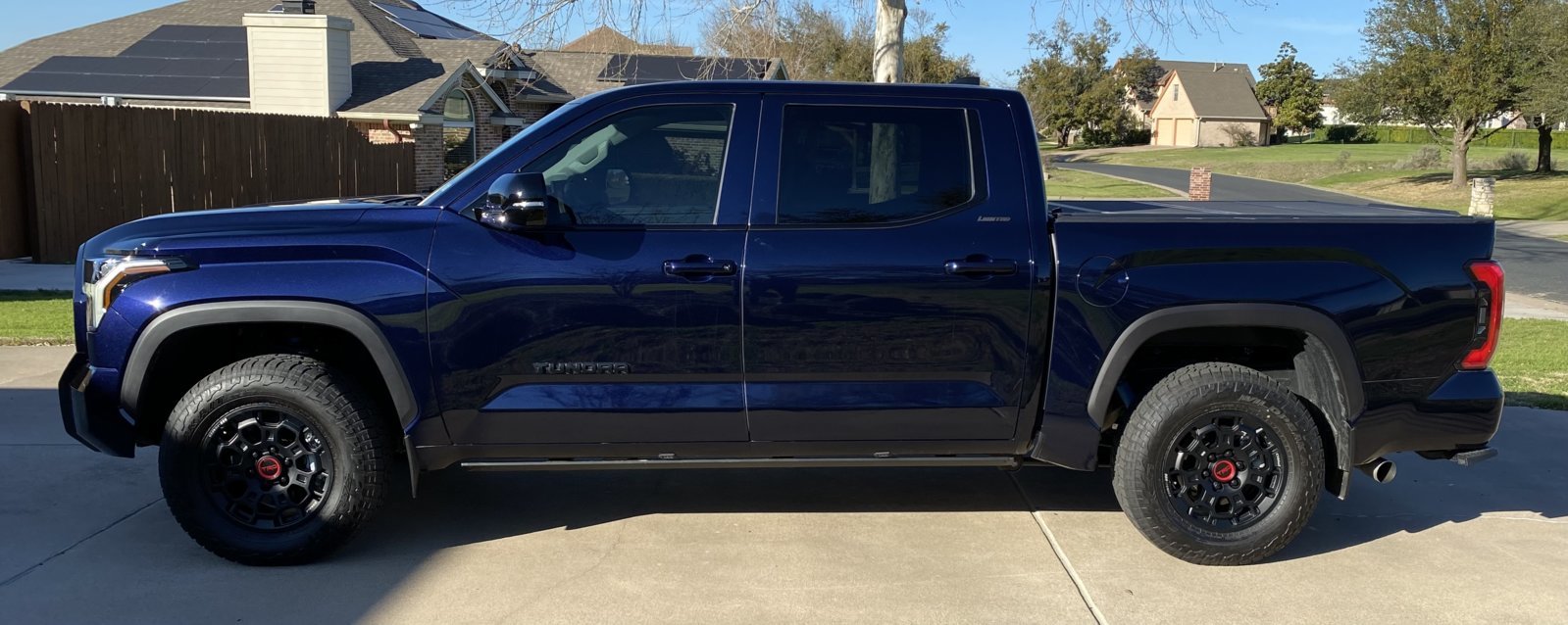

    2024 Honda Ridgeline Black Edition
    TRD PRO BBS 18" wheels with Falken Wildpeak A/T AT3W 285/65R18 and TRD OR Struts/Shocks
